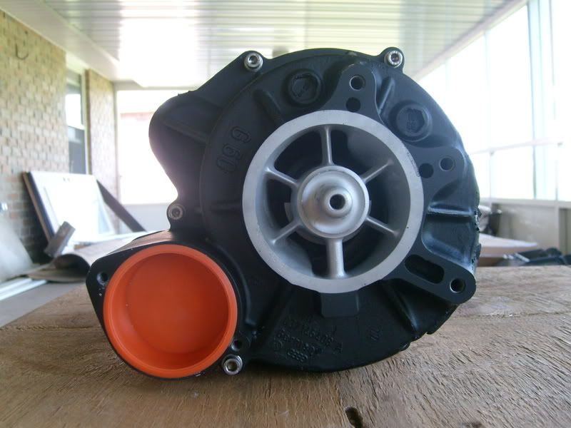

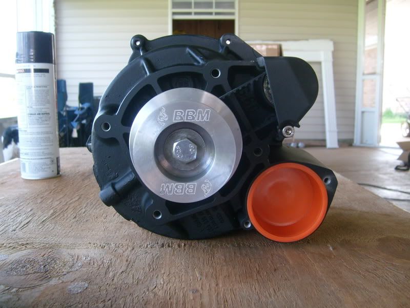

Cheapmods 0 Posted March 5, 2009 here's your close ups Quote Share this post Link to post Share on other sites

Toad 0 Posted March 5, 2009 The porting looks rather nice on that charger. :) Quote Share this post Link to post Share on other sites
Sonicriot13 0 Posted March 5, 2009 Yeah, that charger looks the t*ts. :D Quote Share this post Link to post Share on other sites

Cheapmods 0 Posted March 5, 2009 nothing but praise for BBM :notworthy: very helpful folks too. When i started my project i gave 'em a run down of my plans & they affirmed that i was on the right track. I agree with the cost per hp increase you hit at a certain point, yan. Although i haven't even put this thing together, i pretty much got all the applicable parts for my stage of build. I tore it down bare & i'm rebuilding it like new & i'd hate to realize that there was something simple i could have done after the fact, ya know. i'll check into the weight matching price, but i'm thinking the crank will be too expensive at this point. Thanks for the help. Oh & :salute: on the kind words about the charger, she's a true beauty!! Quote Share this post Link to post Share on other sites
