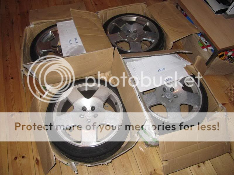

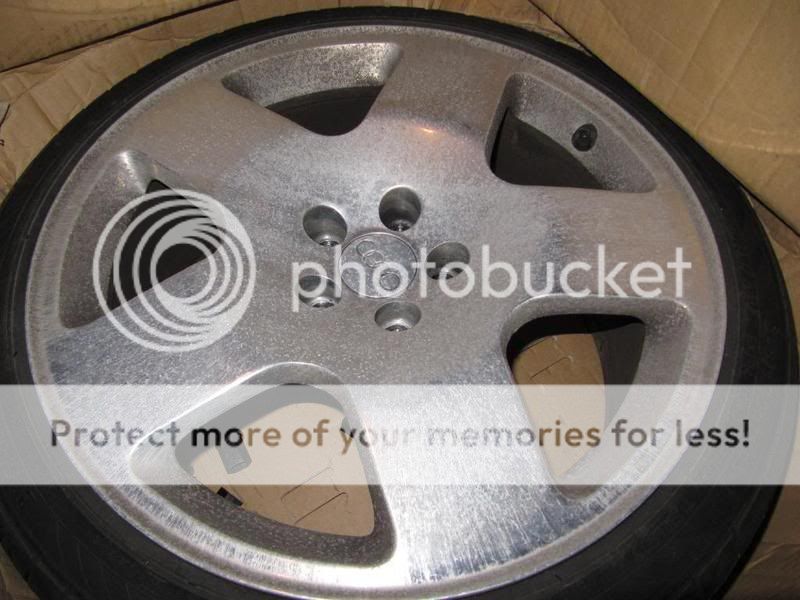

8vMatt 1 Posted December 12, 2009 Well finally got my ass into gear and finished off the polishing of the new wheels Overall time taken to do them wasn't too bad. I just had a long break in the middle of doing them A couple were pretty corroded, so I decided to wet n dry them all back so they all start from the same position. First 800 grit then 1200 with hot soapy water. To get rid of any final scratches on them I used G3 compound on a sponge head fixed into my cordless drill. After the G3, I used Autosol polisher and finally had Autoglym Metal Polishing over that. Once finished I put 3 coats of Colinite Hard Wax on to protect them from the winter weather. Not got any final finished pics yet as I put them on the car after it got dark. So I can get a few tomorrow. Now these have imperfections on them as they are not professional standard. I wanted to have a go at doing this myself as I've never tried before. I feel a sense of satisfaction from making them shine up from the starting position. So I'm very pleased with them, I'm sure people can pick fault at them but to me thats not the point of the exercise. A few pics of things so far- How I picked them up Part way through being cleaned An after I've given it a bit of elbow shot I'll put some more pics up with them on the car tomorrow, IMO they really do suit the car down to the ground. Very simple lines that compliment the lines of the Corrado perfectly. :luvlove: Quote Share this post Link to post Share on other sites

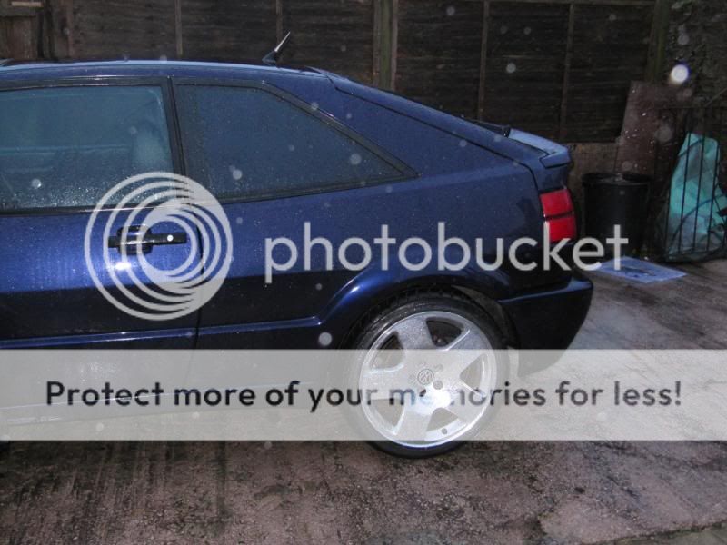

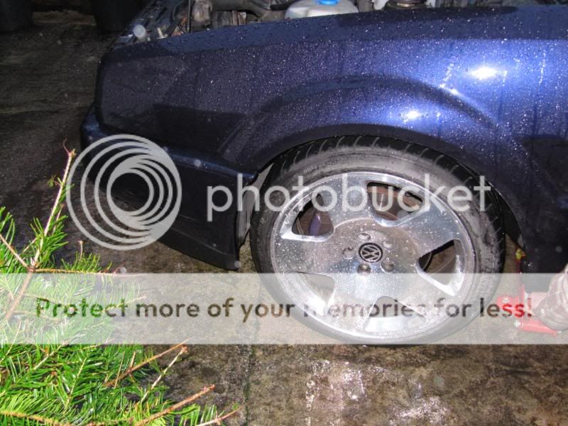

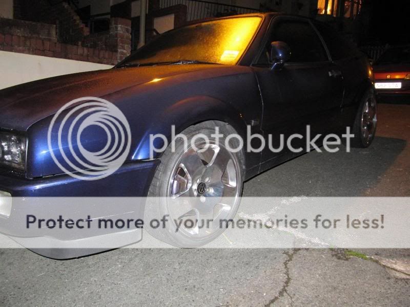

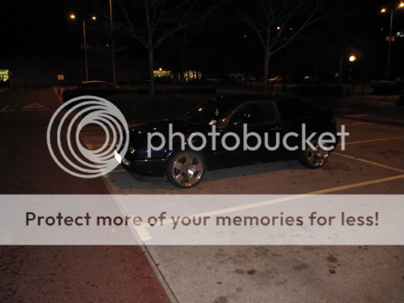

8vMatt 1 Posted December 13, 2009 I didn't get a chance to take any pics in the daylight So of course I've got some really rubbish pics in the dark instead that you can't see sh1t :gag: Anyway, here goes (sorry :cuckoo: )- Quote Share this post Link to post Share on other sites
