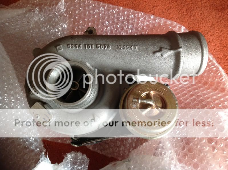

K04 to replace the original k03

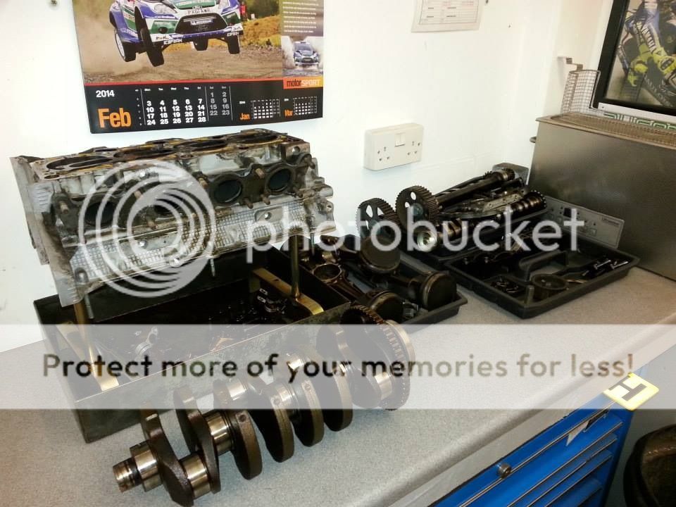

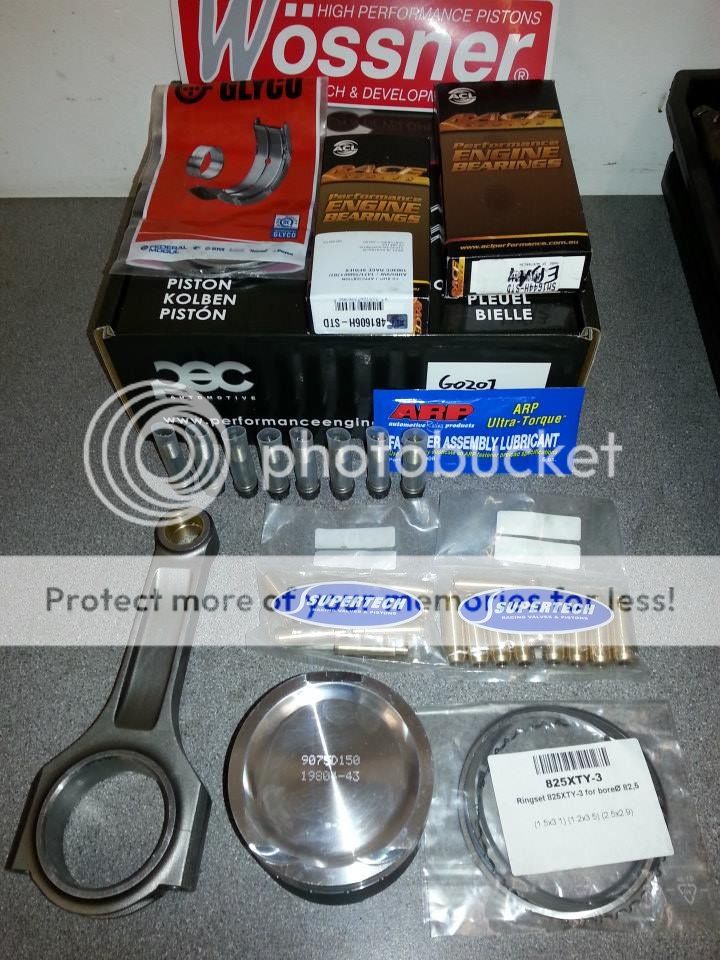

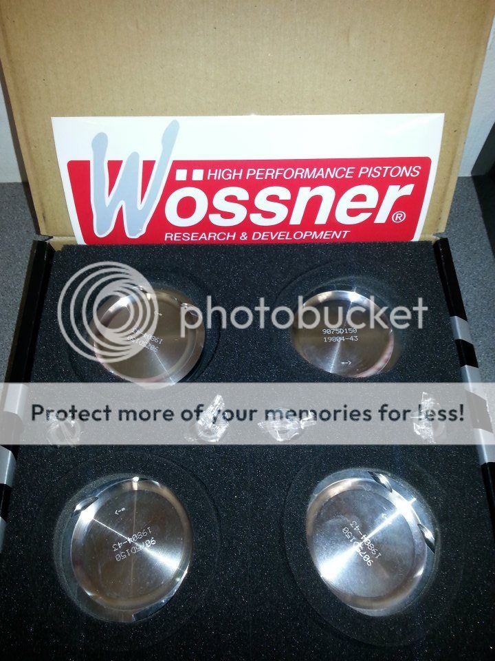

the block has been bored out to take the capacity to a 1.9l with these pistons
stripped out on the bench

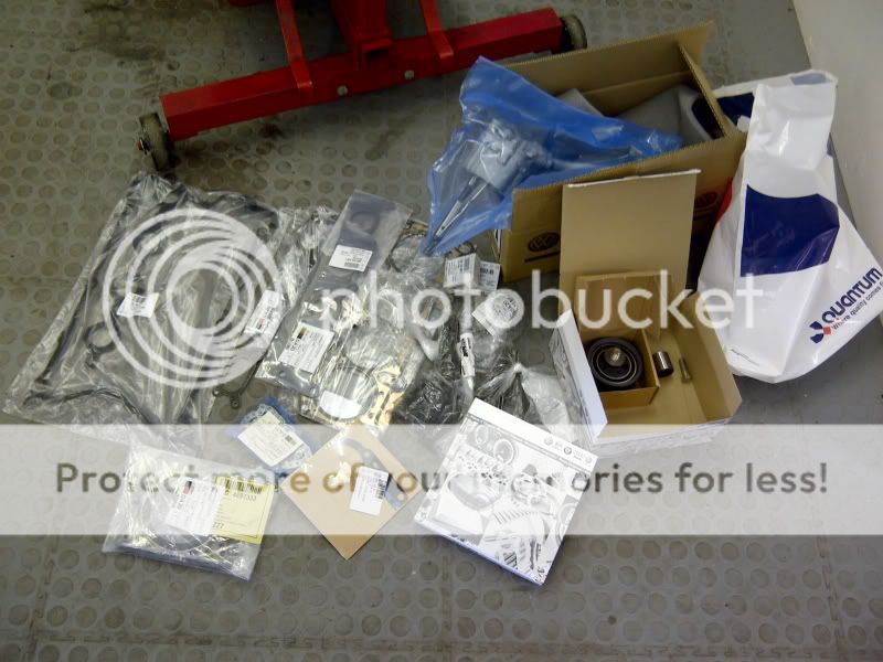

all new genuine VW seals and gaskets including a new oil pump, just in case

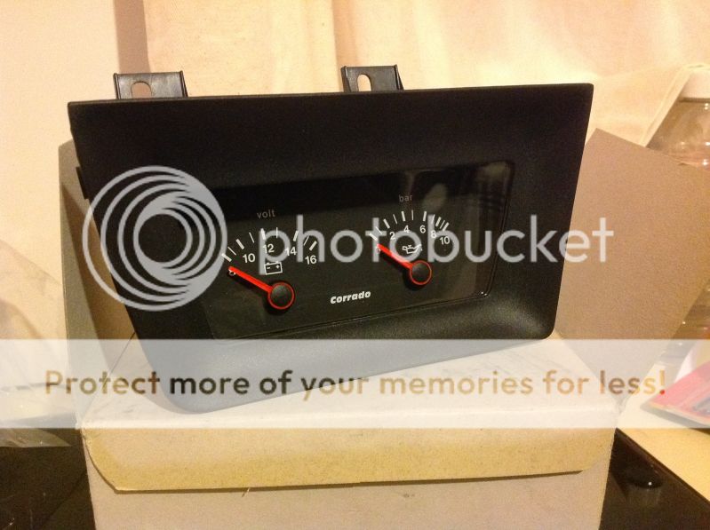

I also have a few other parts being collected including my corrado vdo gauges from Pat McCrotch, not sure what's happened to him but haven't seen him on here for a while
the plan is to have the dash and pillar trims flocked in black so these will suit

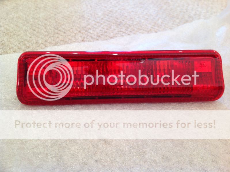

and a US spec high level brake light

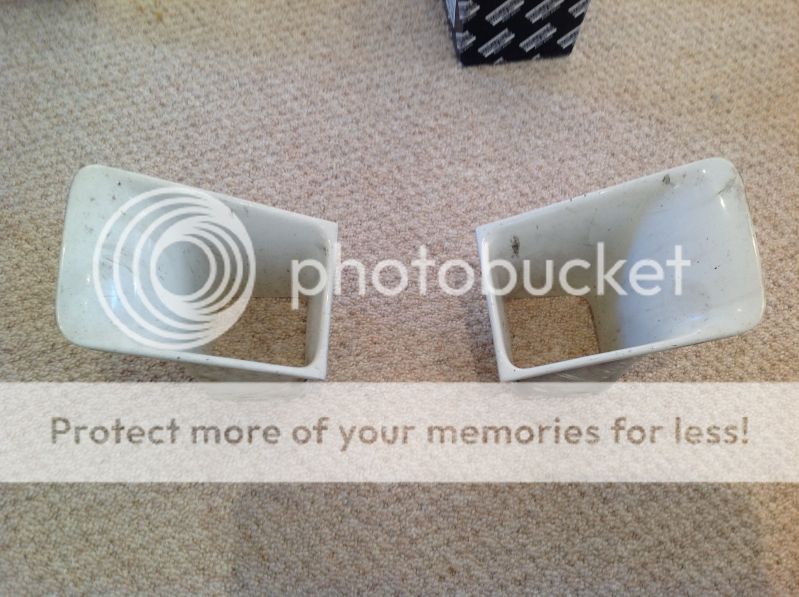

and for a bit more air flow I have these BMW 3 series vents which will take the place of the fog lights

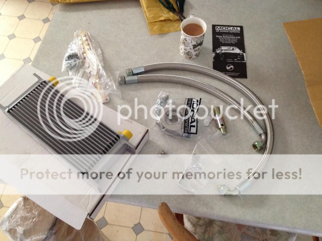

A mocal cooler with sandwich plate and some of Daves stainless radiator brackets

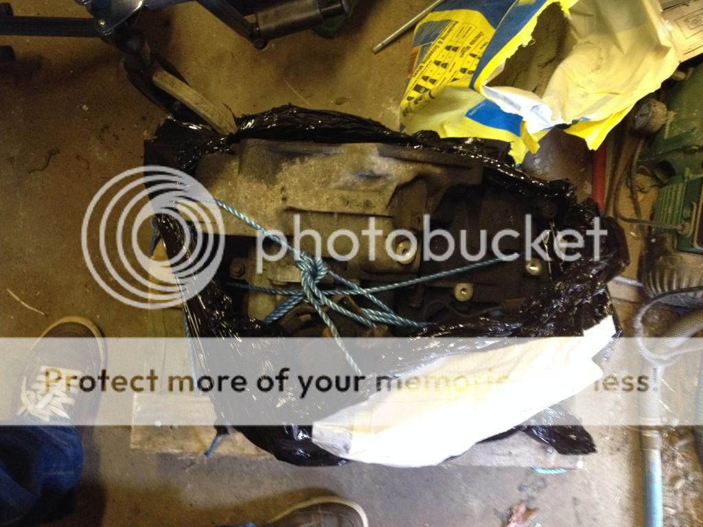

A CTN code 02a gearbox fresh on a pallet, will have to see the difference that this makes

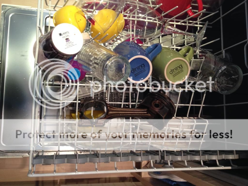

And one of my old 1.8t pistons complete with dings in the top where the valves have met it. Having a quick wash in the dishwasher

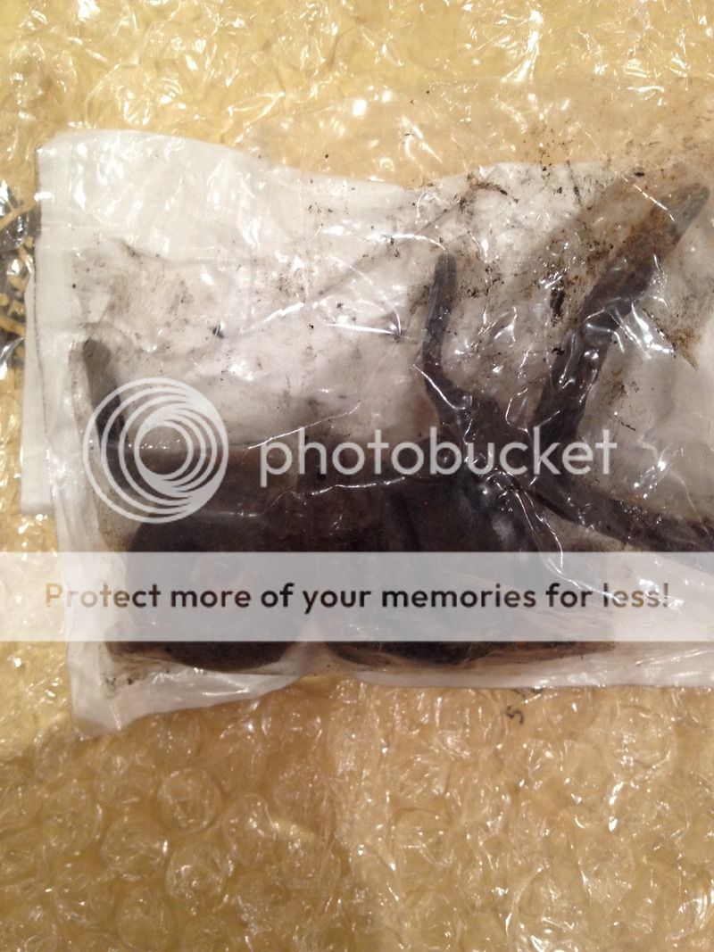

Skanky new radiator bracket parts because mine snapped and sheared on removal

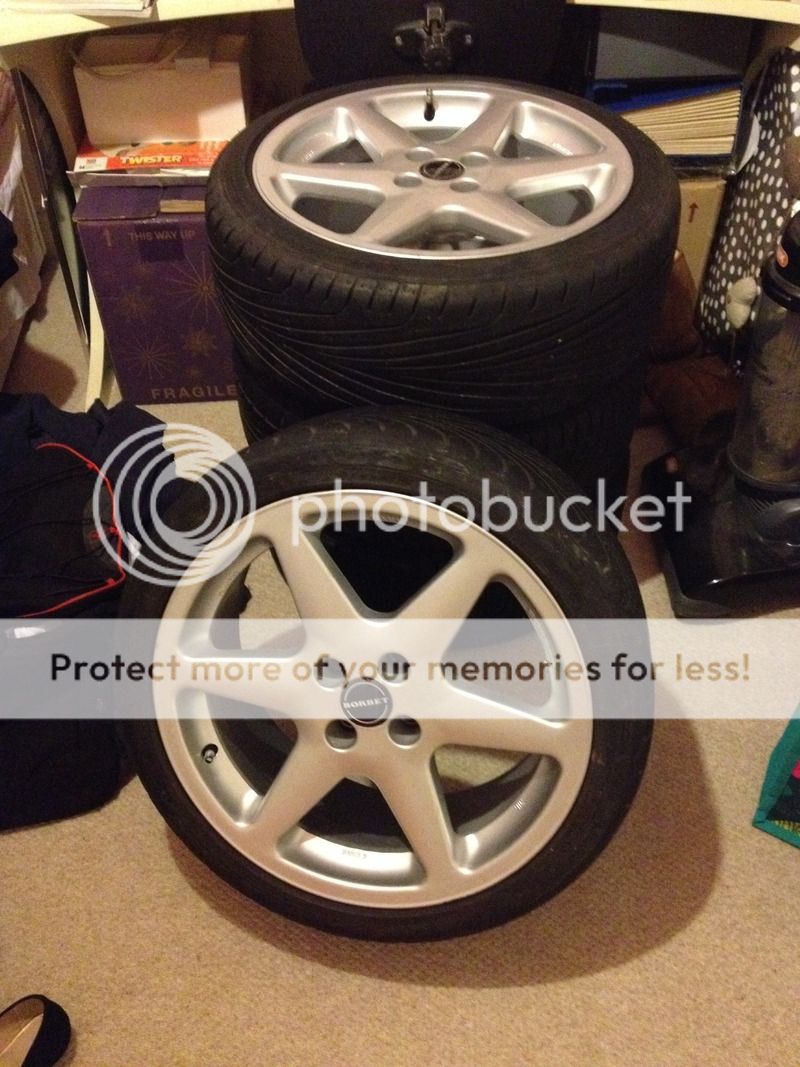

Some Borbet C in 17x7.5" flavour that were mega cheap from a chap who had them on an E30 BMW but could not sell them on BMW forums. Perfect

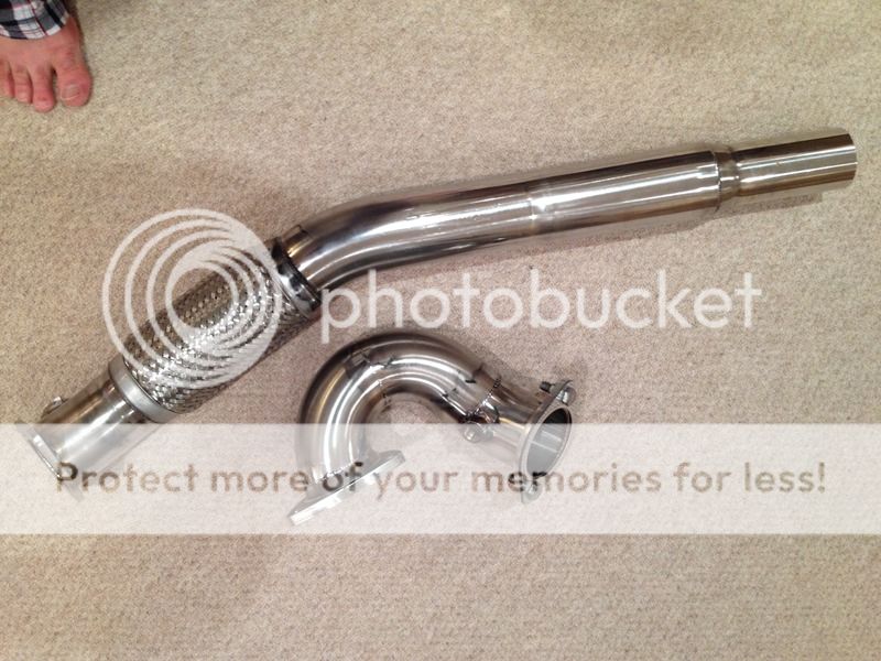

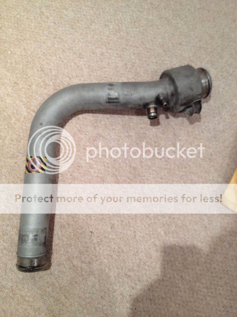

Purchased from Trackslag, 3 inch to 2.5 inch turbo downpipe

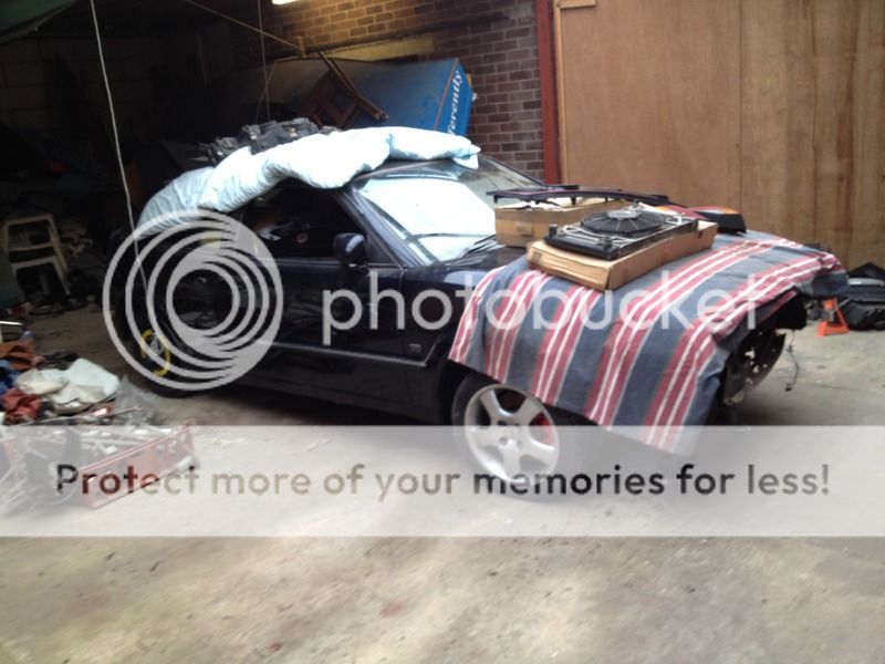

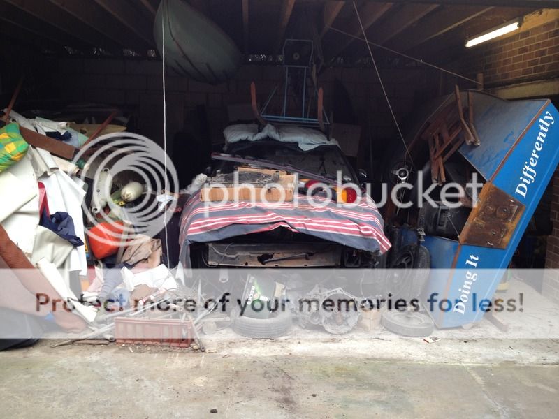

A couple of evenings back I opened the doors to this:
And after a bit of digging, dropped the car back on the ground and rolled outside for the first time in about 4 years

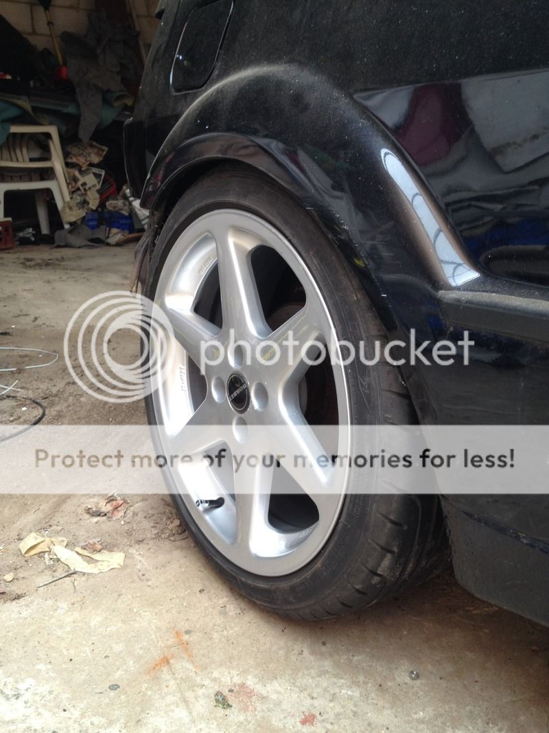

Today I've got the Borbets fitted
Fitment is pretty good although I think I may wind up the coillies a few mm E8AE137E-87A0-449F-B61E-E4BE311367C7.jpg

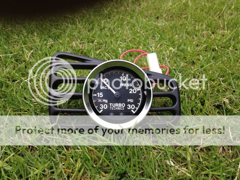

and found my Turbo Technics boost gauge and SWG vent

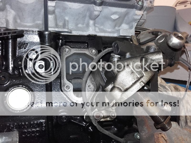

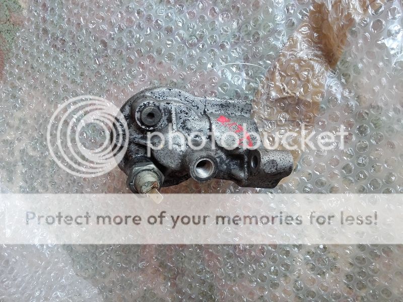

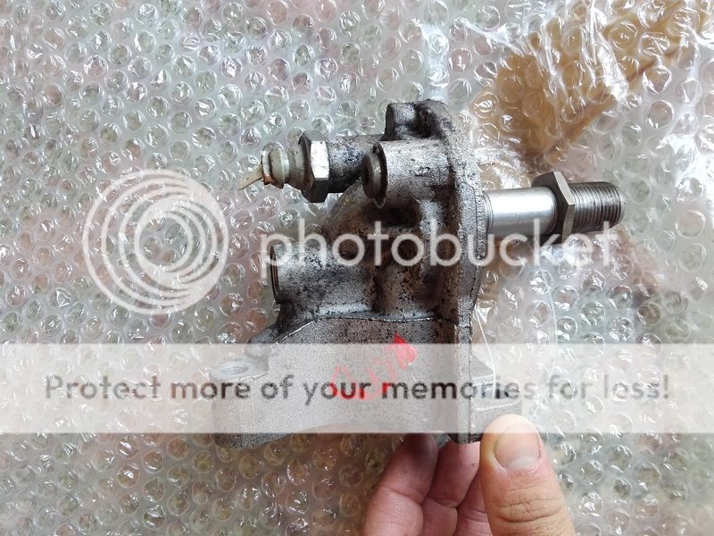

One of the hardest parts to get hold of was the oil filter housing from a 1.9 tdi to change this:
To this:
This gives me the angle I need and provides an oil feed for the turbo

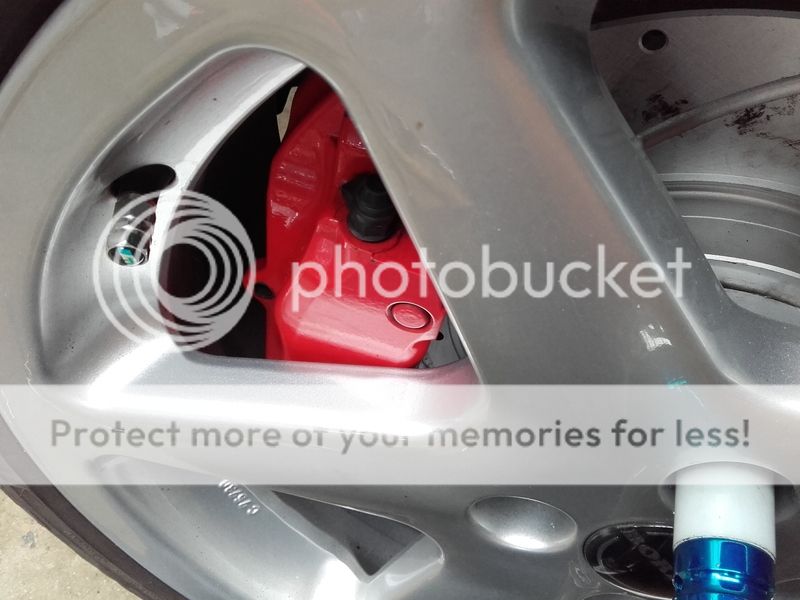

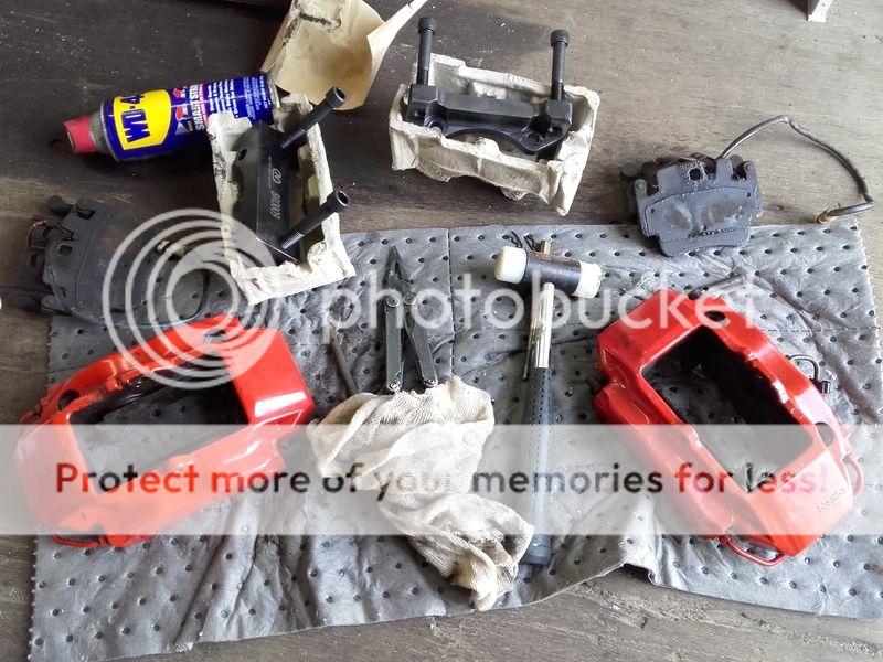

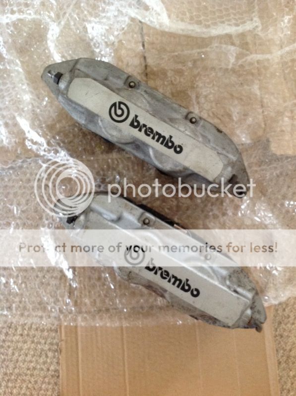

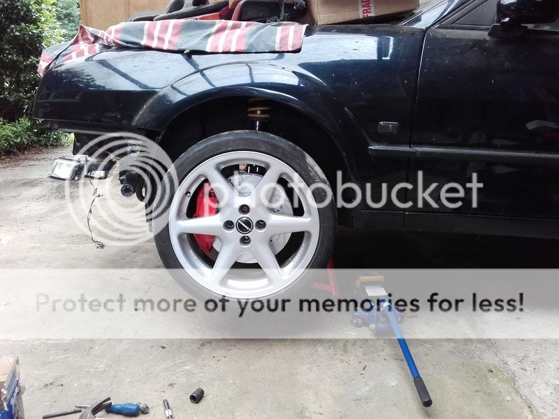

I dragged the car out for the first time in a while today. Have got the brakes fitted up
They look fripping awesome and should stop it ok
Had to take them back off after the trial fit because the wheels are touching the caliper!
Bit of a bummer as I was hoping not to have to use spacers

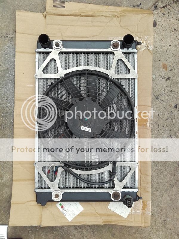

Also swapped over my slimline fan and bracket setup from the old rad to the new one
Those brakes will make a huge difference, I had to use 3mm spacers on my wheels just to gain minimum clearance.
Will you be upgrading the rears ?
I'm keen to get the car back on the road so will probably leave the rears for now and see how it performs once it's all up and running. I have got to drop the whole rear beam off and change the bushes and brake lines. Are you running the exact same brakes? At a glance, I was looking to fit a 5mm spacer
Yes I'm running Porsche Boxster S 986/996 front calipers, I originally used 3mm spacers but it did look a tad close at 1mm clearance on my old school OZ Polaris wheels, I ran them like that for a few days but later changed to 5mm.
