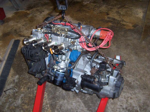

strimmer 0 Posted October 11, 2009 I've no experience of carbs............ yet!!! I will transplant this during the winter months, as is the way perhpas I'll learn something useful along the way, I'm happy to pass on my findings. I have no clue about set up as all the work was done by the guy I bought the engine from, fingers crossed the engine will drop straight in. Quote Share this post Link to post Share on other sites
tyler 0 Posted October 11, 2009 looks mint bud :D bought some 40s now so will be doing it late next week :D Quote Share this post Link to post Share on other sites
