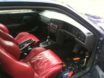

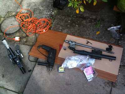

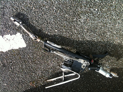

This weekend I went about fitting the much talked about Fixed Column mod to my VR, I sourced a Polo column from eBay for £20 and bought the rest new from VW. Big shout to Tekara for sorting me out a late cowling too, maybe the last one available??
The Polo column as I received it:
Like to see someone try and steal this:
Bit of a mid-session action shot.
Irwins made light work of the shear bolts:
Anyway, all I I think it cost me about £120 to do this, and I have to say it was worth every penny. Steering feedback is so so good. Seems to have quietened down vibrations in the cabin too as an added bonus. Bang for buck this is a great mod, and my column wasn't even THAT bad in the first place.

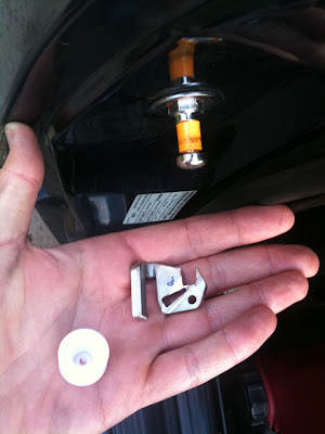

Last night I attacked the doors with these:
New door pins (mmm orange :gag: )
New window rollers
Daves Door Handle repair kits.
The new rollers went on in about 10 seconds flat, and the door handle repair kit was fiddly but not too taxing.
Driver side door pin took 30 seconds, whereas the nut on the passenger side just rounded straight off. This was particularly annoying as it was the passenger side that actually needed doing in the first place. I ended up taking an angle grinder to the head of the pin and then using my trusty irwins to get the nut out!

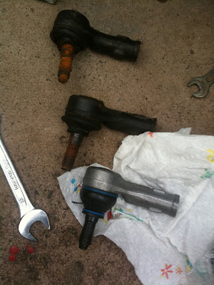

Mmmm new Track Rod End and Wheel bearing on the passenger side completes the refurb of every component on the passenger side of the car! Had a good wiggle of the inner track rod but there was no movement at all, which is a relief.
Tackling the drivers Wheel bearing and Track rod tomorrow. Hopefully get to the bottom on the 'clunking' I get in 1st and 2nd gear. Fingers crossed it's not the inner track rod on that side.
