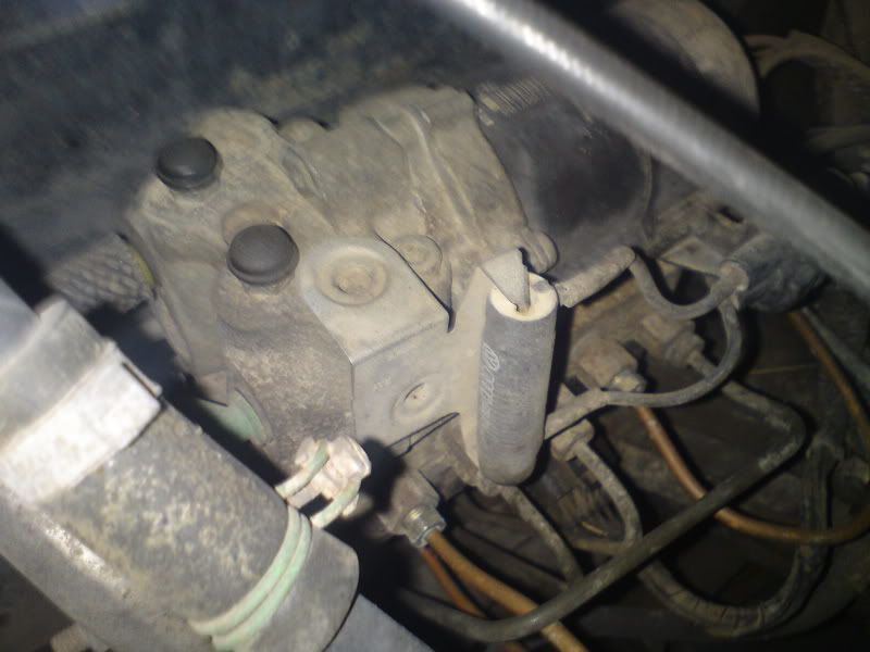

I'm new to the VR so will have many q's but for now can anyone tell me what this is and where should it be attached? Circled in Red.
It has an electrical connector which I've found has a plastic clip that attaches to the ABS pump (I think) but there is also a steel L shaped bracket hanging not secured.
Sorry for the pic quality, only had my phone whilst I was working.
Thanks
It's a ballast resistor for something, it clips onto the ABS pump with a little bit of fiddling.
I clipped the connector to the ABS pump but the bracket is a mystery.

The l shaped brcket clips onto the top of the abs pump and holds the resistor in place
Thanks Jon, I'll have another look.

The resistor is part of the EDL electrical circuit for driving the ABS pump motor.
Not fitted means an ABS only brake system.
