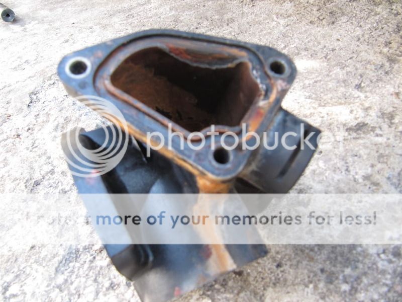

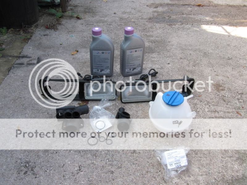

8vMatt 1 Posted April 1, 2010 I'm going to change the thermostat on my VR soon, will I need anything else other than thermostat, o-ring and G12+ ? Should I replace the housing :shrug: Thanks Dave Be on the safe side and change it. When I did mine, the inside edge of the housing had crumbled away to allow the rubber to squeeze inside and cause a slight water leak which would've taken ages to find as it was so small. Gen parts all the way guys. Ignore the fogs, I bought this lot when I came to work on the coolant system. Found it to be a good time to fit the mk4 Golf header tank. Quote Share this post Link to post Share on other sites
MikLSP 0 Posted April 1, 2010 If it's the original thermostat housing then it will be worth getting one. Here is mine that I took off today, similarly to Matt's the inner edge had completely disintegrated but to a greater extent as only the corners remained. As a result the seal had deformed badly and was leaking. You can also see there's a pretty major crack working it's way across the whole body! climatronic wiring-Golf from May 01.pdfN194 DTP Thermostat Housing 1.JPG[/attachment:1u9q1u2x]2.8l 24v Climatronic system.pdfN194 DTP Thermostat Housing 2.JPG[/attachment:1u9q1u2x]N194 DTP Thermostat Housing 3.JPG[/attachment:1u9q1u2x] Quote Share this post Link to post Share on other sites
