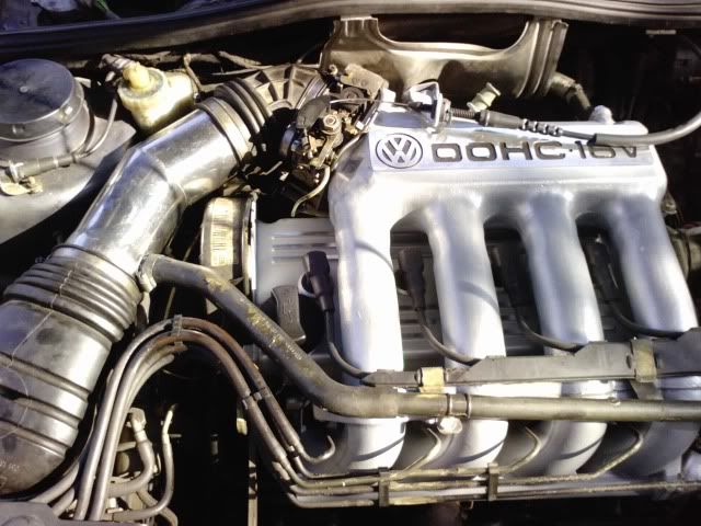

vw domo 0 Posted April 26, 2010 mines a 9a and it only has one pipe on that section Picture 147.jpg[/attachment:39g2i1mo] the second and third power rohr pipes looks like they would work, not sure if the first one will fit. Quote Share this post Link to post Share on other sites
krnau 0 Posted April 26, 2010 mines a 9a and it only has one pipe on that section Picture 147.jpg[/attachment:3uv6rryn] the second and third power rohr pipes looks like they would work, not sure if the first one will fit. where is the over run cut off valve ?? :| :| :| Quote Share this post Link to post Share on other sites
Swompy 0 Posted April 26, 2010 mines a 9a and it only has one pipe on that section Picture 147.jpg[/attachment:3jkifdot] the second and third power rohr pipes looks like they would work, not sure if the first one will fit. Thats just how mine looks as well Quote Share this post Link to post Share on other sites

pumbaa 0 Posted April 27, 2010 None of them are for the 9a. I bought the second one from ebay which is the same as the blue one, only silver, and it doesnt fit because both ends are circular whereas the pipe it is replacing has one circular end and one oval end. Saying that, i have heard of some people 'making' them fit, it shouldn't be too hard a job. Just bend the pipe a bit and stretch the rubber a bit! Hope this helps. Kunaal Quote Share this post Link to post Share on other sites
Swompy 0 Posted April 27, 2010 None of them are for the 9a. I bought the second one from ebay which is the same as the blue one, only silver, and it doesnt fit because both ends are circular whereas the pipe it is replacing has one circular end and one oval end. Saying that, i have heard of some people 'making' them fit, it shouldn't be too hard a job. Just bend the pipe a bit and stretch the rubber a bit! Hope this helps. Kunaal The one I have is round at both ends, a bit of lube and it fitted just right :D Quote Share this post Link to post Share on other sites
davidwort 0 Posted April 27, 2010 mines a 9a and it only has one pipe on that section Picture 147.jpg[/attachment:7joz20f4] the second and third power rohr pipes looks like they would work, not sure if the first one will fit. My mistake, the KR engines have another pipe underneath to the deceleration cut-off valve, the 9A does not have this Quote Share this post Link to post Share on other sites
dubweiser 0 Posted April 27, 2010 Thanks guys for the info.Looks like if i buy one of these then i might have to do a "swompy" and get the fairy liquid and a hammer out and do a bit of persuasion work :D Quote Share this post Link to post Share on other sites
Swompy 0 Posted April 27, 2010 Thanks guys for the info.Looks like if i buy one of these then i might have to do a "swompy" and get the fairy liquid and a hammer out and do a bit of persuasion work :D The only rpoblem I can see with the ones you have showne it were the angle comes off of. If you look at mine and then the ones you have found, the angle on mine is alot sooner than the others and mine knocks a bit on the suspension tower as the angle is right at the point were it goes past the tower. So it might not fit but you might be lucky and it will. Quote Share this post Link to post Share on other sites
