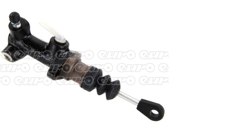

jamiehamy 0 Posted September 15, 2010 Thanks fla. The one that is almost right is this one, taken from Eurocarpart's website. (hope i'm not breaching copyright). I suppose i could bodge it on, but really reluctant to do so. I would need to try thread the hole on the left ( looking from front), then wind a stud in. Or simply use a normal nut and bolt and forego the threaded hole. Not really ideal, but might be forced to by the sounds of it. Quote Share this post Link to post Share on other sites

stereoflaver 0 Posted September 16, 2010 Thanks fla. The one that is almost right is this one, taken from Eurocarpart's website. (hope i'm not breaching copyright). I suppose i could bodge it on, but really reluctant to do so. I would need to try thread the hole on the left ( looking from front), then wind a stud in. Or simply use a normal nut and bolt and forego the threaded hole. Not really ideal, but might be forced to by the sounds of it. I've just fitted this one to my 16v' I had to use M6 bolts as the master had M6 holes instead of having M8 studs fitted into the master like the old one did. As for the pipe I just re-routed it to suit. Quote Share this post Link to post Share on other sites
jamiehamy 0 Posted September 16, 2010 Cool, Sounds like that's what I'll have to do. Thanks everyone for your help, much appreciated. J :) Quote Share this post Link to post Share on other sites
