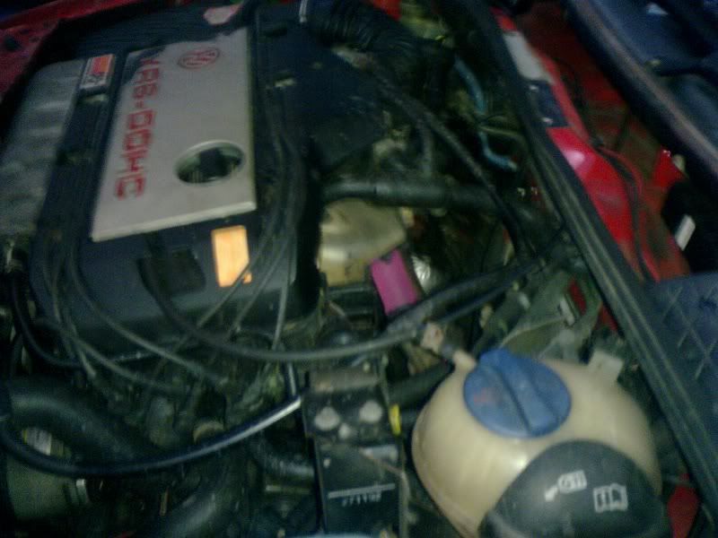

put her on the road this morning and the power at the wheels is 165bhp. I was advised that will translate to about 180ish at the flywheel. There was some pinking going on which will have reduced power. Will go back to Optimax. I've changed back to standard filter instead of K&N panel and cleaned the MAF.
Running nicely. WIll go back once I've had the LPG conversion done next week.
All in all, i'm quite happy that most of the ponies are still there :)
Hot downpipe!
