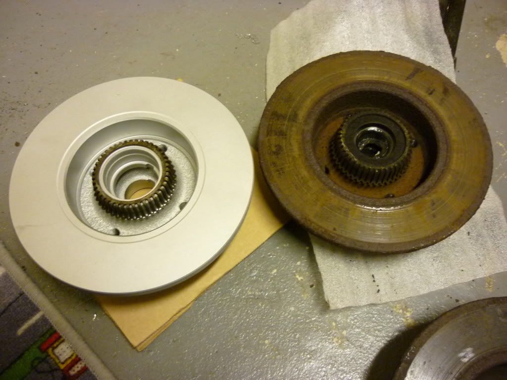

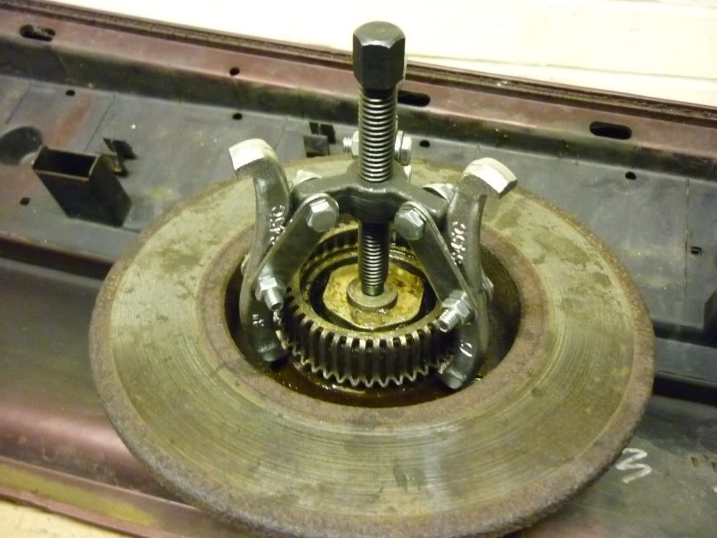

davidwort 0 Posted November 3, 2010 I most certainly do have a micrometer, should have thought of that, failed on the brake discs, picked them up from my dad's and they are non-abs ones :roll: so will try the new discs on tomorrow. Odd thing with the discs is, the abs rings popped off the old ones with a very gentle lift from a little 3 leg puller, and they fit on the non-abs brembo disks just fine, it's just they aren't a tight fit to stop them spinning :shrug: otherwise there's no difference between the abs and non-abs ones :confused4: all this abs stuff is new to me :) Quote Share this post Link to post Share on other sites

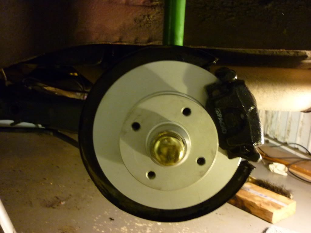

davidwort 0 Posted November 11, 2010 well in the end the stub axles were fine, I reckon I've just been too gentle with the bearings in the past, this time they got a good tighten up to seat them on the stub axles and I've now got next to no play at all... which is nice :) washers are still moveable and discs spin freely. Bit of a result with the discs, ordered 2 pagid discs and sets of pads from ECP, discs non ABS ones by mistake, they are identical to the ABS ones but just minus the ABS rings. pop the old rings off the old discs, pinch them together very very slightly to make a tight fit on the new disc and away. non ABS discs are half the price (trade) of the ABS ones and come with that special paint coating to stop them rusting too :clap: (the abs ones we ordered later to compare are bare steel and just oil coated which needs cleaning off) removing old abs rings, not tight at all, just that the puller was easiest way to pop them off. old ring pushed onto new disc Quote Share this post Link to post Share on other sites
