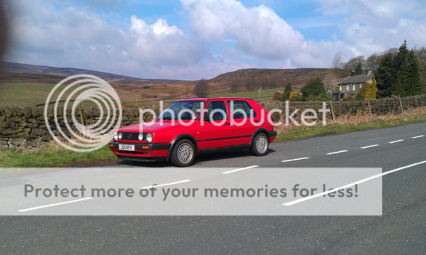

tony_ack 0 Posted May 23, 2012 This... ...is all your fault! Knew I wouldn't be able to resist another 8v. Quote Share this post Link to post Share on other sites
boost monkey 0 Posted August 23, 2012 awesome!!! :D the more I look at repairing ours properly, the more I think i should juts give it away and get another C. Quote Share this post Link to post Share on other sites
CazzaVR 0 Posted August 24, 2012 Well done on the MOT pass matey. Obviously a well looked after mota ;) Tony, looks very nice! 8) Don't let him influence you any more- next up you'll be buying a 16v Corrado that doesn't work... :lol: Quote Share this post Link to post Share on other sites
