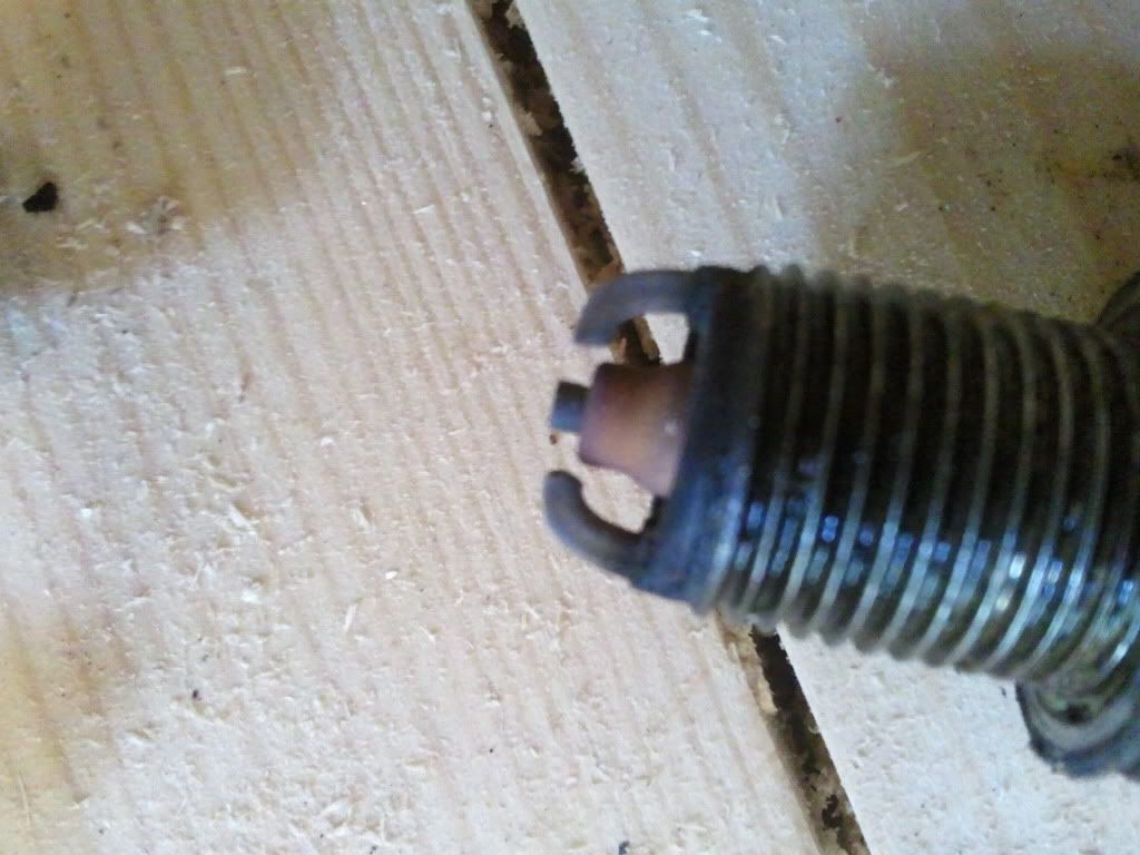

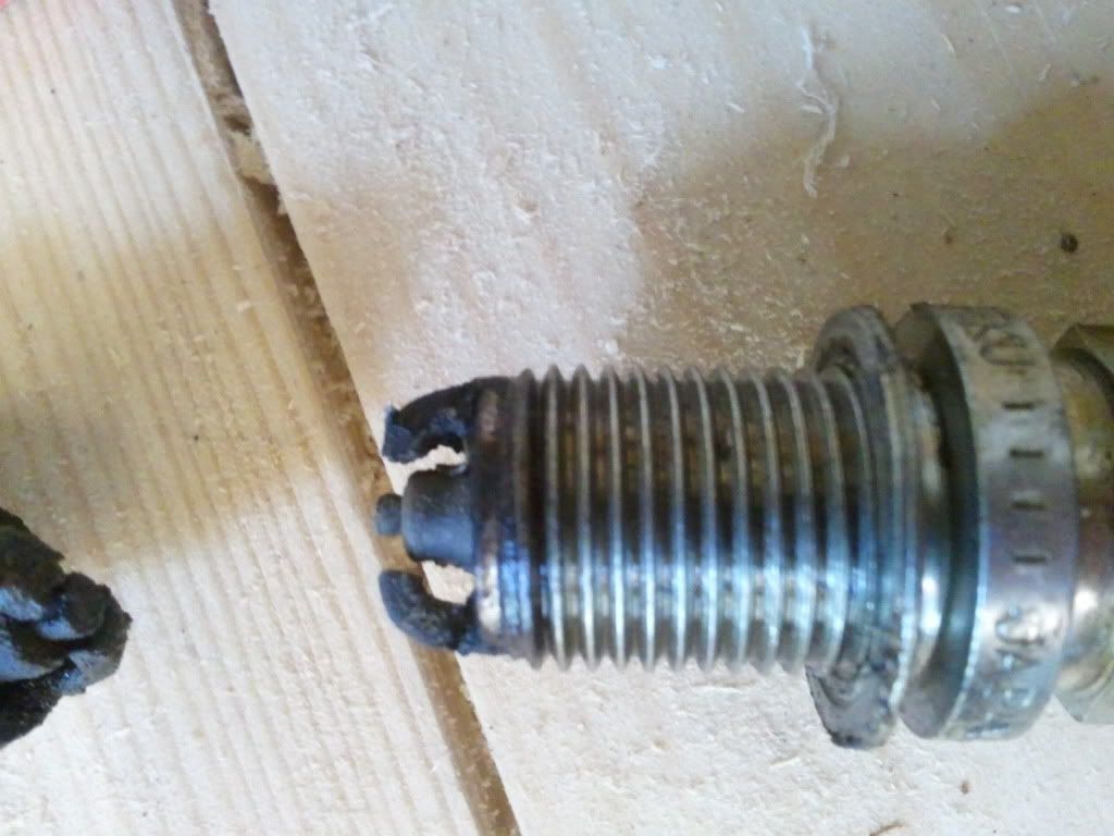

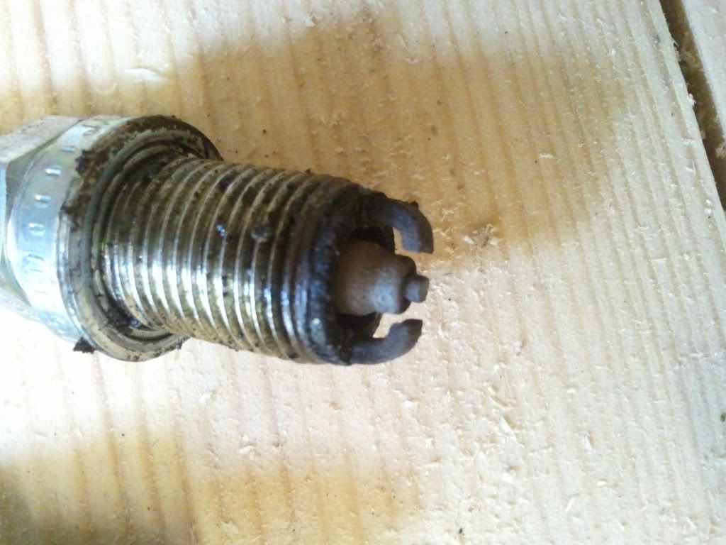

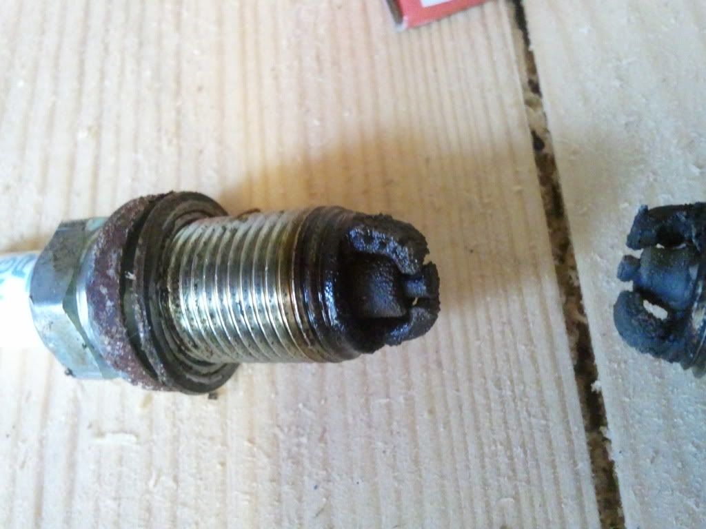

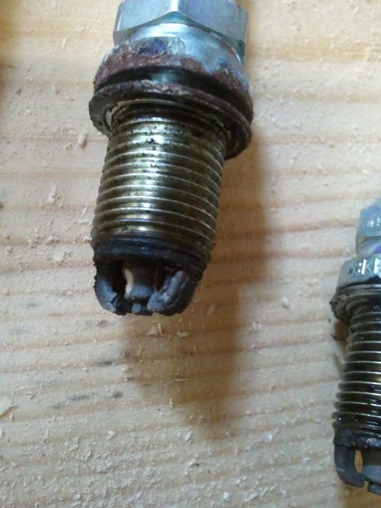

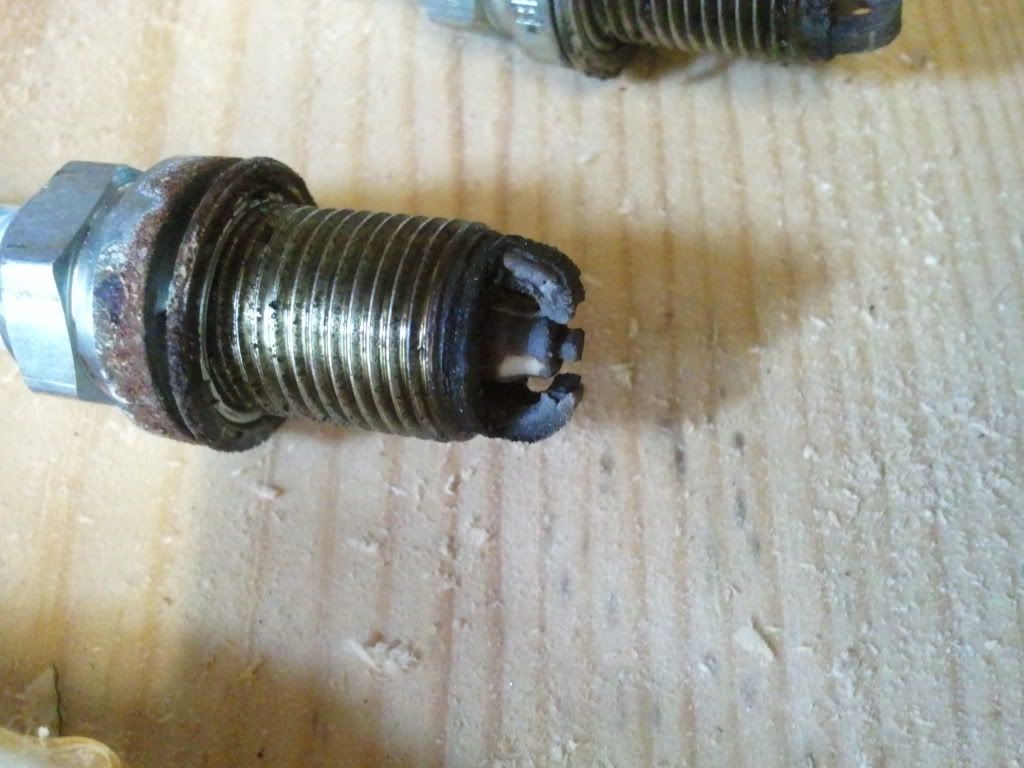

TimDoc 0 Posted June 23, 2011 no blue smoke, will post a picture of the plugs removed the other day t ---------- Post added at 11:09 AM ---------- Previous post was at 10:40 AM ---------- right - heres the pics cylinders numbered 1 2 3 4 5 6 Any suggestions Tim Quote Share this post Link to post Share on other sites

VR6Pete 0 Posted June 23, 2011 Those plugs have seen better days! :) Quote Share this post Link to post Share on other sites
TimDoc 0 Posted June 23, 2011 funnily enough - they are only around 9 months old! now replaced though! thinking the root cause needs sorting, which might be engine internals?! T Quote Share this post Link to post Share on other sites
dannyboy 0 Posted June 23, 2011 6 looks covered in oil and deposits-bad 2 and 5 are good Rest is covered in deposits,maybe from burnt oil or coolant. Valve guides worn maybe? Them plugs deffo need to be replaced,deposits are whats probably causing the misfire.You need to find out whats causing the deposits,more likely to be oil or coolant Ive never seen a spark plug gap that big before... maybe just my imagation Quote Share this post Link to post Share on other sites
Critical_Mass 10 Posted June 23, 2011 See my post. Its burning oil by the look of it, that is exactly how my plugs looked. Stem valve steals or piston rings. Quote Share this post Link to post Share on other sites
Kevin Bacon 5 Posted June 23, 2011 Yep, just seen the pics and as said already, start saving for an engine rebuild! Quote Share this post Link to post Share on other sites
