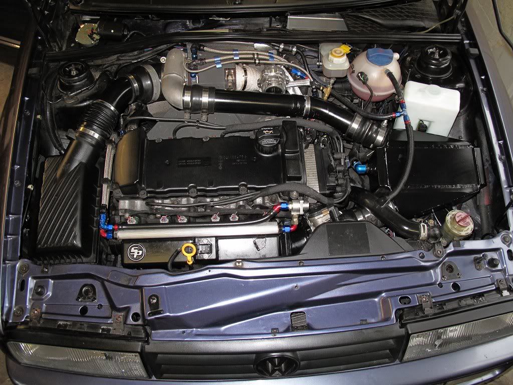

Kevin Bacon 5 Posted July 5, 2011 Here's the smaller bottle fitted. It kind of bolts across the standard bottle and expansion tank brackets. Quote Share this post Link to post Share on other sites

bristolbaron 10 Posted July 5, 2011 Hmm.. replacted looks pretty good.. was thinking about moving my battery and washer bottle to allow space for air feed. do you have pics of the boot setup kev? Quote Share this post Link to post Share on other sites
Kevin Bacon 5 Posted July 6, 2011 I've got this one on my phone as it happens! The battery used to be in the boot as well but that's now under the arm rest. Quote Share this post Link to post Share on other sites
