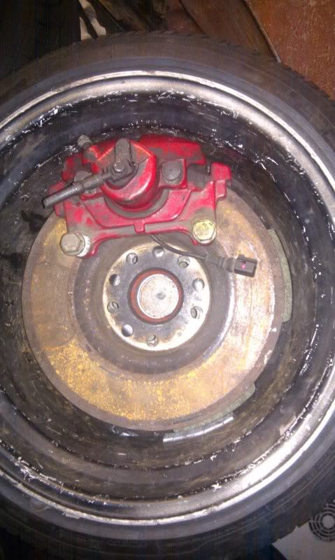

Not a chance in hell unfortunately, here they are sat behind 16's! Won't fit without a lot of metal being taken off, that caliper is resting on the outside edge of the wheel and I don't even think the disc is centred there!
