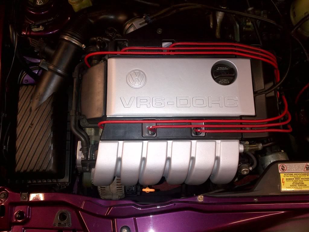

ChrisL 18 Posted December 28, 2011 (edited) Quick pick to start with then: Edited December 28, 2011 by ChrisL Quote Share this post Link to post Share on other sites
Stonejag 10 Posted December 29, 2011 Very nice! Where did the cover come from? Mine's cracked and that looks great with the polished manifold Stone Quote Share this post Link to post Share on other sites
Macdaddy 10 Posted December 29, 2011 More pics and any advice on removing it pls, i'd heard you didnt need a new gasket really when just changing the upper? I'm planning to remove the maniofld and rocker this coming week. Looks very clean under that bonnet of yours! Quote Share this post Link to post Share on other sites
VAG-hag 0 Posted December 29, 2011 chris.... have you an owners thread?? C looks LOVELY! Quote Share this post Link to post Share on other sites
ChrisL 18 Posted December 29, 2011 Very nice! Where did the cover come from? Mine's cracked and that looks great with the polished manifold Stone The Engine is as I bought the car, but I believe Bill bought the cover and had the VR6 DOHC etched on it. More pics and any advice on removing it pls, i'd heard you didnt need a new gasket really when just changing the upper? I'm planning to remove the maniofld and rocker this coming week. Looks very clean under that bonnet of yours! I'll keep the pics coming as I progress. I changed the gaskets incase and they were only £15 for the manifold and throttle body. chris.... have you an owners thread?? C looks LOVELY! Hi Chris, I think this should be the link to my thread. http://the-corrado.net/showthread.php?58058-Blackberry-VR6-BBS-RS301-s-17-year-wait! Quote Share this post Link to post Share on other sites

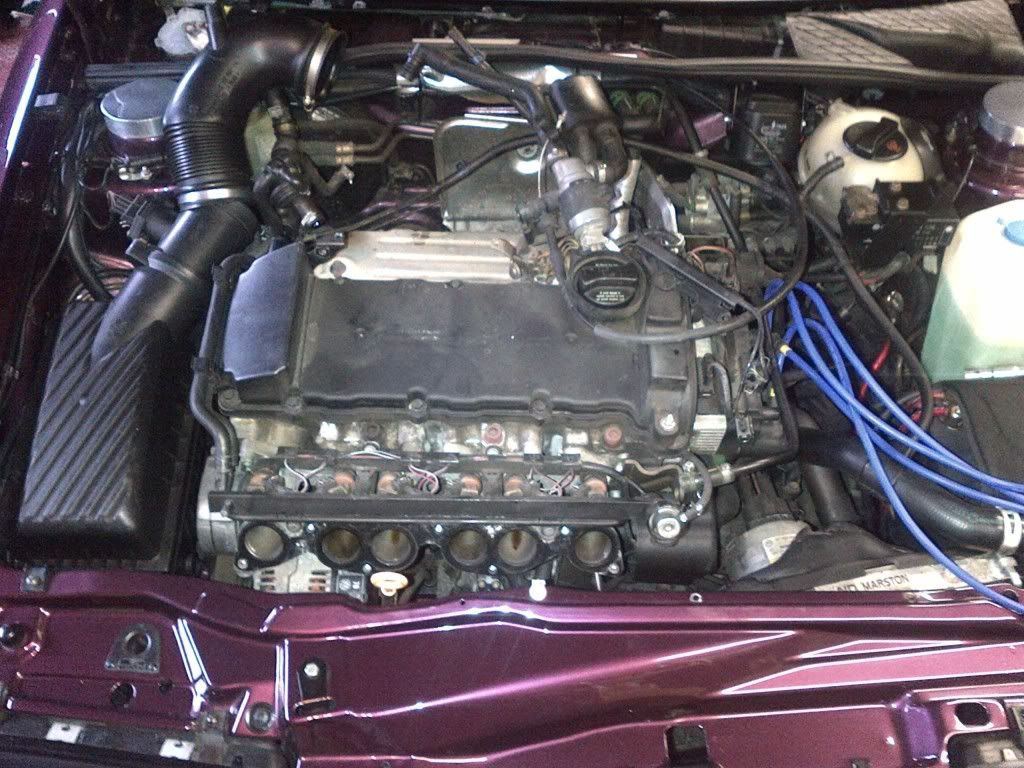

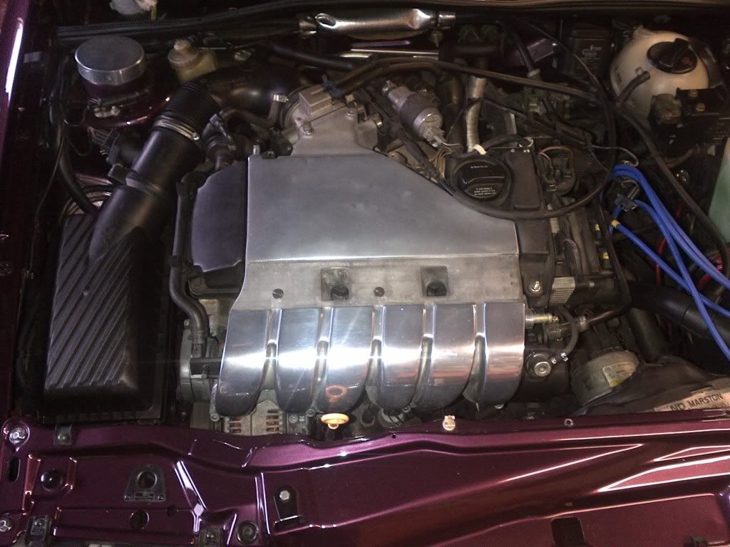

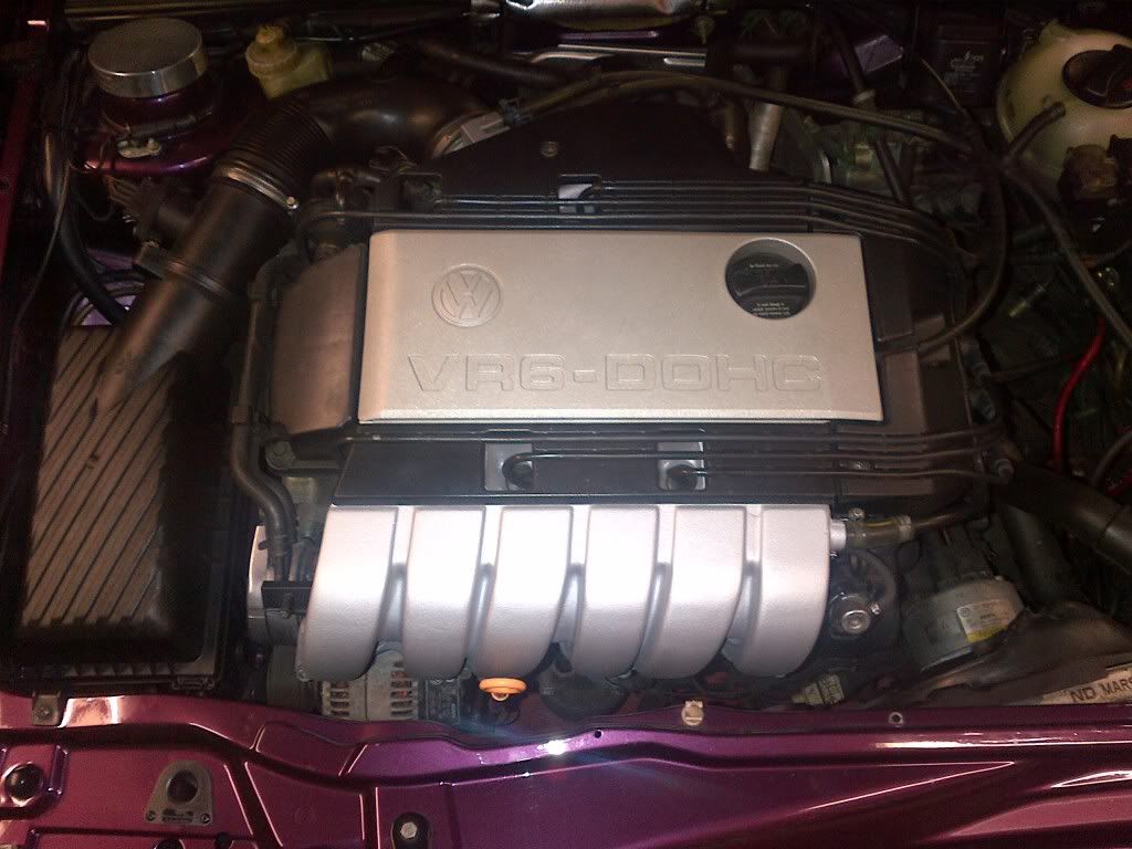

ChrisL 18 Posted December 30, 2011 All done now except for the new HT leads. Not a bad job really and easier then expected. It did seam that everything I wanted to remove was covered by something which led to something else being taken off!! Started with leads, and engine covers: I tried to take the throttle body off and leave the throttle cable connected but one of the screws was really tight so I had no choice, was probably the best thing to do though. Everything removed: Putting everything back was easy and I had it done, a lot less 'bling' but more OEM and as I wanted it: Going to have to slowly start taking things off the engine now and cleaning it up. Quote Share this post Link to post Share on other sites

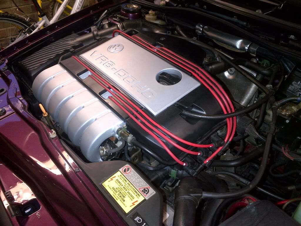

ChrisL 18 Posted January 1, 2012 Fitted red leads today and painted the engine cover: Quote Share this post Link to post Share on other sites
