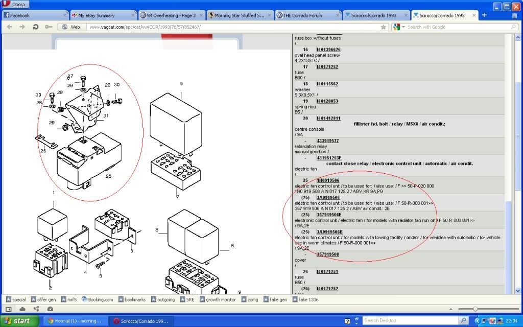

owen g60 10 Posted February 8, 2012 The black box is the after run fan module. They are common to vr golfs and g60s. Possibly others to Quote Share this post Link to post Share on other sites
Critical_Mass 10 Posted February 8, 2012 Ah so that could well be the problem. Is the Golf VR one the same? id imagine it is. Quote Share this post Link to post Share on other sites
owen g60 10 Posted February 8, 2012 yes the golf vr one and the corrado g60 ones are definitely the same. before you replace it lift the plastic cover on the left hand side of it as you look at the engine... there is a fuse in there... 50 or 80 amp... cant remember which. i replaced this fuse as it was blown and allowing the fan to stay on constantly its the part circled in the picture... part 25 Quote Share this post Link to post Share on other sites
