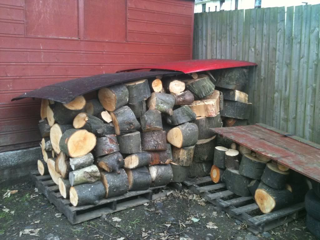

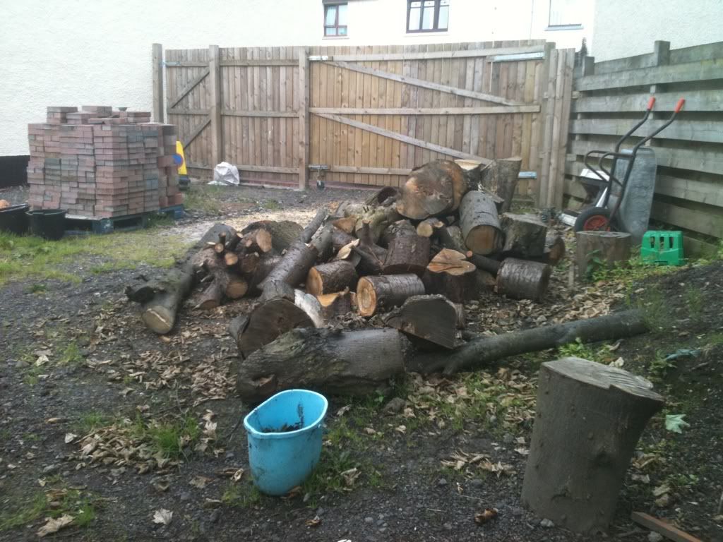

easypops 8 Posted February 10, 2012 Here is a load I got for free last year, round about April/may I think And here is half of it chopped up....... Don't look too closely at what keeps the rain off :lol: Share this post Link to post Share on other sites
