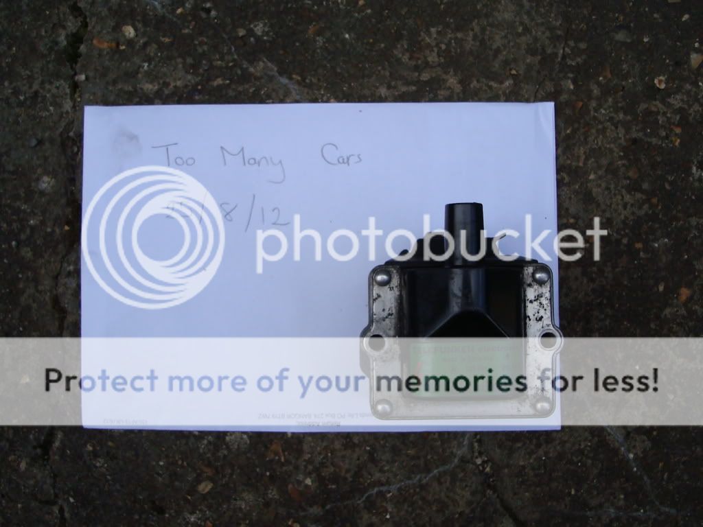

87 Jetta 16v 0 Posted September 24, 2012 I have an ignition coil from a 4 cylinder car. See below. They bolt through the coilpack and into the bulkhead. Quote Share this post Link to post Share on other sites
tentonhammer 10 Posted September 24, 2012 (edited) Thanks for the pic appreciate it Was this off a 9A and does this have the ignition module attached? Pretty sure coil packs for the 9A are cylindrical that's all, or according to 9A schematics they are! Either way I see what you're saying about it bolting directly into the bulkhead Any pics of the cylindrical pack + module mounted to it? Edited September 24, 2012 by tentonhammer Quote Share this post Link to post Share on other sites
87 Jetta 16v 0 Posted September 24, 2012 Hi there, Looking at your pictures, it has the module attached to a home made bracket. With the coilpack, this is built in and has the 3 pin connector attached to the coil pack (you can just see the top of it in the picture) Quote Share this post Link to post Share on other sites
