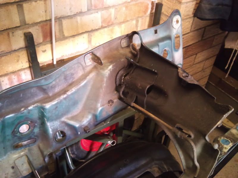

Goldie 2 Posted December 31, 2012 I know this is a common problem and i have used the search to get me to this stage.. So, basically, it went, great.. Managed to remove the grill and get the bonnet open so access is fine.. Spoke to VW today and tried to order everything associated and this is what i have ended up with. The guy wouldn't give part numbers over the phone even though i had just paid for them, new policy apparently... So, on way.. Cable, from handle to left hand lever. Gromits Connection for handle to cable Connection for cable to existing cable (I'm assuming this means cable from right to left on front of car) So, what else would i need if i wanted to change everything? Next question. Where the cable arrives on the passenger side, top edge of radiator beneath the elbow there is a piece of metal which is rotten, is this part of the cable as well? If anyone has any picture of all the parts that would be great or any other info would be nice.. On a side note, price up a Heater Matrix - 150 quid.... Quote Share this post Link to post Share on other sites

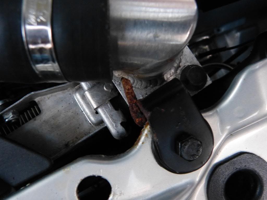

Jim Bowen 1 Posted December 31, 2012 The metal bit bits ob slam panel rust and bend. I think thats what caused my problems. Quote Share this post Link to post Share on other sites

OllieVR6 0 Posted December 31, 2012 The metal bit bits ob slam panel rust and bend. I think thats what caused my problems. As my slam panel is off the car I was looking at these at the weekend and wondering if they can be removed, cleaned and painted? Quote Share this post Link to post Share on other sites
KIPVW 0 Posted December 31, 2012 They come off as recently did mine & had them nickel coated :-) Quote Share this post Link to post Share on other sites
Jim Bowen 1 Posted December 31, 2012 These are the bits I was meaning. Quote Share this post Link to post Share on other sites
OllieVR6 0 Posted December 31, 2012 Yeah them. Thanks both. Quote Share this post Link to post Share on other sites

Goldie 2 Posted December 31, 2012 Ill share the part numbers when i get the receipt, no problem.. I thought it was a bit off about the numbers, the dealer i use is generally spot on.. Ill put a picture up of the metal bit I'm talking about shortly.. Quote Share this post Link to post Share on other sites
Goldie 2 Posted December 31, 2012 Here is the picture of the bit I'm on about.. Quote Share this post Link to post Share on other sites
VWVW 1 Posted December 31, 2012 Thats part of the radiator L bracket structure Quote Share this post Link to post Share on other sites
KIPVW 0 Posted January 1, 2013 As above, not sure if you can still get them mate but that'll come off and clean up a bit anyway. It's to hold the Radiator in place and is like a rubber mounting bush. Once the bolt is removed give the whole rubber bit a twist and it'll work it's way out. You may also need to squirt a bit of WD on the bit that slots into the top of the rad to get it free as they fuse in. Kip ;) Quote Share this post Link to post Share on other sites
Goldie 2 Posted January 1, 2013 Removed the bracket today, i thought it was connected to the cable, live and learn.. Ill take it to work tomorrow and give it some treatment but I'm hoping i can get a new one.. Quote Share this post Link to post Share on other sites
Goldie 2 Posted January 3, 2013 As expected the radiator brackets are obsolete.. Fully cleaned up at work so now i need to think about the best coating option.. Collected the cable today, not a lot for 50 quid... Ill get the part numbers and some pics of the bits tomorrow... Quote Share this post Link to post Share on other sites
