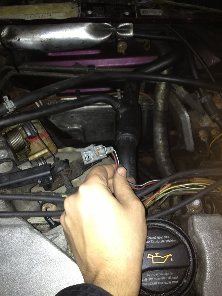

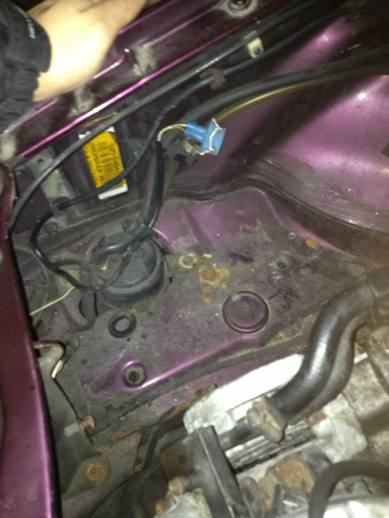

Miniturhero 10 Posted January 3, 2013 Hi guys I have just found 2x plugs in my engine bay that I have no clue as to what they do, does anyone know ? thats the first one on the left hand side of the engine bay. that's the second right next to the throttle body I've got the obd1 setup and I already have the plug that goes into the throttle body. Quote Share this post Link to post Share on other sites
KIPVW 0 Posted January 3, 2013 The blue one could be the one that goes to the Air temp sensor which is located in the mesh grill section under the bumper. Dunno about the other one. Quote Share this post Link to post Share on other sites

tony_ack 0 Posted January 4, 2013 A little voice inside me is saying that the grey one is for the ISV, but I don't know for sure... Quote Share this post Link to post Share on other sites
dumptyboy 0 Posted January 4, 2013 (edited) Grey one is for cold start valve. But the valve is not fitted on British cars, so connects to a dud connector between the oil breather pipe and the rocker cover. Edited January 4, 2013 by dumptyboy Quote Share this post Link to post Share on other sites
dannyboy 0 Posted January 4, 2013 As tony said I'd say it was the isv plug too! But where is the isv? Isn't the isv supposed to be attached to the throttle body?.I see the hose attachment to the tb under the throttle cable but no is attached.I don't know vr6 engines really but I know g60s won't start without the isv connected and defo won't start if its missing Quote Share this post Link to post Share on other sites

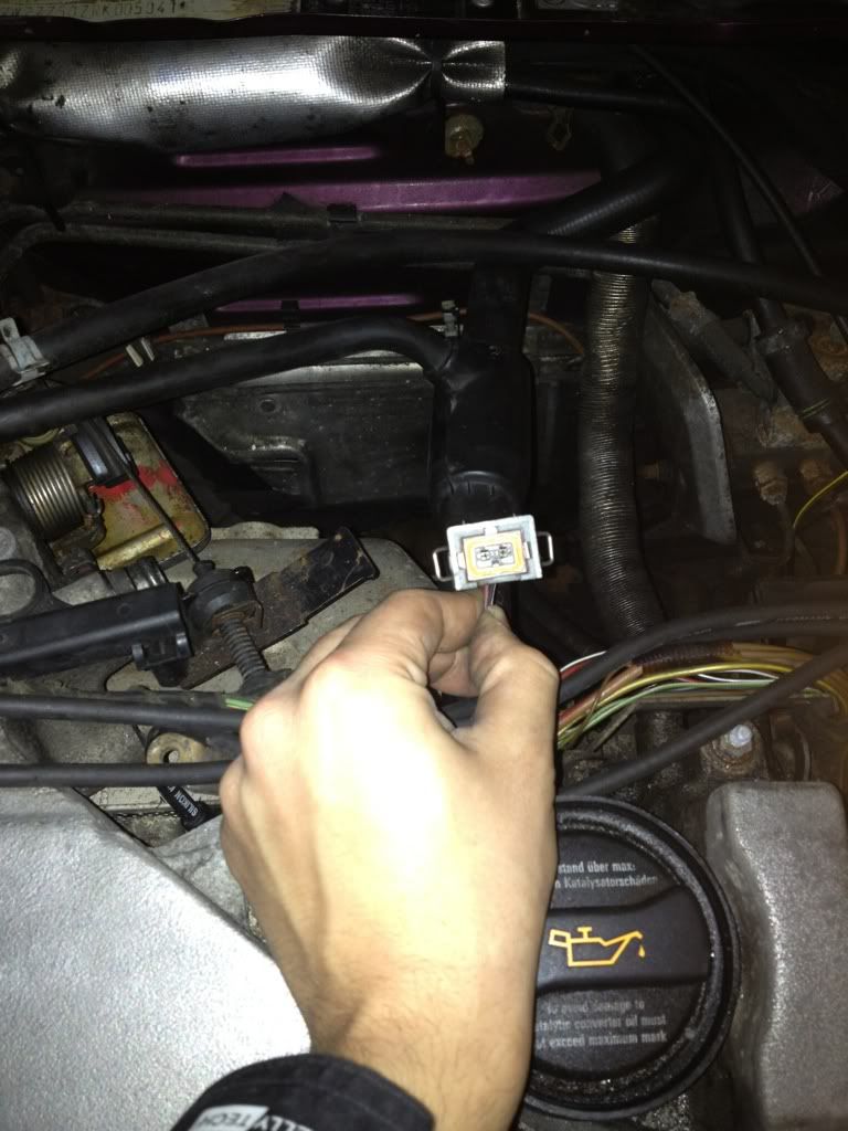

Miniturhero 10 Posted January 4, 2013 I think I've already connected that , is the isv plug the one in this pic if so I have that , and the grey plug in question is on the other side Quote Share this post Link to post Share on other sites
dannyboy 0 Posted January 4, 2013 That's the oil breather isn't it? Isv should be beside the tb Quote Share this post Link to post Share on other sites
Miniturhero 10 Posted January 4, 2013 I think your right its for the idle control valve (isv) thank you guys !!! I will try the salvage yard tomorrow as they have a mk3 golf vr would that work the one off of a golf vr to put on a rado vr ? Quote Share this post Link to post Share on other sites

dannyboy 0 Posted January 5, 2013 You can get software that deletes the isv but the hole in the manifold should have been plugged up if it had it installed. Quote Share this post Link to post Share on other sites
