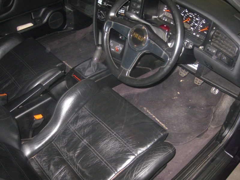

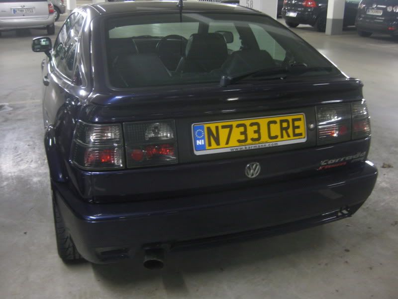

MikeVR6 0 Posted October 17, 2013 A few pics of the Rado and my old Golf TDi. Which I miss dearly but had to go for a family wagon :( Outwardly the Corrado hasn't changed. I'm on the lookout for red or slightly smoked standard rear lights. The number plate holder came from the Corrado Forum visit to the Karmann Factory. Exhaust is obviously a shiny Jetex now. BBS Steering wheel has been replaced with a standard one retrimmed and stitched with purple/red thread to match the Storm theme. Headunit is now an Alpine 136BT DAB with Bluetooth hands free. Boost gauge in the Driver's vent. And the interior is clean! Quote Share this post Link to post Share on other sites
