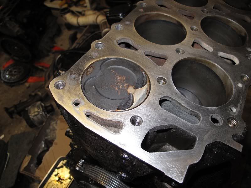

maff 10 Posted March 27, 2013 Good reading but I still cant understand if the crown of the piston is level with the top of the block at TDC? if you know I mean? or are the pistons cast to be level as they meet the top of the block or TDC? Still don't get that bit?? Quote Share this post Link to post Share on other sites
timthetinyhorse 0 Posted March 27, 2013 Scroll through the German document and you will see that only part of the piston is flush with the top of the block so part of the piston is cast with an angled section on it :-) Quote Share this post Link to post Share on other sites
maff 10 Posted March 28, 2013 I thought that's how they got round it;-) Quote Share this post Link to post Share on other sites
Kevin Bacon 5 Posted March 28, 2013 Only the 24Vs have flush piston crowns because the head has combustion chambers. The 12V has a flat head with pocketed pistons instead, which aren't flush, so the squish area is triangular. 12V piston - 24V piston - 12V block - 24V Block - Quote Share this post Link to post Share on other sites

maff 10 Posted March 28, 2013 Great pics:-) they've obviously designed the crank pistons/combustion chamber to reduce the load on the outside of the bores then as the piston isn't travelling straight down, interesting! I am now more knowledgeable! Quote Share this post Link to post Share on other sites
