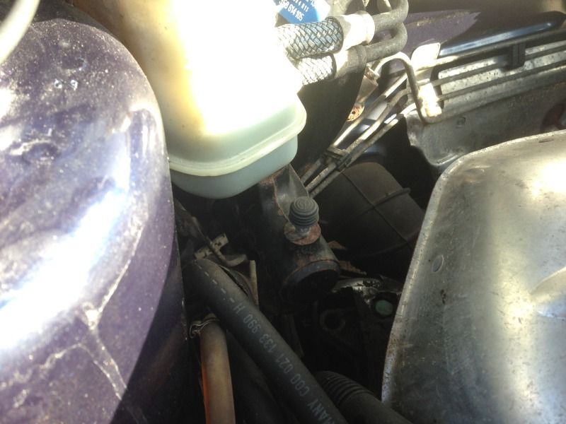

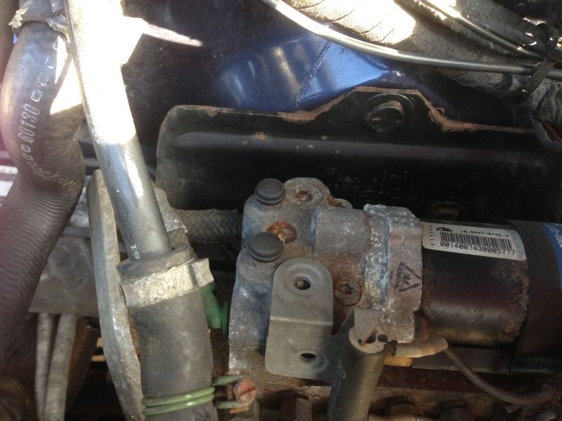

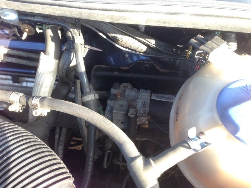

mic_VR 3 Posted August 17, 2013 Abs unit under reservoir Master cylinder on back of servo Quote Share this post Link to post Share on other sites
delfinis38 1 Posted August 17, 2013 thanks that's great ! just found them . Quote Share this post Link to post Share on other sites
sexybourbon 0 Posted August 17, 2013 Thanks mic thats a great help i would have been searching for those , now im being a novice here but when i bleed those bits where does the fluid exit ? Sounds thick and probably is but i cant work it out , do i undo a caliper nipple again and it will find its way through the system ?? Quote Share this post Link to post Share on other sites
mic_VR 3 Posted August 17, 2013 They work exactly the same as the bleed nipples on the calipers. Just do the calipers first, then abs, then master cylinder. Follow the post on page 1 by mr.ots for the order. If you're having issues getting them undone get some plus gas on them and let it soak in. Wd40 will help as well if you don't have plus gas. Quote Share this post Link to post Share on other sites

MoonlightVR6 10 Posted November 24, 2013 Hi people, I am an complete idiot when it comes to fixing my Rado, but I want to try to bleed the brakes tomorrow. I have a bleed tool which my engineer friend told me is really useful. I plan to follow the order Mr Ots mentioned earlier , osr, nsr, nsf, osf. Here is my dumbness shining through. You mention I need to also bleed the "Then bleed at the two bleed nipples on the top left of the ABS pump and finally the bleed nipple on the master cylinder." Where exactly are these 2 parts housed? ...Would I be right in assuming one will be located near the fluid reservoir, if I follow the pipes down? My car is stranded at my work so I cant have a look under the bonnet until tomorrow. Quote Share this post Link to post Share on other sites
Wullie 1 Posted November 24, 2013 Hi people, I am an complete idiot when it comes to fixing my Rado, but I want to try to bleed the brakes tomorrow. I have a bleed tool which my engineer friend told me is really useful. I plan to follow the order Mr Ots mentioned earlier , osr, nsr, nsf, osf. Here is my dumbness shining through. You mention I need to also bleed the "Then bleed at the two bleed nipples on the top left of the ABS pump and finally the bleed nipple on the master cylinder." Where exactly are these 2 parts housed? ...Would I be right in assuming one will be located near the fluid reservoir, if I follow the pipes down? My car is stranded at my work so I cant have a look under the bonnet until tomorrow. See pics in post #12 above. Quote Share this post Link to post Share on other sites
