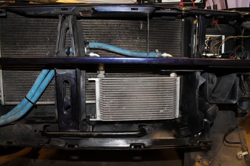

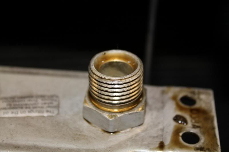

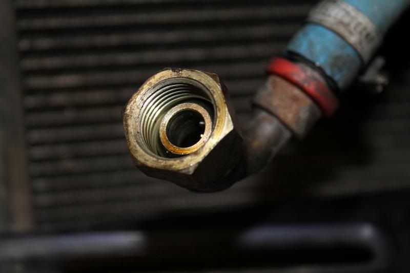

I've got a bit of a problem with a mocal oil cooler.
Basically my Corrado has an after market 13 row cooler fitted and it's got a slight leak, as luck would have it I've got a 19 row cooler sat in the garage gathering dusk.... so simply remove bumper and replace one for the other..
However... slight problem.... they have different fittings...

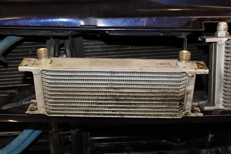

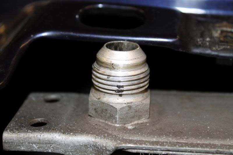

Old cooler..

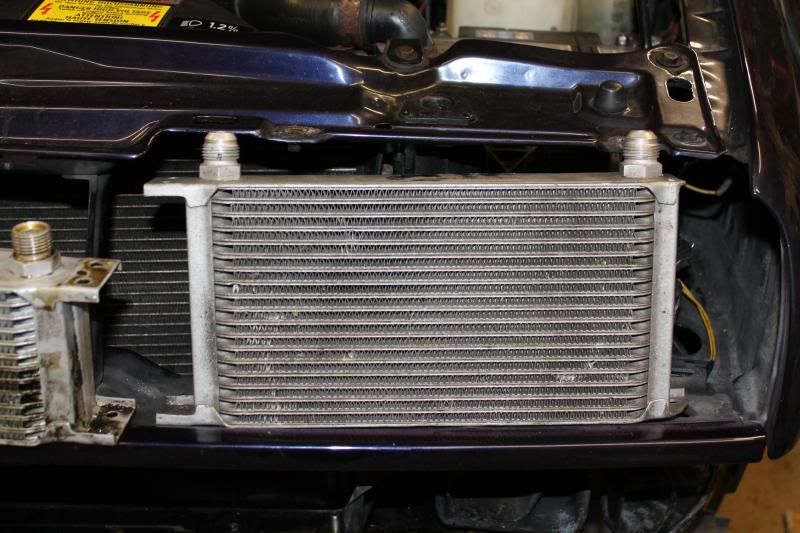

New cooler..
Hose connection..
So what are my options??? I'm thinking either an adapter or new hose fittings...

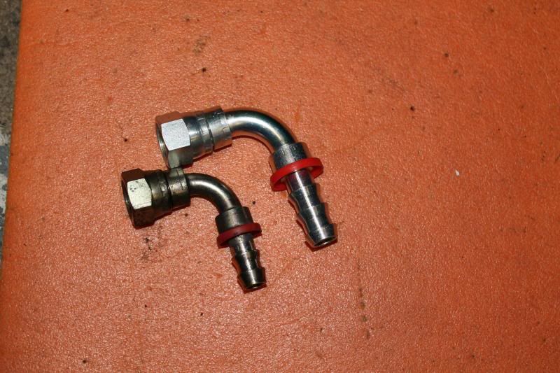

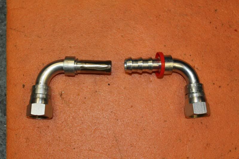

Fittings arrived today and whilst the threaded end fitted fine it appears the push on end is too big.
Old on left new on right
Bugger bugger bugger....there is no way this is going to fit my existing pipe..... what to do.

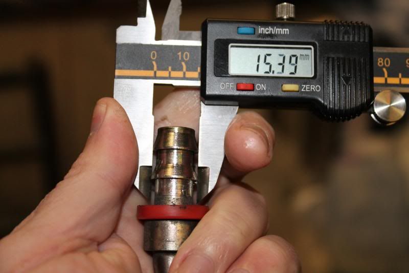

So out comes the old measuring stick.

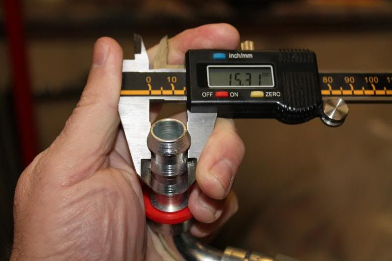

Old fitting is 15.39mm across the barbs.
New fitting is 15.31mm across the shank
Now I know the old fitting fits in the pipe so my theory is if I remove the barbs I may be able to get the new fitting to....er... fit...lol.

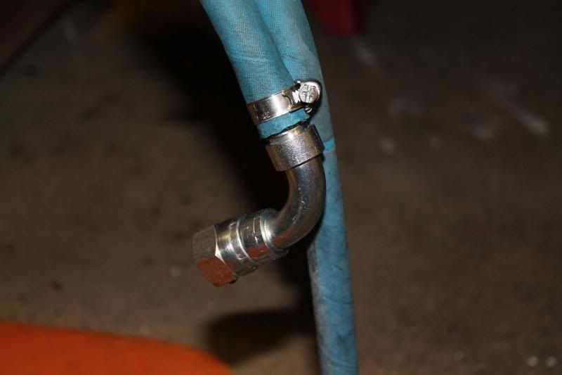

A little tickle with Gary the grinder and this is the result.
A squirt of dub 40 and plenty on sweat, tears and swearing later.
Taaaaa Daaaaa....
It fits, it's bloody tight and I don't think it'll come off but I put a jubilee clip on for piece of mind.
And, the finally result.
All tested up to working temp and no leaks so far.
Rog.
