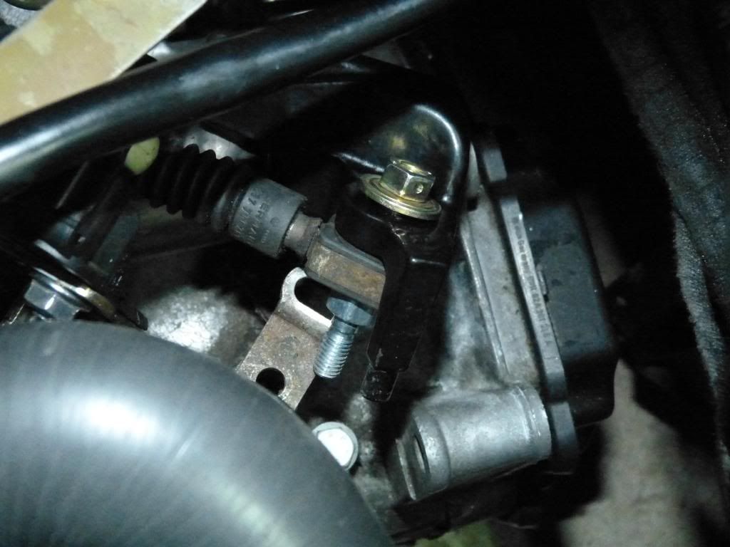

Goldie 2 Posted February 14, 2014 On the end of this spindle that goes through the shift weight.. Should there be a nut or something else? I don't remember what was there to secure the spindle through the slot on the gear change.. Any clues?? Quote Share this post Link to post Share on other sites
mic_VR 3 Posted February 14, 2014 It should be, from the top, - nut, weight, spindle, cable, washer. Then there should be a square nut that fits inside the selector arm which you screw it into. Quote Share this post Link to post Share on other sites
ChrisL 18 Posted February 14, 2014 Yep, Just been to the garage to check mine and there should be a square threaded nut in between the selector arm Quote Share this post Link to post Share on other sites

mic_VR 3 Posted February 14, 2014 (edited) Sorry, no pics I'm afraid just memory. It's just a square m8 nut. I think I've got a spare if you can't find it. Like this http://www.ereplacementparts.com/images/part_252157-5.gif Edited February 14, 2014 by mic_VR Quote Share this post Link to post Share on other sites
Goldie 2 Posted February 14, 2014 So the square nut goes under the linkage with the slot in? I may have to take you up on that Mic if i can't find it... Quote Share this post Link to post Share on other sites
ChrisL 18 Posted February 14, 2014 It goes between the linkage arm. I can take a picture of mine if you want? pm me your mobile number I'll send it over. Quote Share this post Link to post Share on other sites
mic_VR 3 Posted February 14, 2014 That's cool, just let me know. The nut goes inside that linkage where the slot is, that's what holds it in place. Quote Share this post Link to post Share on other sites

Goldie 2 Posted February 15, 2014 All sorted, nut found in a pile of bolts that were destined for the spares box.. Thanks for the help... Quote Share this post Link to post Share on other sites
