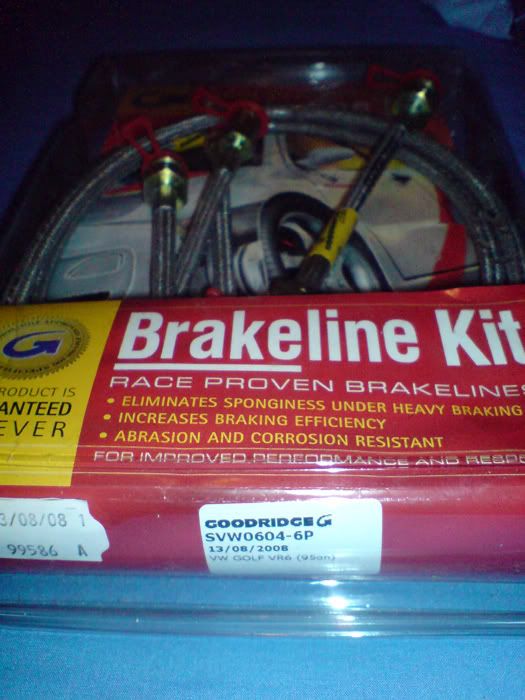

Hawkesybaby 10 Posted April 25, 2014 Yep, the only thing you'll need are the braided conversion hoses for the calipers front and rear which come as a set from C&R Enterprises at around £60 I believe. Obviously you'll need to replace the front discs and pads (late spec mk3 GTi or VR6 - *NOT* mk4 as the disc offset is different Just spoke to these guys and he said they are all 288mm anyway and will cost me 115 squids??? Quote Share this post Link to post Share on other sites

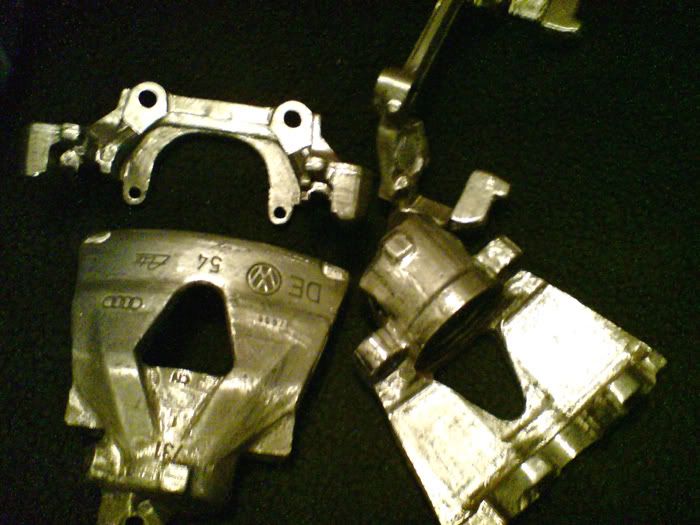

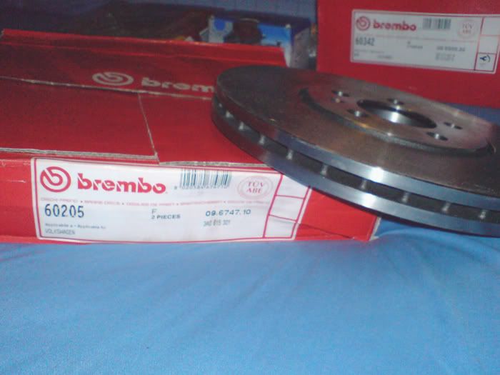

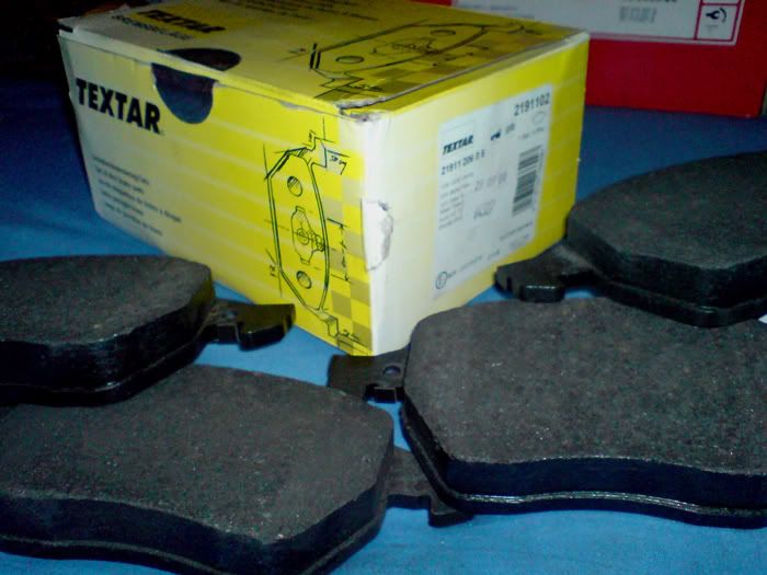

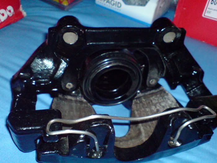

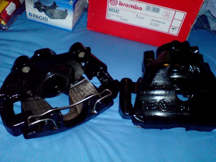

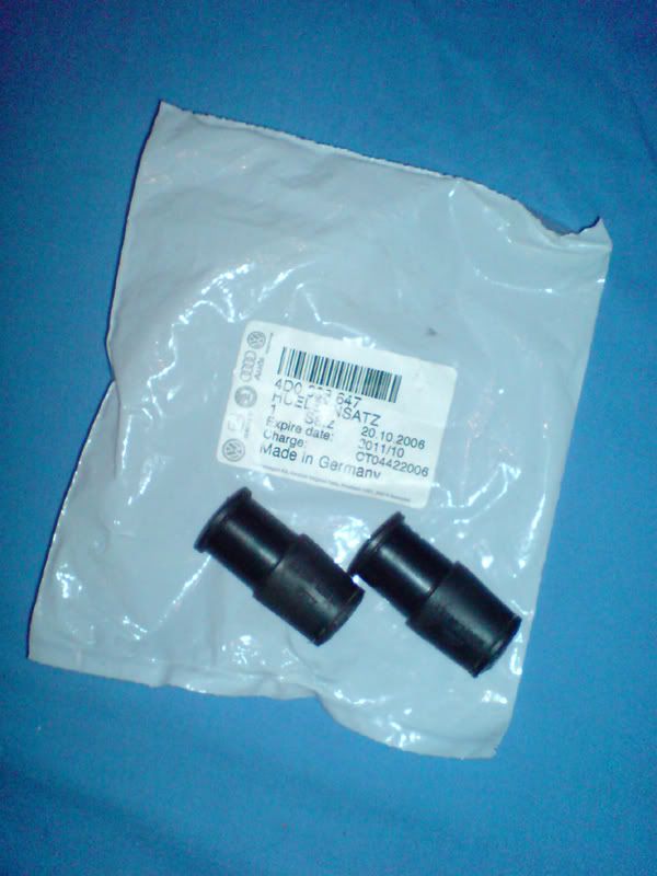

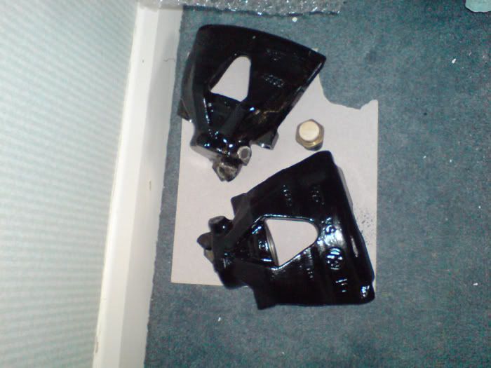

Jim Bowen 1 Posted April 25, 2014 Just some general information i have gathered from replacing all my brakes......Will update this thread as i go along, at this moment i'm just gathering all the bits and pieces i think i need. A popular modification to the corrado is upgrading the front brakes from 280mm to 288mm. You will need: 288mm CALIPERS & CARRIERS - These can be from a late golf VR6 95onwards or a Passat VR6. (i'm using golf ones) DISCS - To suit calipers you have chosen.. (i got plain brembo vented discs, again from a 95onwards golf VR6) PADS - To suit calipers you have chosen. HOSES - I am using a set for a mk3 golf VR6 95onwards which have a banjo fitting, the passat calipers use a screw fitting i'm told (same as the corrado calipers) REBUILDING THE CALIPERS When mine arrived they were 2nd hand a bit grubby, they are simple to dismantle into pieces, the pistons just pop out if you connect a foot pump to the calipers and pump them out. You should have all these pieces shown in photo, the old bits of hoses aren't important but useful to connect the foot pump to when getting pistons out. After a wire brush and a bit of elbow grease. here is the lipped egde on the piston bore that the rubber seals fix to, they just pull out. After a bit of dremel action they come up much cleaner, ready for painting. Caliper painted, just brushed on some hammerite smooth. I ordered my new seals and bits from VW. Caliper Rebuild Kit (For Golf VR6 1997/98) -VW Part no: 3A0698471 - Set of seals = £12.51 inc vat, per side. This includes the Piston Seals & Piston Dust Covers Guide bushes (For Golf VR6 1997/98) -VW Part no: 4D0 698 647 - you need 2 for each side, so order twice. Calipers all reassembled, i left one surface unpainted and just smeared a coating of copper slip over that Pics might be in wrong order, just tried to link them all again, in a rush :lol: 1 Quote Share this post Link to post Share on other sites
Dox 23 Posted April 25, 2014 Just spoke to these guys and he said they are all 288mm anyway and will cost me 115 squids??? That's for the correct 6 line set (banjo fittings front and rear), front pair, rear pair and body to rear axle pair, do it once and do it right. Bear in mind the front brakes you remove will sell on as G60 spec calipers and carriers £30 - £60 to get some of your money back and the rears will also sell for £20 or so if fully functional? Its a no brainer to upgrade IMO Quote Share this post Link to post Share on other sites
Sean_Jaymo 0 Posted April 25, 2014 I paid about £65 for my braided conversion kit from c and r. £115 doesn't sound right? Quote Share this post Link to post Share on other sites
Dox 23 Posted April 25, 2014 I paid about £65 for my braided conversion kit from c and r. £115 doesn't sound right? Was that a set of 6? http://www.ebay.co.uk/itm/110749814466?_trksid=p2055119.m1438.l2649&ssPageName=STRK%3AMEBIDX%3AIT Quote Share this post Link to post Share on other sites
Purple Tom 0 Posted April 25, 2014 £115 isn't right....these are the badgers: http://www.candrenterprises.co.uk/shop/goodridge-brake-hose-kit-vw-1989-1995-3.html Don't worry about it saying 312mm - the calipers are the same as the 288mm ones. These have the conversion hoses for the mk4 calipers included as well. Cheers Tom Quote Share this post Link to post Share on other sites
seanl82 23 Posted April 25, 2014 60 + postage for a full six hose set zinc coated. £98 for SS, and a couple of quid more if you want a coloured sleeve. Quote Share this post Link to post Share on other sites
