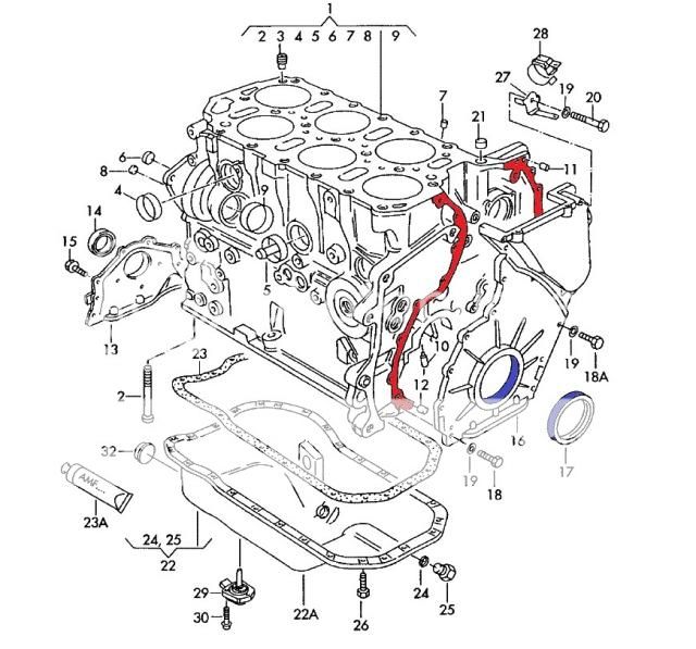

Above is a pic of the upper timing chain cover
This is the bottom cover and possibly where your problem is. The red area is where the sealant is applied so that the oil doesn't leak but within that area is also the crankshaft seal (In Blue). Unfortunately to correct leaks from either of these areas properly would involve removing the gearbox, clutch and flywheel.
With regards to "danger", if you have oil behind the inspection plate within the gearbox clutch casing, you could end up contaminating the clutch with oil which would eventually result in slippage.
I hope this helps and hopefully it wont be anything too major.
