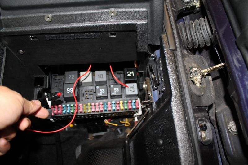

Roger Chatfield 0 Posted July 18, 2014 Little update, I've modified a fuel pump relay with a push button to run the pump manually, this way I can extend the prime time if I get trouble starting. So I tested it and it started fine, however I did notice a petrol smell, on investigating I found a leak at the pump outlet, I guess this may be letting air in when the car is stood and this could be my starting problem... fingers crossed. Rog. Quote Share this post Link to post Share on other sites

Roger Chatfield 0 Posted July 18, 2014 Its done proper mate, took the relay to pieces and soldered a wire onto the coil contact, even drilled a hole in the cover for the wire to exit. Rog. Quote Share this post Link to post Share on other sites
