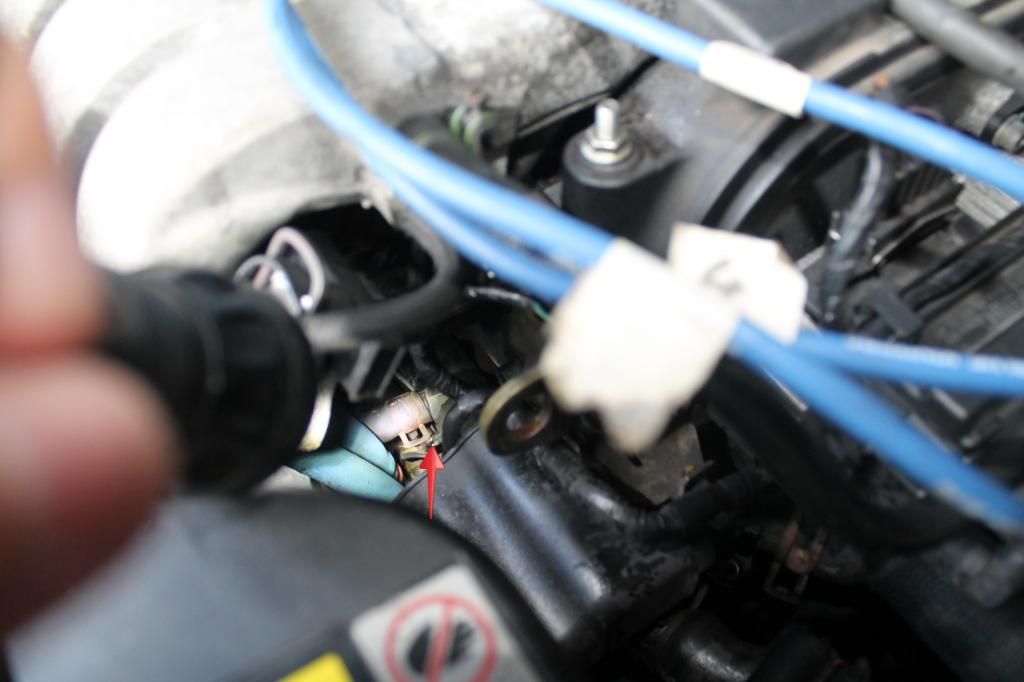

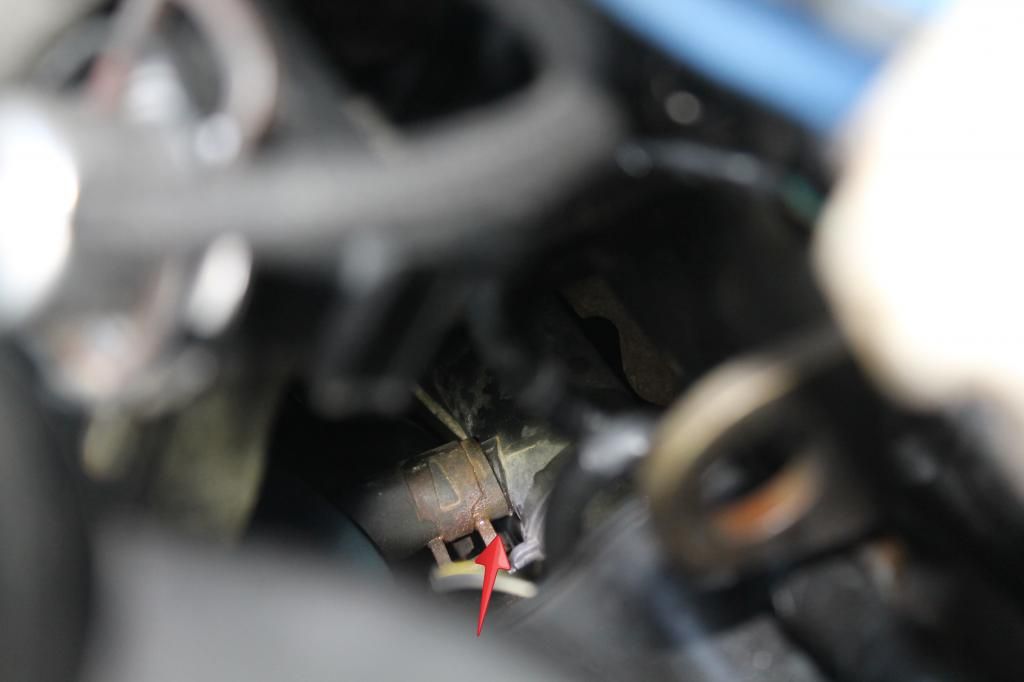

So I was driving along today in town traffic, water temp was 100, oil 110 when the temp warning light starts flashing, so I'm not far from home and seeing that the temps are normal I nursed it home.

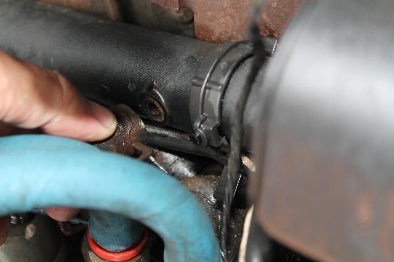

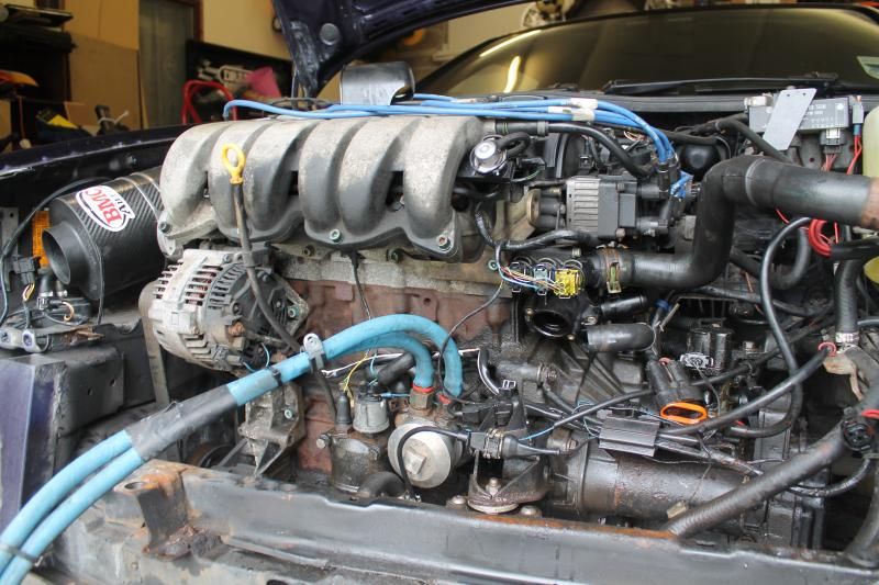

Got the bonnet up and yep, there is water dripping out the bottom of the engine, bugger, got to be the rad so i let it cool down and refilled the system, then ran the engine for a bit... nope its not the rad, its a leak where a pipe joins the solid coolant pipe that run across the front of the engine.
A few pics, the arrow is where the leak is.
I hope you can see where it is.
So, I'm guessing a hole in either the hose or the solid pipe, maybe just a bad joint but I'm not holding my breath.
Look like its a inlet manifold off job, any advice would be appreciated, also it it common for a leak there??
Rog.
Edited by Roger Chatfield
Looks like it is the hose that goes from the crack pipe to the oil cooler. They often fail. It's usually easier to remove the front end to gain access. If you go to the effort of removing the front end it is work replacing the crackipe and both oil cooler hoses while you have access. There are a few other oil seals you could replace depending how far you want to go.
From personal experience I would say do everything you can while the front end is off.
I replaced the oil cooler seals and the rubber pipes only a few days ago without removing the whole front end, i had the bumper off though which was helpful as I could see around the side of the radiator to get an idea of where everything is and could reach under the car.
it would be easier if you have access to ramps to do the job standing up underneath but if needs must, since you are likely to drain the coolant system is wrestle the fan/rad out of the way first you ought to be able to do the job from above.
If indeed it is the pipe from the crack pipe to the oil cooler then yep.. you're ideally gonna have to get the front end off to get at it though thinking back on the job (and the number of times I've had the front end off my car in the last few weeks) you could conceivably get at it from under the car if it were on ramps.. not sure..
Anyway you'll be pleased to know the pipe is still available from VW and not very expensive at all (£6 if I remember correctly?). I'd consider ordering a crack pipe just in case that's gone too.

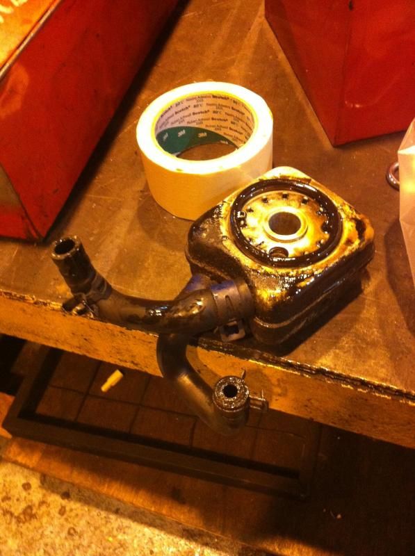

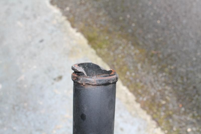

Little update.
I've had a busy day... started like this..
Then this...
And finally this...

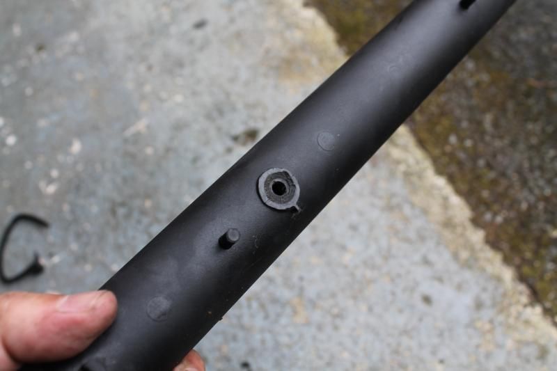

And, we have a culprit.. the crack pipe has gone brittle and.... yep... cracked...lol
I managed to break it even more when I removed it so it's deffo due a change.

Just get a VW crackpipe Roger and before you reinstall give the hole that the crackpipe goes into a damn good clean with sandpaper and get it smooth. Otherwise when you put the new one on there will be a chance that it doesnt sit right or damage the O ring.
£8 from vw spares (manufactured by Mehle). Agree with Jon, take your time and clean the hole well. It'll make fitting much easier.
Daves16v does the brackets Rog, have a look in the suppliers forum for the thread. My crack pipe did exactly that when I removed it too. I got one from vdubmachine for a tenner in the end. As mentioned, give the whole a Damn good rub down and a light smearing of grease before refitting.
They don't just crack, they actually go porous as well. Took mine off after it'd had some K-Seal in the system - in snapped in half on removal and you could see the golden specks of sealant had permeated almost halfway through the wall thickness of the plastic!
The plastic ones last well if you buy new - might as well change the thermostat housing while you're at it as it's the same plastic (so probably also getting tired) and not much extra work. Parts were only about £20 when I did mine.

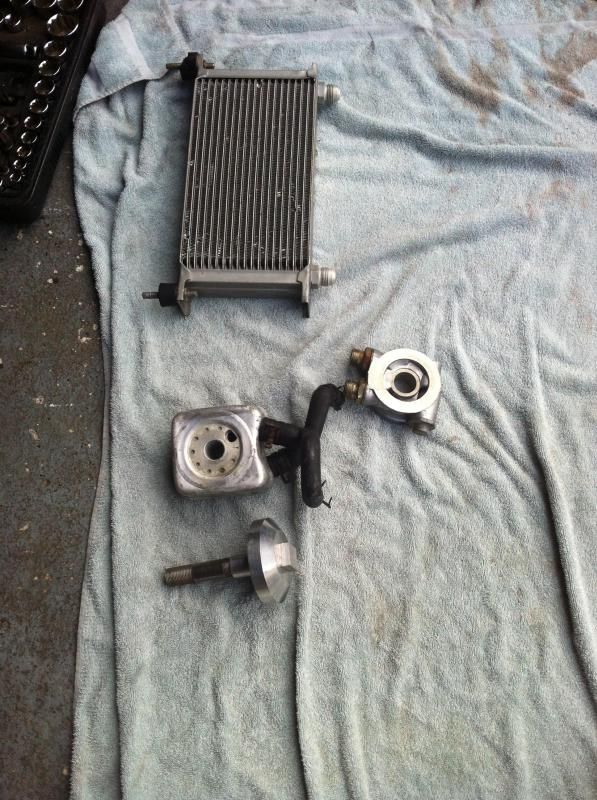

There is definitely a small oil leak somewhere on the mocal oil cooler, I'm not sure if its the hoses, the fittings or the actual cooler so as it was a bit of a bodge when I fitted it I've decided to bite the bullet and buy new Jic 10 fitting and 5/8 piping, the increased bore of the pipe should aid the cooling a bit and hopefully it'll be leak free.
