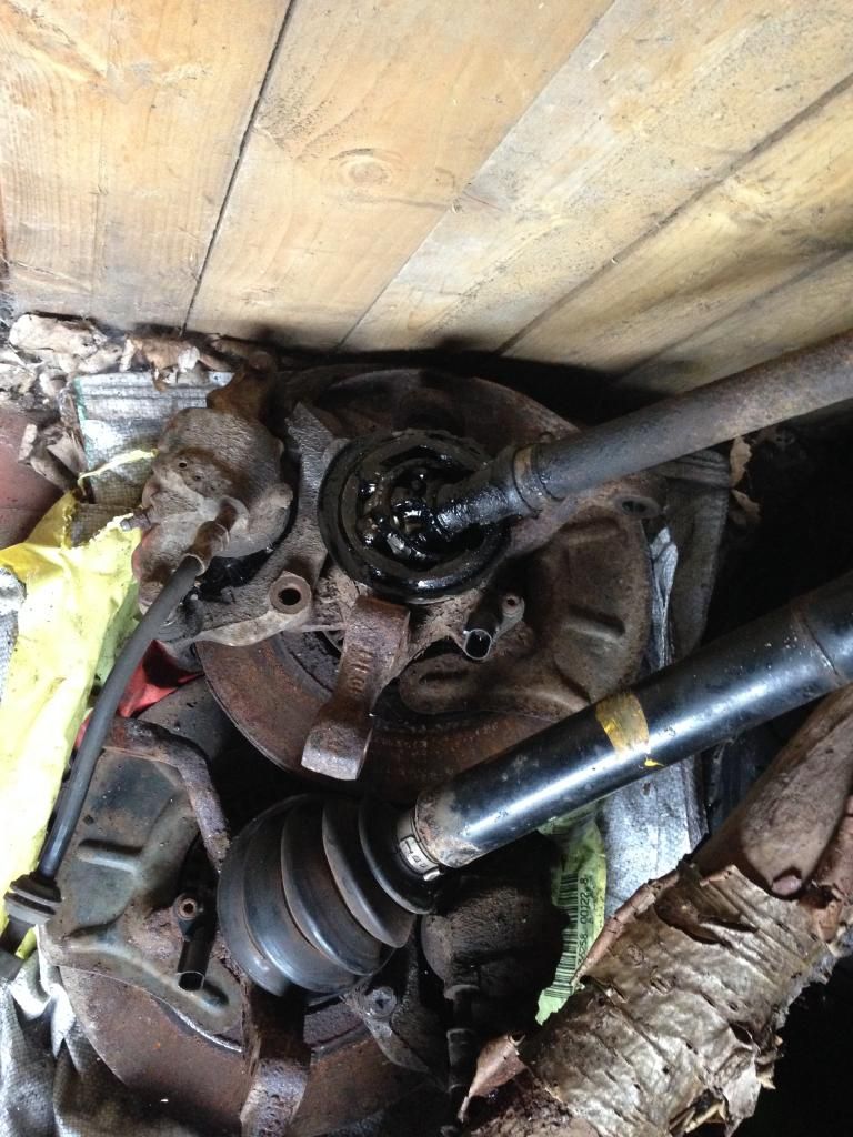

easypops 8 Posted August 29, 2014 (edited) The cv certainly looks like scrap mate, the boot is all burst and I had no plans to ever consider using it. I'll add a photo :) Edited August 29, 2014 by easypops Share this post Link to post Share on other sites

easypops 8 Posted August 29, 2014 Not sure mate but I'll confirm once I get home later, half asleep this morning lol , or if you are at a loose end today, they are lying in my wood shed which is open, you know where I stay :) Share this post Link to post Share on other sites

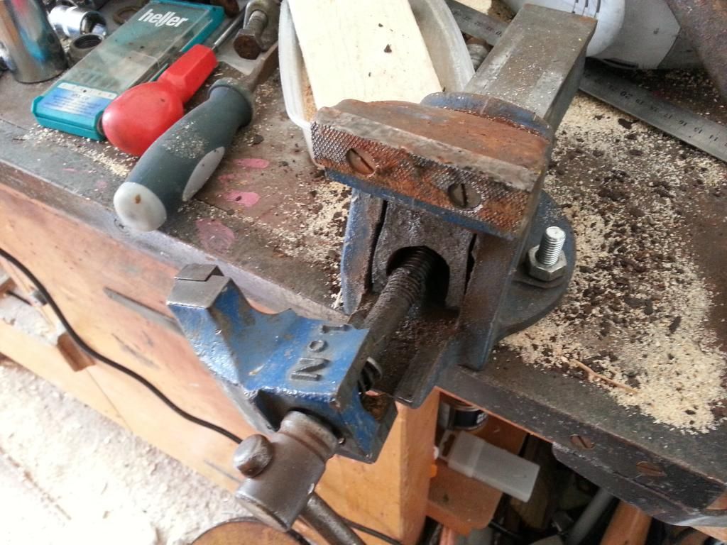

Goldie 2 Posted August 29, 2014 Ok, hopefully ill get over tonight then.. The joints are straightforward, we could 'have it off' in a few seconds.. Share this post Link to post Share on other sites

Goldie 2 Posted August 29, 2014 To split the joints all i did was remove the cir clip (taking about the inner ones) and then hammer it off. It was in the hand vice so didn't need a lot of force.. The outer end (wheel end) didn't take a lot to split either.. This is on the one you sold me Gar.. Rob, i found a brand new genuine off side shaft that was missing the inner CV so have bought the missing one plus the 2 for the other side and am refurbing s spare to build up. The CV kits come with everything in (except the bolts). Im not going to lie not the cheapest but when new complete driveshafts were available they were £350 each.. VW sell them on exchange hence why i need one inner to take back to get my surcharge back.. Gar, i feel bad asking you to post one if i can get one locally. If i get stuck though ill give you a shout... Share this post Link to post Share on other sites
