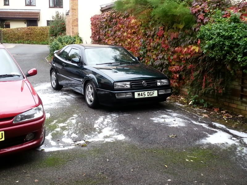

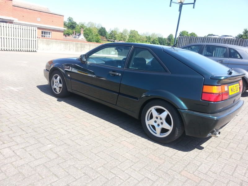

GlosterOx 0 Posted January 29, 2015 Hi Ian Any chance of a picture of how it sits on the speedlines please? No problem, will take some @ the weekend. Ian. Quote Share this post Link to post Share on other sites
seanl82 23 Posted January 29, 2015 Just clicked through your members gallery Ian. Some larger pics here when you first fitted the B12s. http://the-corrado.net/showthread.php?t=50830&p=1012791&viewfull=1#post1012791 Quote Share this post Link to post Share on other sites

GlosterOx 0 Posted January 31, 2015 Some more pics, taken yesterday, of the car on the B12 Kit and Speedlines: Quote Share this post Link to post Share on other sites
Chuggs1 10 Posted January 31, 2015 That's so much better than standard ride height. In fact it looks like how standard should have looked. Thanks for posting the pictures. Now my plan for keeping totally standard is changed again. Brakes being done next.... Then save for this Quote Share this post Link to post Share on other sites
