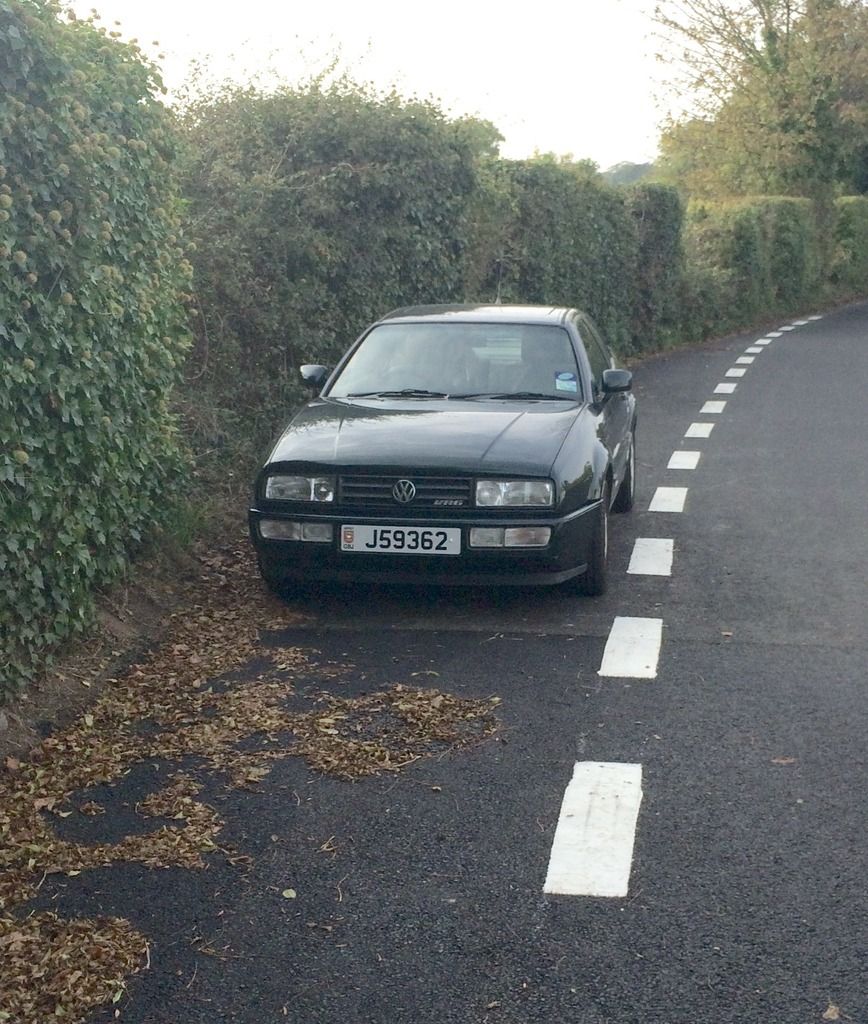

dma-1984 10 Posted March 9, 2015 Hello again, Ive been on here a few weeks now and thought i would post some pics of my car now ive discoverd how to reduce their size. This isnt really a build thread as i dont intend on doing much to my car, its more a heres my corrado i thought i'd share thread, as the pics show the body needs a little tlc which im in the process of getting quotes for. sorry for the bad pics they were taken on my phone and its camera is junk [ATTACH=CONFIG]81056[/ATTACH][ATTACH=CONFIG]81057[/ATTACH][ATTACH=CONFIG]81059[/ATTACH][ATTACH=CONFIG]81055[/ATTACH][ATTACH=CONFIG]81064[/ATTACH] these are the bad bits that need attention and all four wheels are in need of refurbishment and some spacers i reckon [ATTACH=CONFIG]81065[/ATTACH][ATTACH=CONFIG]81066[/ATTACH][ATTACH=CONFIG]81067[/ATTACH][ATTACH=CONFIG]81068[/ATTACH][ATTACH=CONFIG]81069[/ATTACH] I have a couple of subtle touches i intend to do to the look of the car but first priority is a little oil leak and then the rear wheel arch repair I hope you like sorry again for poor pic quality, I will get more up when i find the camera and the car is clean, enjoy:cheers: Quote Share this post Link to post Share on other sites

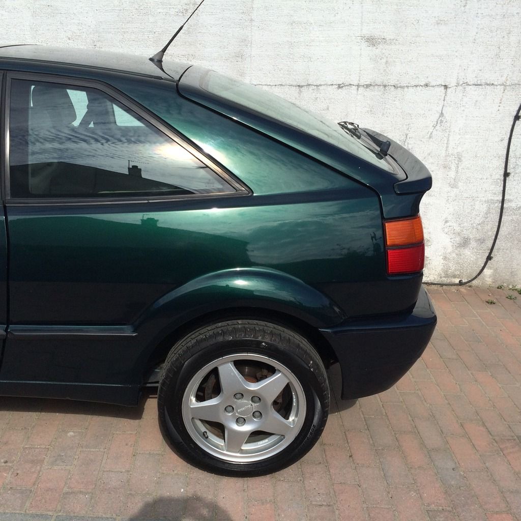

dma-1984 10 Posted June 4, 2015 Finally got round to booking my car into the body shop to repair the damage to the rear wheel arch. Got it back today so pleased with the work,:dance: here's a little before and after Quote Share this post Link to post Share on other sites
