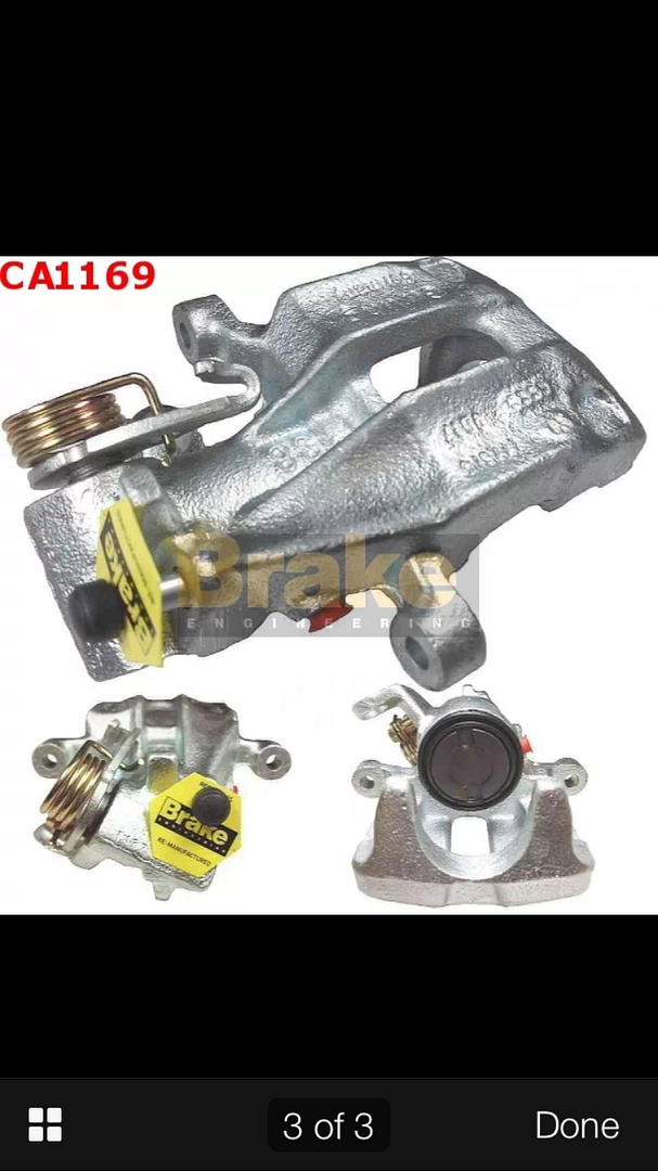

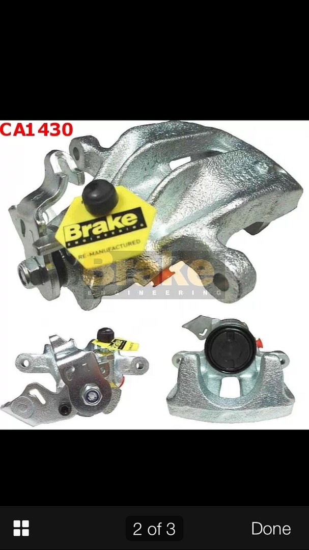

So rather than send me the calipers, they have given me two options. Here are pictures.
I don't have the car with me at the moment to check - anybody able to tell me what ones are for a Corrado??
UPDATE
The top one appears to be correct for the c, the bottom appears to be mk2 golf
