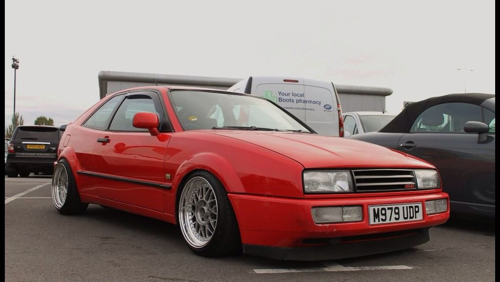

Yandards 0 Posted April 22, 2015 Don't think the stretch is the issue. I'm running 17x8's with a 205 tyre and it's completely fine even though it's a fair bit of stretch. It's the cutting done by the arch. One particularly big bump and it'll cut through. If you're worried about getting the arches pulled or rolled, you can always get a decent bodyshop to cut off the excess lip and reseal the arch. That's what I've got on mine. I'll get a pic for you later if I get chance. Exactly, not that I think that stretching is particularly safe having spent 2 weeks of my life studying tyre construction, but you would be amazed how quickly the tyre would be cut through with a big bump on a dual carriageway. Quote Share this post Link to post Share on other sites
mic_VR 3 Posted April 22, 2015 Exactly, not that I think that stretching is particularly safe having spent 2 weeks of my life studying tyre construction, but you would be amazed how quickly the tyre would be cut through with a big bump on a dual carriageway. Completely agree. I'm in no way advocating loads of stretch, I'm happy with mine as a compromise for the looks. But looking at the OP's pics in the first post, and thinking about this further, the cutting is occurring on the edge of the actual tread rather than the sidewall. Reducing the tyre to a 205 section is going to move that cutting into the sidewall itself and he's going to an even worse (read dangerous) effect. I'm going to say the only option is to change the wheels for something with less poke or sort the arches. Quote Share this post Link to post Share on other sites
TanVr6 0 Posted April 22, 2015 Update: After visiting a few tyre places. They have suggested rolling the arches 1st as cheapest option. One option is better suspension with adjustable damper.(a reason to upgrade to KW or H&R) Last option go back to original dishes and repair and polish? Quote Share this post Link to post Share on other sites

sexybourbon 0 Posted April 22, 2015 Yea Wayne yours look like they have been done with a bat Tan just make sure whoever rolls the arches removes the stone chip and sealer from behind the lip , that will let the arches sit back flat properly I don't think harder suspension is really an option plus you don't want an uncomfy ride or you might stop enjoying it as much as you do I'd seriously look in to milling the disk mounting face on the rear , that will be one of your cheapest options and won't effect your car body / arches , it's been done before on other builds if read and I bet a local machine shop would only charge 20 quid or so to do it Only other thing to do is bang some stretch on , as much as people debate on it and personally I'm not a fan it will work and you never really hear much about people having disasters with it One more thing would be to try some camber shims on the rear that would probs do it aswell Quote Share this post Link to post Share on other sites
Liam20vT 10 Posted April 22, 2015 What's the width of the wheels? I'm currently running 205/40s on 9s et-2, I'm pretty low too, so I am sure you can make it work : Edit: it doesn't scrub either! Quote Share this post Link to post Share on other sites

HummuH 10 Posted April 23, 2015 (edited) Whoever said flaring the rear arches was the easiest option obviously hasn't done Corrado arches before. The rear arches are pigs to roll as they are double skinned, it takes a fair bit of work and I'd be amazed if you didn't need paint work done after it. Something doesn't seem quite right, I don't think ET33 on a 17x7.5 should stick out that much. I ran 16x7.5 ET 35 with 10mm spacers and the wheel was well within the arch. I now run 17x8 ET20 with 20mm spacers, so 0 offset and my wheels are about as far out as yours. Are you sure there's no rear axle spacers being used? EDIT: Sorry, just noticed it's a 5-stud, my offset comments are only really applicable to 4 stud. Edited April 23, 2015 by HummuH Quote Share this post Link to post Share on other sites

Liam20vT 10 Posted April 23, 2015 Are you sure those rear wheels are legal thought they had to be flush with bodywork like fronts. The tread of the tyre has to be under the arch (which it is, just) the wheel can then protrude from the arch by a maximum of 30mm (I think). I havent had any issues with the police though. Quote Share this post Link to post Share on other sites
zak 0 Posted April 23, 2015 the wheels have obviously widened, if they were the original size assuming rs301 they would be 7.5x17 et33. This size is tried and tested on the vr6. If your shell is good i would not touch the arches and would suggest narrower dishes with 205/40/17 tyres. Quote Share this post Link to post Share on other sites
OSV 0 Posted April 23, 2015 the wheels have obviously widened, if they were the original size assuming rs301 they would be 7.5x17 et33. This size is tried and tested on the vr6. If your shell is good i would not touch the arches and would suggest narrower dishes with 205/40/17 tyres. Hi Tan.I agree with Zak, I dont know how much wider your new rear dishes are but starting with ET 33 on a 7.5 the tyre size 205/40 fit perfect with no issues, to work out et divide by 2 any additional mm in width and subtract that number from 33. Thats academic though as with the new wider dishes you are catching the arches, cheapest option is refit 205/40s and see how you get on, or replace stock 0.5 dish? Gareth Quote Share this post Link to post Share on other sites

TanVr6 0 Posted April 30, 2015 Latest: arches rolled! Thanks to Rob from Arch Attack!!! Quote Share this post Link to post Share on other sites
