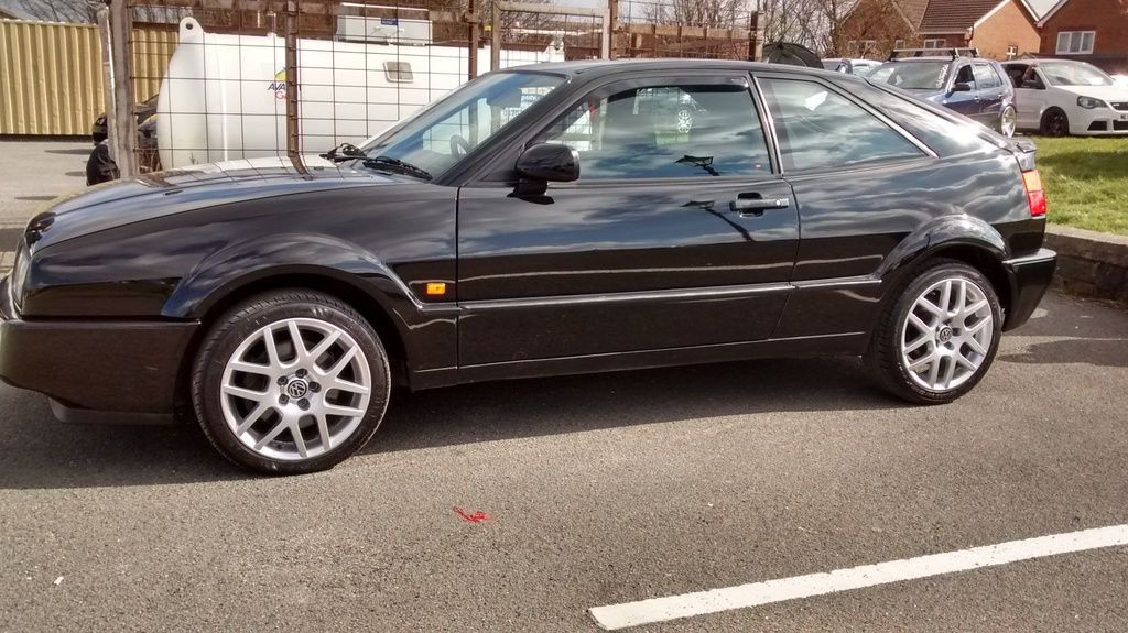

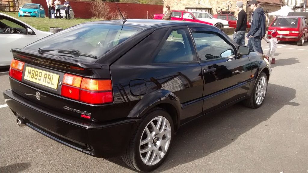

Jim 2 Posted August 3, 2016 Guess I want the car to be at about a 30-40mm drop at the absolute max. Have you got a pic of your car with its current ride height? Quote Share this post Link to post Share on other sites
Ray1965 10 Posted August 4, 2016 Guess I want the car to be at about a 30-40mm drop at the absolute max. Have you got a pic of your car with its current ride height? Adjusted down last night but it's too low, will be adjusting back up and will post a pic. Quote Share this post Link to post Share on other sites
Ray1965 10 Posted August 7, 2016 (edited) Set slightly higher now, 97 mm from the bottom thread of the strut if i remember correctly. Will give you something like this ride height. Before and After. Edited August 7, 2016 by Ray1965 Quote Share this post Link to post Share on other sites

Jim 2 Posted August 16, 2016 Yeah they seem pretty decent. Ride isn't as hard or crashy as I expected either - it's softer sprung than my Fiesta ST! Need to have another go at raising the height of mine - definitely too low! Quote Share this post Link to post Share on other sites
Ray1965 10 Posted August 16, 2016 Yeah they seem pretty decent. Ride isn't as hard or crashy as I expected either - it's softer sprung than my Fiesta ST! Need to have another go at raising the height of mine - definitely too low! Nice one Jim glad you got them sorted. Did you see my pics of the ride height of mine? Quote Share this post Link to post Share on other sites
Jim 2 Posted August 16, 2016 Nice one Jim glad you got them sorted. Did you see my pics of the ride height of mine? I did - looked good! Need to compare your height measurements to mine I think. Quote Share this post Link to post Share on other sites
