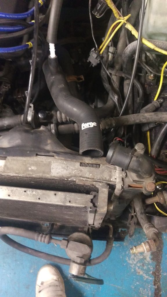

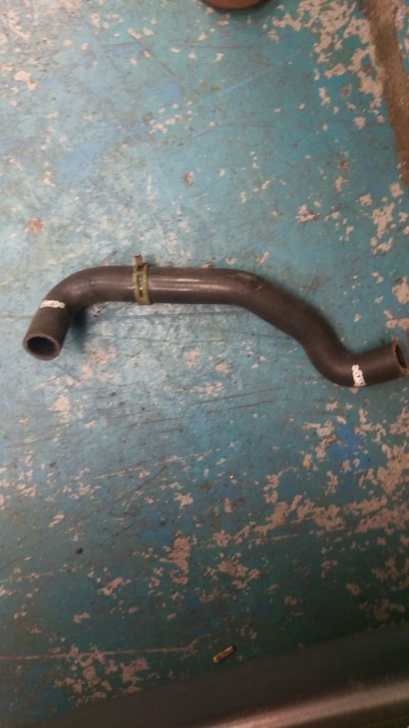

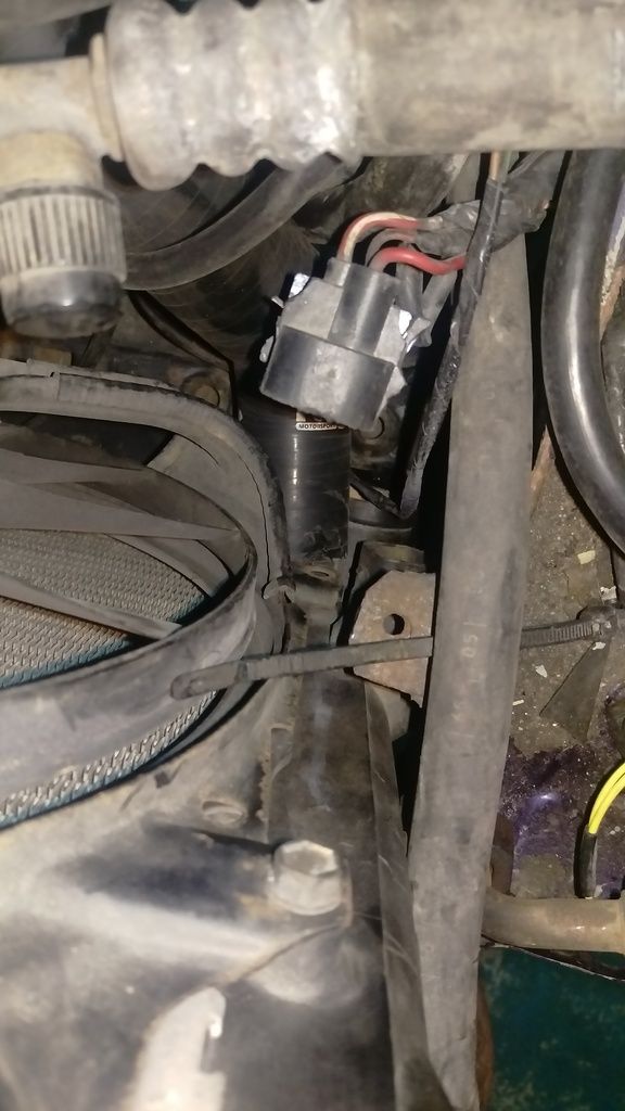

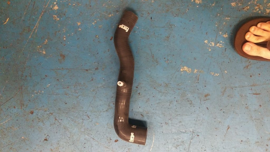

Grrrrallye 0 Posted June 16, 2015 Hi All. I have a set of Forge coolant hoses for the VR but I'm having real issues with getting the last 2 to fit. The 2 in question are the radiator hoses. The top hose is the one with the T in it for the small line going the the throttle body and the lower just goes to the 3 way block. The top hose appears to be the wrong shape and almost at 90deg to the rad top the lower hose is just too small. Has anyone else had issues or have photos that shows clearly what i should be aiming for? It is an AC car if that makes any odds? Thanks Quote Share this post Link to post Share on other sites

Grrrrallye 0 Posted June 18, 2015 Right here are the Pics Thats the top hose and this is from the other side And the lower hose Quote Share this post Link to post Share on other sites
g0ldf1ng3r 15 Posted June 18, 2015 im sure from looking at the pics I have roose motorsport hoses fitted on my VR, you could try looking at their page & comparing them to the forge ones you have linky.... http://roosemotorsport.co.uk/index.php?main_page=product_info&cPath=1_97_191&products_id=1493 edit: in case you are unaware roose motorsport had someone send them their VR VW hoses for them to make a match Quote Share this post Link to post Share on other sites
Grrrrallye 0 Posted June 18, 2015 some updated pics to show what i mean: and the top hose: Quote Share this post Link to post Share on other sites
g0ldf1ng3r 15 Posted June 19, 2015 yeah they definitely don't look right im not in the VR today so cant nip out & take you some pics of mine, howerver, if youlook on page 2 of my build thread you can clearly see the top rad hose & how it runs across to the expansion tank & then behind the the block http://the-corrado.net/showthread.php?44751-g0ldf1ng3r-s-VR-amp-return-of-the-valver-VR-wheel-swap/page2 Quote Share this post Link to post Share on other sites
cool_rado 10 Posted June 19, 2015 Those hoses are for a mk3 golf . . . . . Quote Share this post Link to post Share on other sites
Grrrrallye 0 Posted June 20, 2015 OK. Are the MK3 and the Corrado different then? This is very annoying as Forge had my std hoses to pattern!! Quote Share this post Link to post Share on other sites
cool_rado 10 Posted June 20, 2015 Yeah, the rad hoses are different on a golf, the outlet is straight into the hose whereas the rado uses the 90 degree bend. Quote Share this post Link to post Share on other sites
Grrrrallye 0 Posted June 20, 2015 I have just mailed this to Forge to see what they have to say on the matter. They had my stock hoses in order to pattern them so I guess I will see what they come back with. Very gutting though as I only need the rad on to finally fire up the bloody thing and it might just spur me on to finish it! Quote Share this post Link to post Share on other sites
britpop95 0 Posted June 20, 2015 Ye I agree unfortunately they are golf hoses, I've got samco hoses and they advised me on getting it right between golf and Corrado hoses. Hope you get it sorted mate. Quote Share this post Link to post Share on other sites
