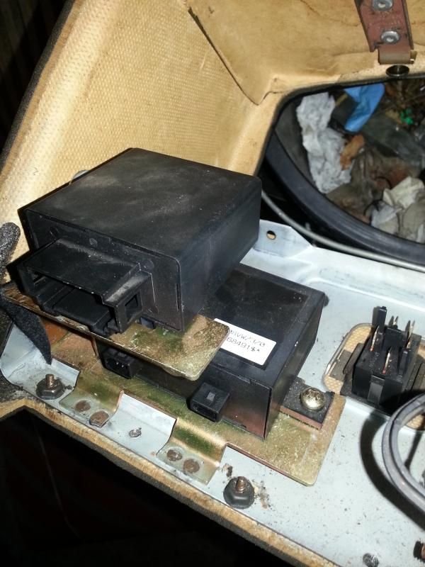

Jim Bowen 1 Posted November 17, 2015 I do remember the spoiler module and the immob being right next to each other in the dash, wonder if a wire has come loose or the earth isn't well. Quote Share this post Link to post Share on other sites
Chuggs1 10 Posted November 17, 2015 What parts of the dash will h need to remove to get to these and is it easy Quote Share this post Link to post Share on other sites
Dox 23 Posted November 17, 2015 The spoiler module is behind the dash, near its manual switch, by the drivers right knee Quote Share this post Link to post Share on other sites
Jim Bowen 1 Posted November 17, 2015 Think this is the two parts, you can see the switch poking through on the right. Quote Share this post Link to post Share on other sites
