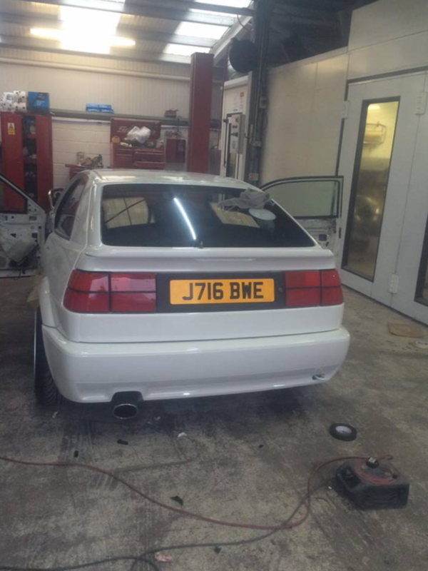

Okay, the car is nearly ready for collection...All the glass etc is now back in the car, just needs wiper arms, door handles and door cards to be fitted. Paintwork has been polished to a lovely shine! :)
All red rear lights are now fitted onto the car as well, much better than the crystal ones that were on it previously I think as they just seemed a bit "bling" for the direction I am going with this project.
Looking lovely - impressive work in just 3 days!
Almost 3 days lol, they had it 10am Monday but still for a weeks work I'm very impressed! :)
Just wondering that too! Hadn't noticed it the first time around.
Looks nice though and amazingly quick work!!
It was raised to be painted... you can get full coverage of it easily enough, and of all the tailgate underneath/behind it so no worries there.
Looked fine to me when I was re-fitting the rear number plate lights anyway ;)

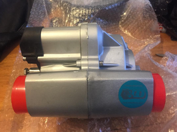

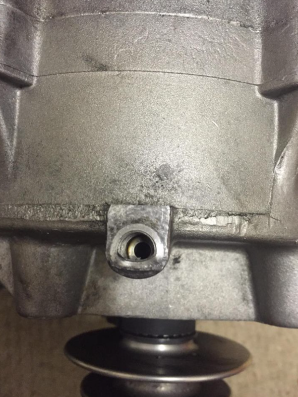

Well the new supercharger arrived today... So removed the old one again, went to fit the new one, and its damaged! :( The oil return thread has been damaged whilst being delivered I am guessing, so have messaged the seller on eBay but also have a good friend asking a few contacts who deal with engineering and race engines to try and repair the thread, still enough to ruin my good mood with the respray!

Well a quick update... had the oil return feed thread repaired and they did an excellent job! Really impressed with the repair, however after fitting the charger, priming the seals with oil etc - and then starting the car it was apparent all was not well with the charger, so whatever damage it sustained on the outer casing, the insides also must have gotten damaged as it made a horrendous noise so it's now been removed AGAIN and has been posted back to L&S Cartec in Germany who I will NEVER be dealing with again.
So after speaking to Only Charged Dubs they are sorting me out with a nice custom built spec charger to go on the car... but may take a little while as they are up to their eyeballs in work, but fingers crossed it's sooner rather than later as driving the car without the charger is mind numbingly boring lol.

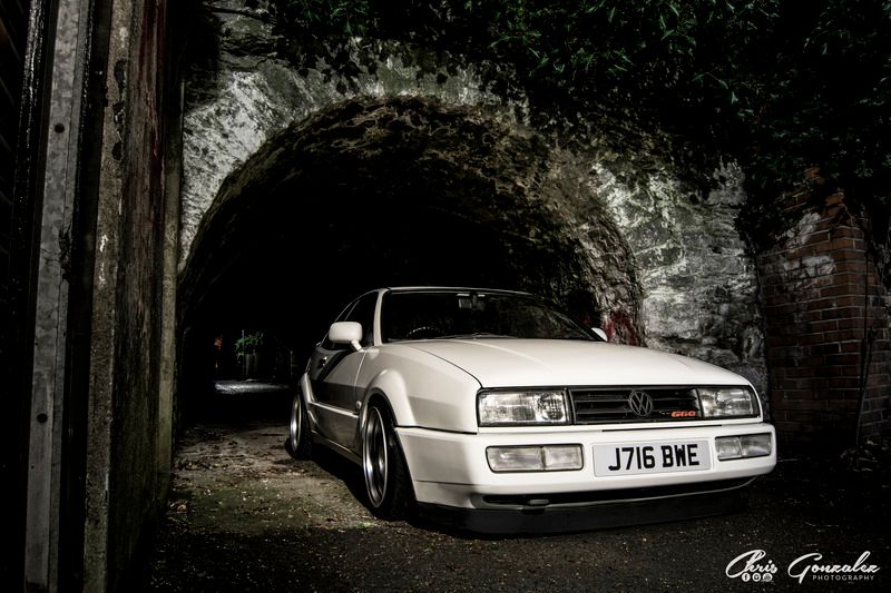

Well enough time had passed since the respray to give the car a good wash, seal and wax seeing as it was a dry(ish) day. Then went out and took some photos...

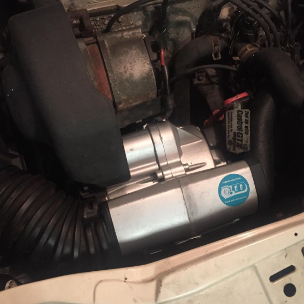

The newly rebuilt charger from Only Charged Dubs arrived yesterday so it was all hands to the pump to get it fitted before the weekend. Got the old one removed (again) and then fitted the new one, fitted the new oil feed and return pipes and carried out an engine flush and oil change with the correct grade of oil 10w40 Semi Synthetic. Primed the new charger as per the instructions, and then let the car idle and got the engine up to temperature to check for leaks etc. After a few adjustments, it was started again and after a few minutes I slowly increased the revs from idle upto 1000rpm, 1500rpm, 2000rpm and then 2200rpm when I heard what can only be described as a scary noise! Almost like a buzzing from the charger area. Checked the oil feed pipe, yep plenty of oil in there.
By this time, it was getting late and I'd had enough for one evening, so I packed everything away and thought I'd tackle it again in the morning with after some sleep...
Saturday morning and I started the car up and again let it idle up to temperature, another quick check in the daytime for leaks was also done. Increased the revs as I had done the previous day and the noise returned. I phoned OCD and spoke to Matt who said that you can sometimes get noises from the chargers after a rebuild, and to take the car for a drive and see how I got on, which I did. At first the noise remained, and I was ready to admit defeat when after a longer drive at a constant RPM, the noise got quieter! I carried on driving, and the more I was driving the better the noise got! Now I'm not sure if this is normal, or anyone has come across this before (would be good to hear if anyone has), but long story short I have covered 80 miles today with varying loads whilst keeping the RPM under 3000RPM as per the instructions for running in, and the noise has gone completely and I'm just left with the hollow G60 noise (hard to describe) that from what I can work out, is normal.
So fingers crossed all is good now, and I can start to enjoy Corrado ownership again! I'm guessing that the oil just needed to get to all the right places within the charger and driving it more obviously got the lubrication to where it needed to go, and perhaps it was a slightly dry seal thats now been lubricated? Who know's I'm not that clued up on G-Laders but as long as that noise stays away and the boost stays within the engine then I'm happy!

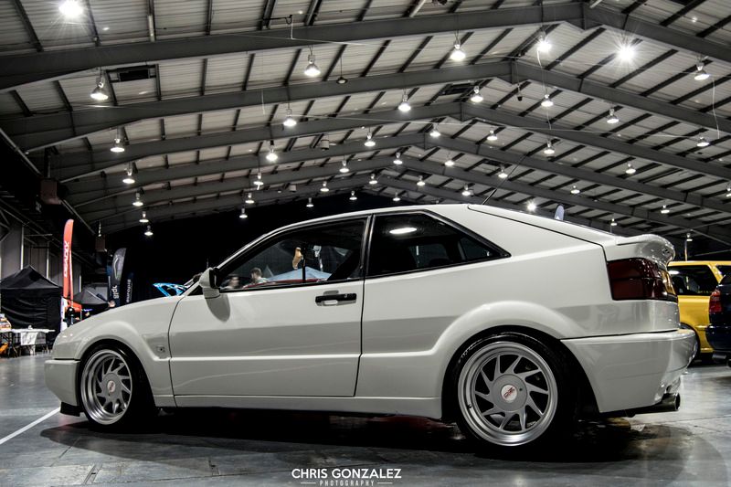

Managed to get hold of a genuine N.O.S deep front splitter for the car from a work colleague who had bought one for his old Corrado but sold the car before getting a chance to fit it, so it sat in his garage for years... Old one came off nicely, and the new one went on just as easily. Just in time for Ultimate Dubs too :)

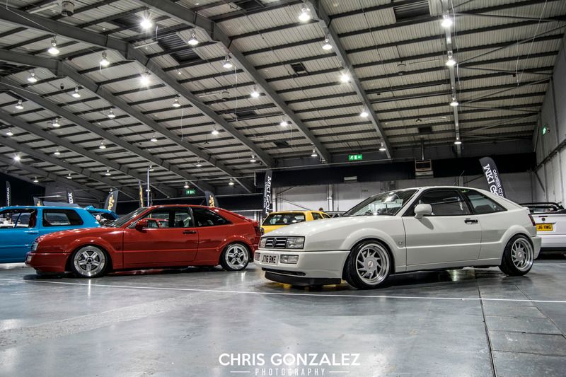

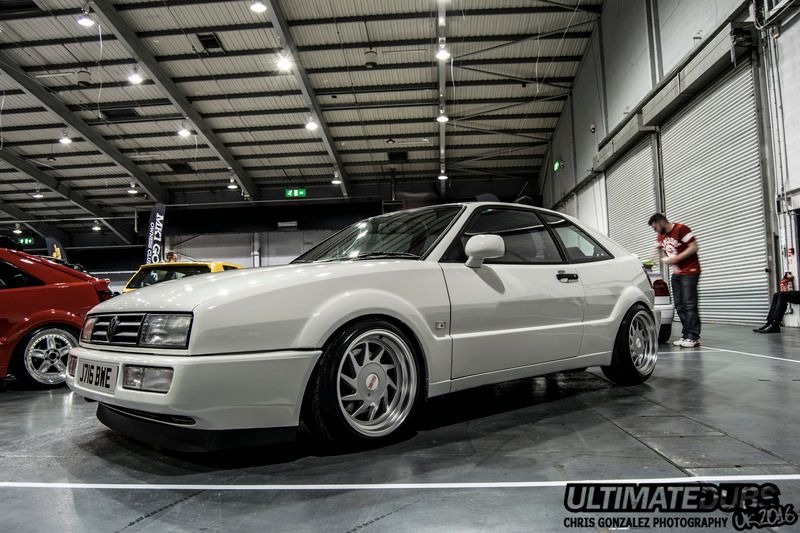

Well the charger is still running nicely, even after a spirited drive up to Ultimate Dubs at the weekend. First time showing with the Corrado inside, think it went down well but tbh I'm not fussed I built it for me lol.
Anyway, here's a few pictures of it indoors...
I had a lot of positive feedback from Ultimate Dubs which was nice, even if it didn't have mega expensive custom wheels or air-ride... for a build that had only taken a few months, I'm more than happy with how it was sitting at the show!

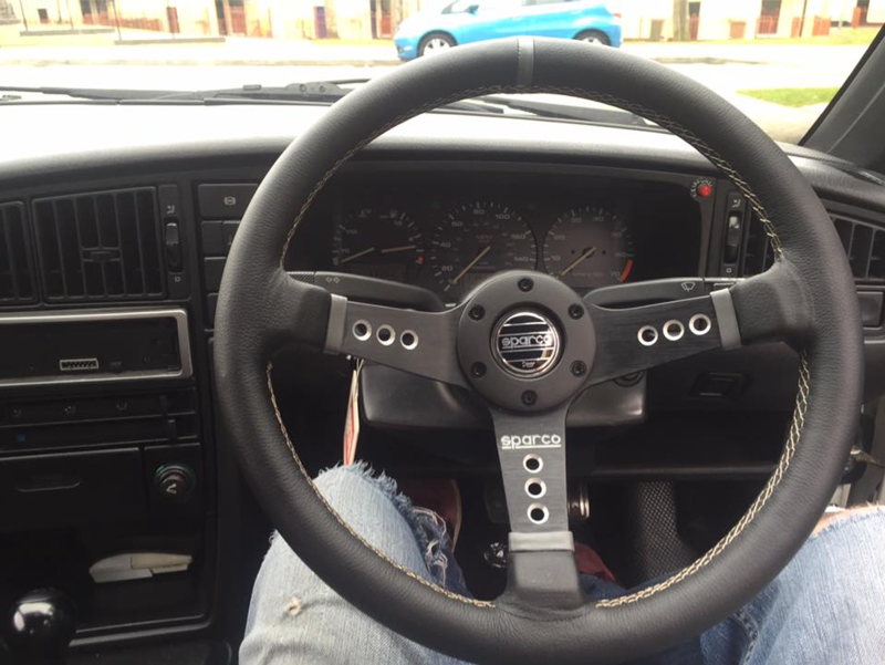

Seeing as the car behaved itself on the way up, and on the return leg of the trip back down to Devon I treated the G60 to a new steering wheel, something that I had been wanting to do but wasn't able to find a steering wheel that worked (most either looked too modern, had the wrong colours going on or I just didn't like them). So went for a newly released Sparco steering wheel, I like it anyway... :lol:
Mate, you're right not to be worried what others think. Car looks amazing! Nice to see something different in the steering wheel stakes as well.
Looking very nice
