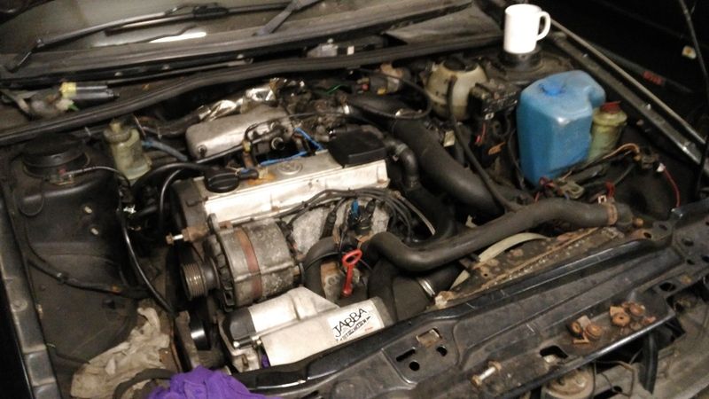

Couple of pics from the advert. Unfortunately the BBS wheels weren't included in the sale so it came on a dodgy set of aftermarket alloys that have now been moved on.
I was just starting it up to drive away from the sellers house and he said, 'Oh, by the way, sometimes it gets pretty warm and the light flashes, but it never overheats ...' Yeah, I should have handed the keys back and demanded my money back, but nevermind. Sure enough, if you put it under load for any amount of time the temps started to climb and was flashing at me shortly before I got home. I did test drive it, but only on the flat and obviously not for long enough. Decided I wanted to do some mods anyway so figured a new water pump and radiator would sort it out.

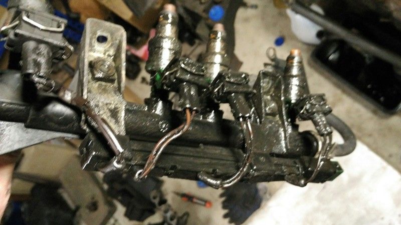

- New modified headlight loom (the one fitted is quite melted :o )

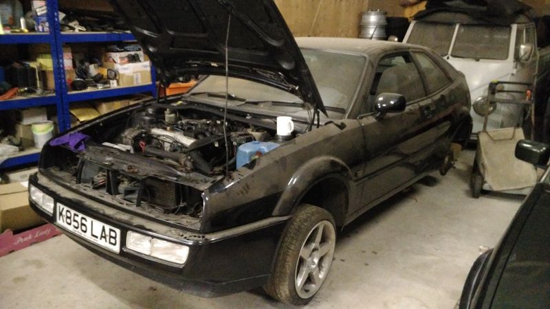

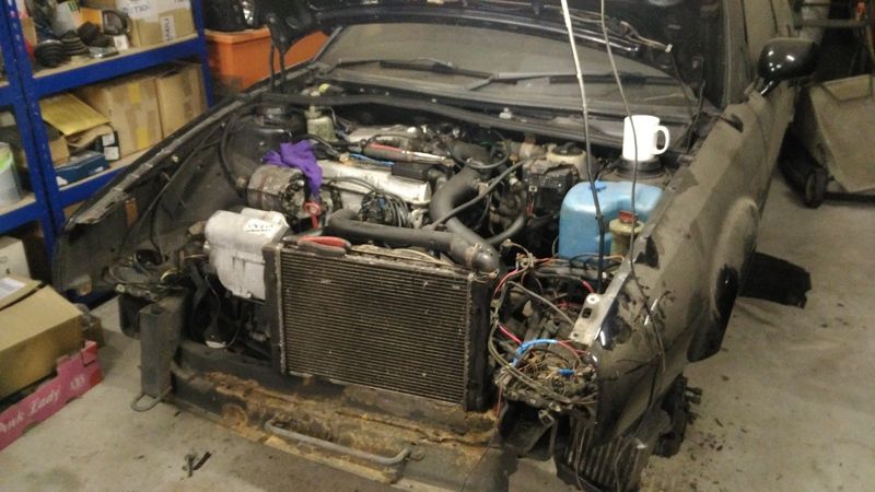

Front off
Far more complicated than a Mk2 Golf.. do you have to drain the power steering system to remove the rusty piece in front of the cross member?

Get rid of that awful interwarmer for a start, lower temp. thermostat and fan switch next, then check the probably crusty
ingector wiring harness.. fit a decent oil cooler in place of the original afterthought fitted by Vw, next it's time for a no-lag SNS eprom in the Digifart ecu.
Whilst your in there change the g60 cogged timing belt too.

Well done for getting stuck with in . Yes you do have to drain the power steering as the metal pipe runs through the rad support. Or you could clamp the end of the hose.

Already have the SNS chip :) so I'll stick that in there. It's currently running a Jabba 68mm pulley and chip, but it was disappointingly slow really compared to the G60 Jetta I built a couple of years ago. Hopefully the cam and bigger intercooler will help make it a bit quicker.
Other than the Miltek exhaust (cat back) and drilled discs it's totally standard, which is nice actually.

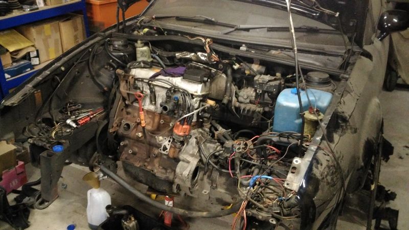

Got a lot of the front engine ancillaries off, decided I'm going to remove the PAS pipe on the front and clean it all up, stick a poly front mount on it etc. Also going to get the inlet off and fit another that I've got and clean all the oil off the back of the block.

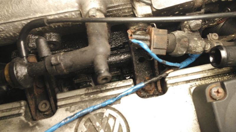

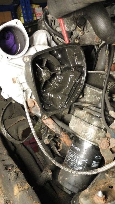

Nice oil leak;
An even nicer bodge...

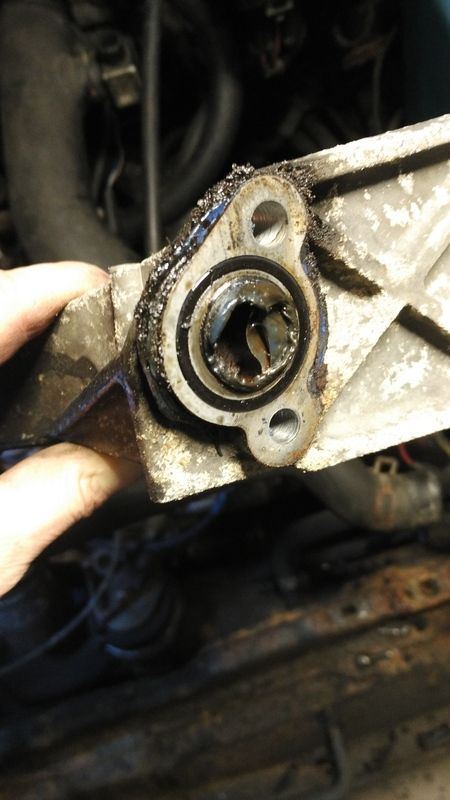

And here's the bad news, it looks like my reasonably recently rebuilt charger is not so healthy :( Going to split it tomorrow and see what it looks like inside. Not sure what's going on as the lumps you can see are actually grease..

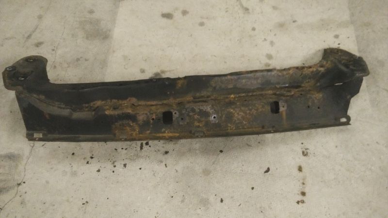

Rusty front panel, but luckily doesn't seem to be rusted through anywhere:

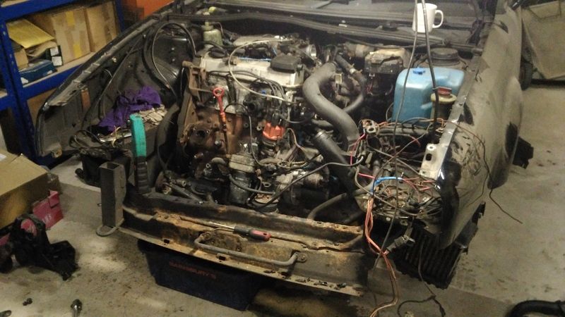

Inlet etc off, just the rocker cover to whip off and paint then I can start actually putting bits back on :)

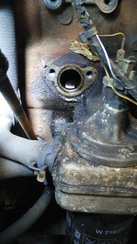

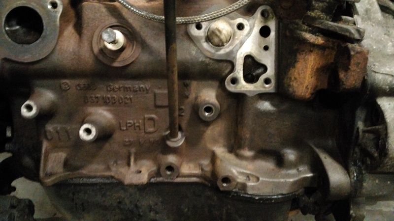

Quite a bad leak from the rocker gasket down the back of the engine..

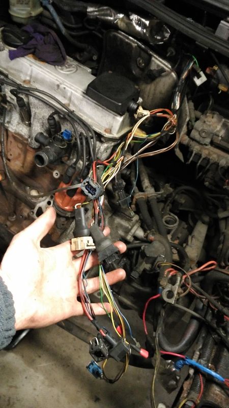

One job that was very satisfying was cleaning up the loom. I've only done it from the bulkhead, but the rest isn't too bad. Whipped off all the old tape (why do people put electrical tape on looms!?), then cleaned all the glue off, did a couple of repairs and taped it roughly into position, just need to do final wrap after connecting it all up when it's back together.
Ordered a new water/oil cooler, just hunting down the gaskets I need and will start cleaning bits up this evening. Haven't split the charger yet ... fearing the worst :(

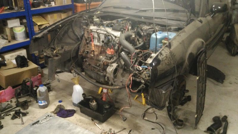

Finally got around to doing a bit more work on this ... it's definitely gone backwards :p
Decided to fit lightened flywheel, new clutch and CTN gearbox. While I was pulling the 'box out I noticed that the subframe is holed :( so that needs to be replaced too .. yay

I'm actually going to pull the engine out as it will just make replacing the subframe easier.
Decided repair was better than replace as the rest of it is in decent condition. Various threads said that the Mk3 subframe was different too, plus this way I don't need to buy a new rear engine mount :)
Obviously engine is out now, have also taken bushes out of the wishbones and stitch welded them. Whipped sump off the engine and removed the oil pump and bigend bearings - new ones on order - then can bolt back together with my windage tray and Shrick sump.
