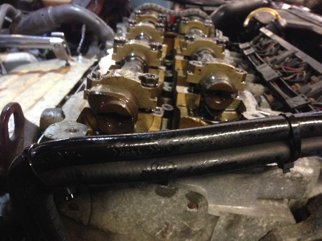

maff 10 Posted November 18, 2016 Update, we've just checked the camshafts and they do not line up.. so can we take off the top chain cover release the tension bolt for the guide, undo the camshaft sprockets to line up the camshafts to fit the tool with the bottom pulley at bottom lined up? Or do we have to align the intermediate sprocket as well? Hoping some experts can help with this:-) my mate has his own garage and has built and timed his own vr6 mk1 but he's unsure whether we can re time the engine with out having to remove the gearbox? Quote Share this post Link to post Share on other sites

maff 10 Posted November 19, 2016 All fixed! Removed everything to expose cams and top chains, then checked the intermediate shaft (which luckily lined up) while the bottoms crank pulley was on tdc. Then slackened off cam bolts to lift cams and turn them with the chain still attached untill we could slot the tool in. Retorque camshaft to correct spec refit guide tensioner bolt and reassemble. Fired it up and sounded spot on, then took it for a test run, (waiting for the oil to get to temp) and then try WOT, which concluded there was no tailing off of power above 5000rpm:-) engine came on strong at 4500 and pulled hard to 6000rpm as I remembered how they should do. Thanks for the help, so glad we got it sorted Quick pic of the car Quote Share this post Link to post Share on other sites

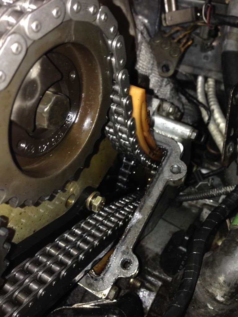

maff 10 Posted November 19, 2016 (edited) This is the best pic I have as couldn't get it with the poxy phone flash, but it was the same as the vr6oc guide pic Same as this I was expecting the intermediate shaft to be out but luckily it wasn't, so all we had to do was get the cams cock on with the locking tools, pulls hard now so all good, that's a weight off! Edited November 19, 2016 by maff Quote Share this post Link to post Share on other sites
Dox 31 Posted November 19, 2016 Oh, I thought you had a spare engine with the covers off? Good result anyway :) Quote Share this post Link to post Share on other sites
maff 10 Posted November 19, 2016 Yes we have! I can get some pics if you want a look? Quote Share this post Link to post Share on other sites
