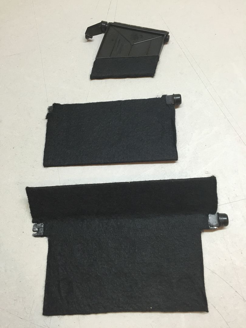

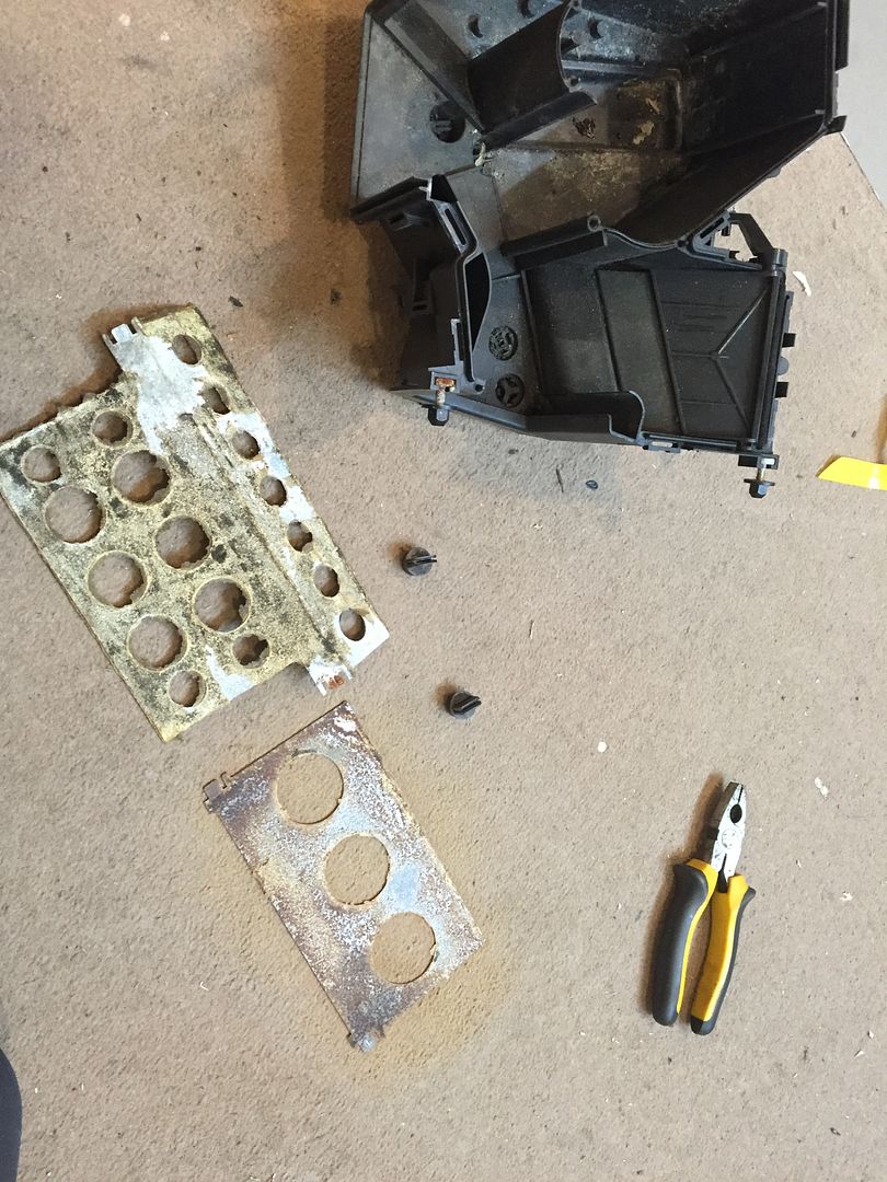

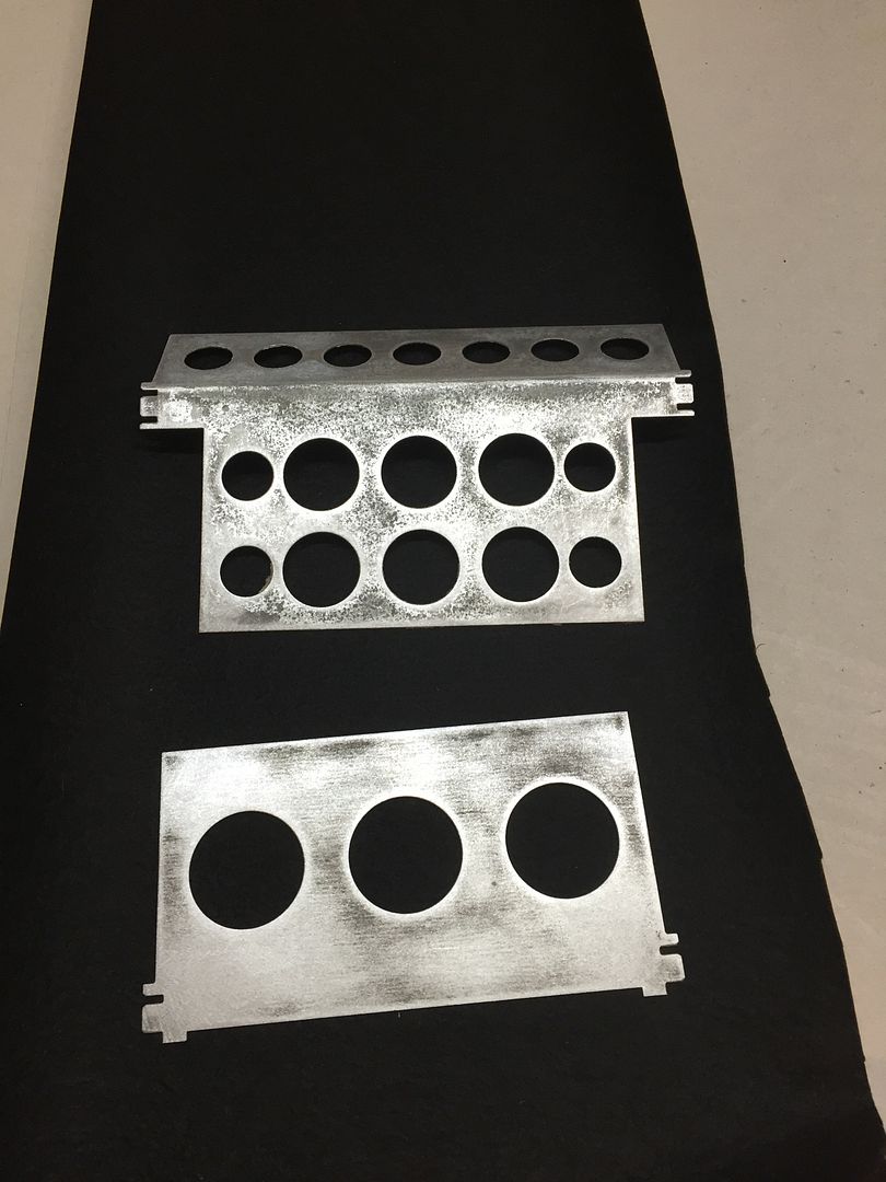

Chances are the doors/flaps have lost their foam and are fairly useless, given the fact that they are full of holes. I refurbished a box going on what someone else on here did. Not had a chance to try it out yet but I'm hoping for an improvement
