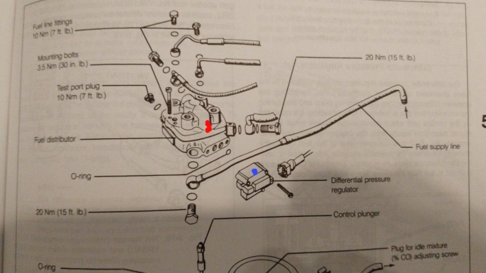

FUEL
KR & 9A
The 4 Banjo bolts for the injector pipes in the fuel distributor are:
10 Nm (7 ft.Ib)
Small Banjo bolt for fuel pipe to cold start valve
10Nm (7 ft.Ib)
Large Banjo bolts around metering head are 20 Nm (15 ft.Ib)
Small Banjo bolts around metering head are 10 Nm (7 ft.Ib)
KR engine
The same torque settings for large & small Banjo bolts on the fuel pressure regulator that's bolted to front of engine block on (KR) 1.8 16v
Large Banjo 20 Nm (15 ft.Ib)
Small Banjo 10 Nm (7 ft.Ib)
9A Engine
Also the same torque settings for both fuel pipes on the fuel pressure regulator on (9A) 2.0 16v this one is bolted to side of metering head.
Large pipe 20 Nm (15 ft.Ib)
Small pipe 10 Nm (7 ft.Ib)
But this doesn't have Banjo bolts.

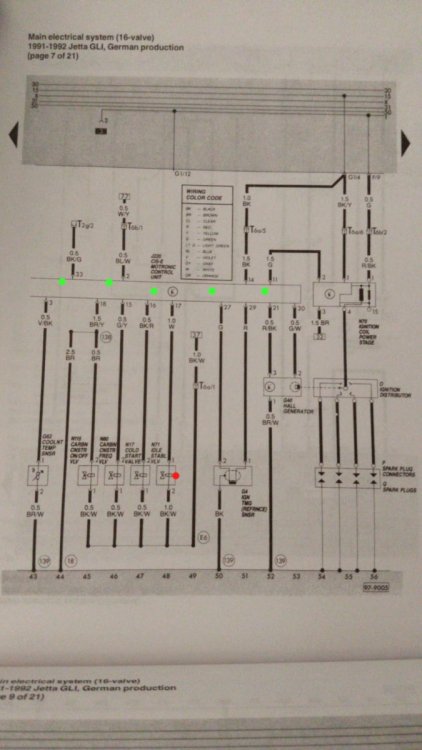

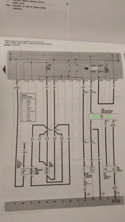

Main ECU has 35 terminals for the 2.0 16v E-Motronic Bosch system (9A eng)
Terminal 1 =
0.5mm grey/white wire (goes to 6 point push on connector ground behind fuse box)
Then goes to 3 point push on connector behind centre console. Then goes to double white diagnostic connector plug under gear stick boot,
possibly up to 1992
After 1993 it'll be the OBD2 black connector.
Terminal 2 =
0.5mm blk/white wire (earth to behind fuse box) says six point push on connection.
Linked to battery to body earth.
Terminal 3 =
0.5mm violet/blk wire (goes to terminal 1 of coolant temp switch) in back of cylinder head.
Terminal 4 =
0.5mm white/red wire (goes to terminal 1 of differential pressure regulator/governor)
Terminal 5 =
0.5 brown/Black wire (goes to terminal 2 of differential pressure regulator/governor)

Diagrams from the Bentley Manual for the 2.0 16v (9A) electrical circuit for the ECU, I have already listed most of them in a previous post, but thought these wiring diagrams may help also.
Green dots show ECU pins.
Si
