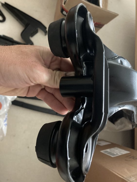

Im going to put this out there for future reference as I combined two techniques and with it, I made happen the last 3 bushings in less than 10 minutes compared to the 20/30 minutes for the first one.
As Keyo suggested, securing the engine carrier in a vise is a must. Frozen bushings were not a good idea as you want them more malleable so they are easier to work with at room temperature. What I struggled with, is that the more grease the better but then you just fight with the bushing going left when or press right and vice versa. Ended up using two flat head and a slippage while doing so could have hurt... Anyways it worked that way but it was still a struggle.
Here's my plan B that worked like a charm. Seriously, less than 10 minutes all 3 were in. I had a left over threaded rod from the rear beam bushing, about 30cm long. A 30 and a 60mm socket. The problem with my original jig was that I was trying to press in the bushing. This time, I inverted it so I was pulling the bushing in. I pulled it in until one part of the lip went through. If you put too much pressure it won't have enough space to wiggle itself in so there's a balance to respect. Anyways, that kept a constant pressure on the bushing. Then I turned the bushing until the bulging part was on top just to be in a better position to push. With the pressure on, there was no more slippage or struggle while pushing the bulging part in with my fat flat head (with masking tape on it as mentioned). Hopefully the picture shows what  I'm trying to explain. I snapped it just before pushing on the bulging top part.
