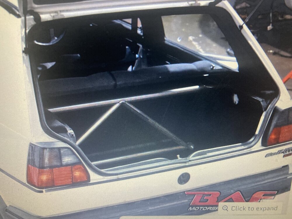

Keyo 47 Posted April 2, 2022 (edited) 9 minutes ago, ABV-VR6 said: Wow that sounds very very promising! I will sure give them a try and see what they say. Do you have one Keyo? I dont mate - my mk2 had a rear K brace once as there are 2 holes the same I found on the rear turrets so four in total that need welding on the inner metal skin- external arch is good - ex owners the buggers. lol. Hopefully a member has tried out the trimsport rear strut for a review ? would of looked like this . Edited April 2, 2022 by Keyo Quote Share this post Link to post Share on other sites

ABV-VR6 12 Posted April 2, 2022 1 hour ago, Keyo said: I dont mate - my mk2 had a rear K brace once as there are 2 holes the same I found on the rear turrets so four in total that need welding on the inner metal skin- external arch is good - ex owners the buggers. lol. Hopefully a member has tried out the trimsport rear strut for a review ? would of looked like this . Ya, I feel you that's why I'm very interested by the Trimsport. The K shape is really nice. My fav so far! I wonder if they still make it I'll contact them! Cheers Quote Share this post Link to post Share on other sites
ABV-VR6 12 Posted April 2, 2022 52 minutes ago, Keyo said: Found one think this is it . https://www.ebay.co.uk/itm/304185382010?var=0&mkevt=1&mkcid=1&mkrid=710-53481-19255-0&campid=5338268676&toolid=10044&customid=Cj0KCQjw6J-SBhCrARIsAH0yMZglM03egfcpqUDtTxpx0LOzPfDfRnwSl-DhmbFKm6S1MlnXfWFuHBMaAp8QEALw_wcB This one is only the top portion though, I would like the whole kit like in the picture with the MK2! Quote Share this post Link to post Share on other sites

Keyo 47 Posted April 2, 2022 (edited) 39 minutes ago, ABV-VR6 said: That's my story, always too late for group buys! It looks fantastic! So you had one? On which car? If you have the K brace you will have to drill though mate . The trimport looks bolt on bolt off . Here it is anyway. https://www.bafmotorsport.co.uk/products/volkswagen-golf-mk2-k-brace?variant=38007283056793¤cy=GBP&utm_medium=product_sync&utm_source=google&utm_content=sag_organic&utm_campaign=sag_organic&utm_campaign=gs-2022-01-27&utm_source=google&utm_medium=smart_campaign&gclid=Cj0KCQjw6J-SBhCrARIsAH0yMZjAbYUnFPLhMC0SmwT_08eJK1ib2D-MiDne2-yM2Ps38PuBa2dXty8aAuriEALw_wcB This video is how they mount fittings etc. Edited April 2, 2022 by Keyo 1 Quote Share this post Link to post Share on other sites
