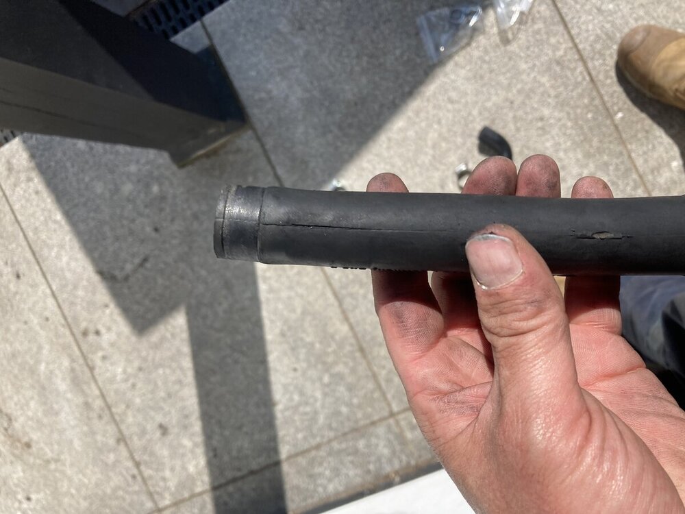

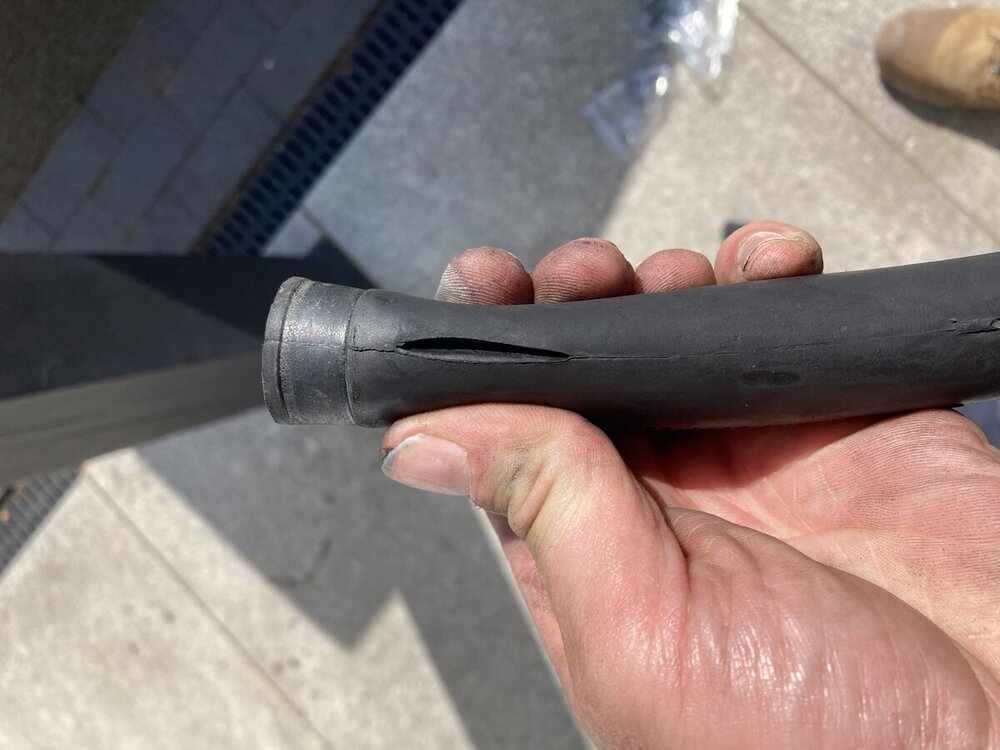

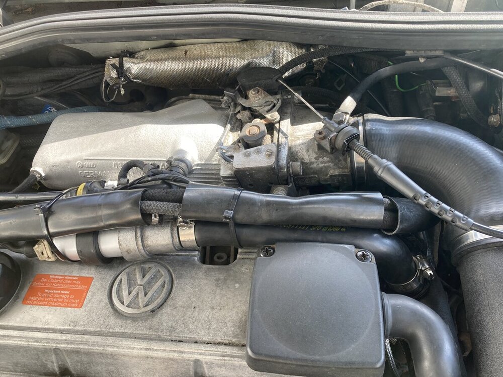

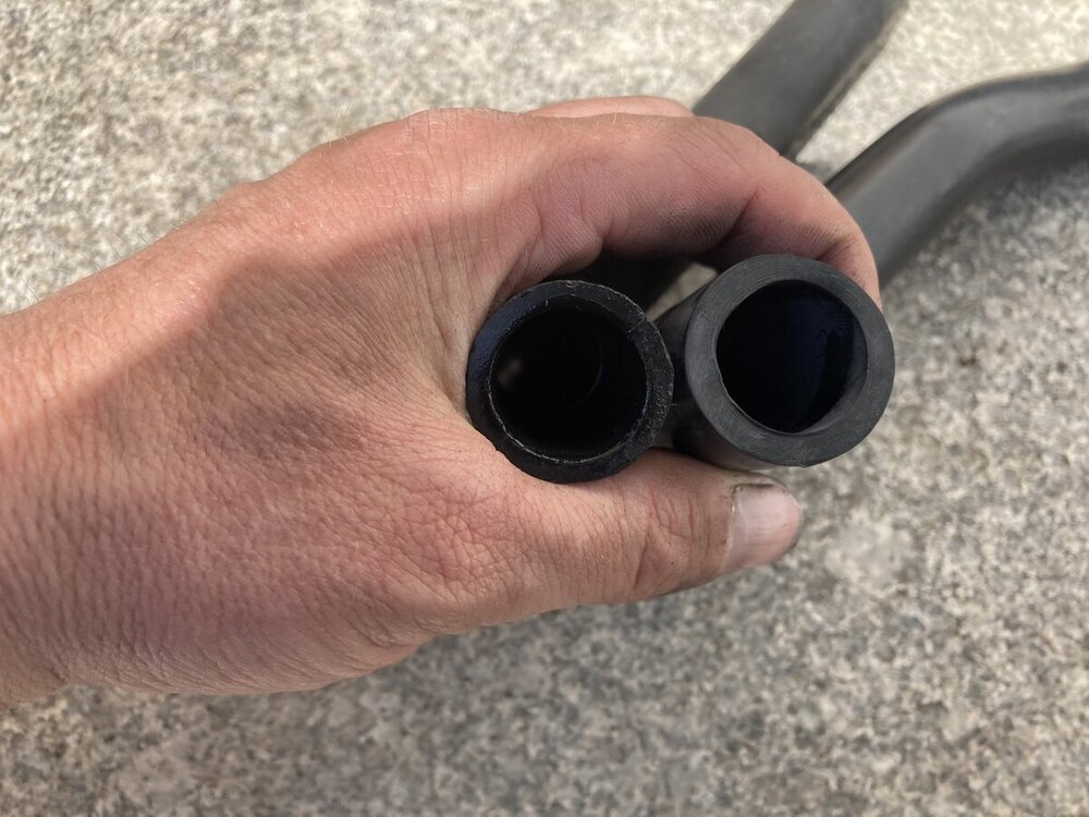

Im going through all my hoses as I'm running 2000 boost on MFA and want to get her upto 2200 - charger is ported . I began inspecting all hoses and have ordered some new vag boost hoses at a horrid price from Classics/ heritage.

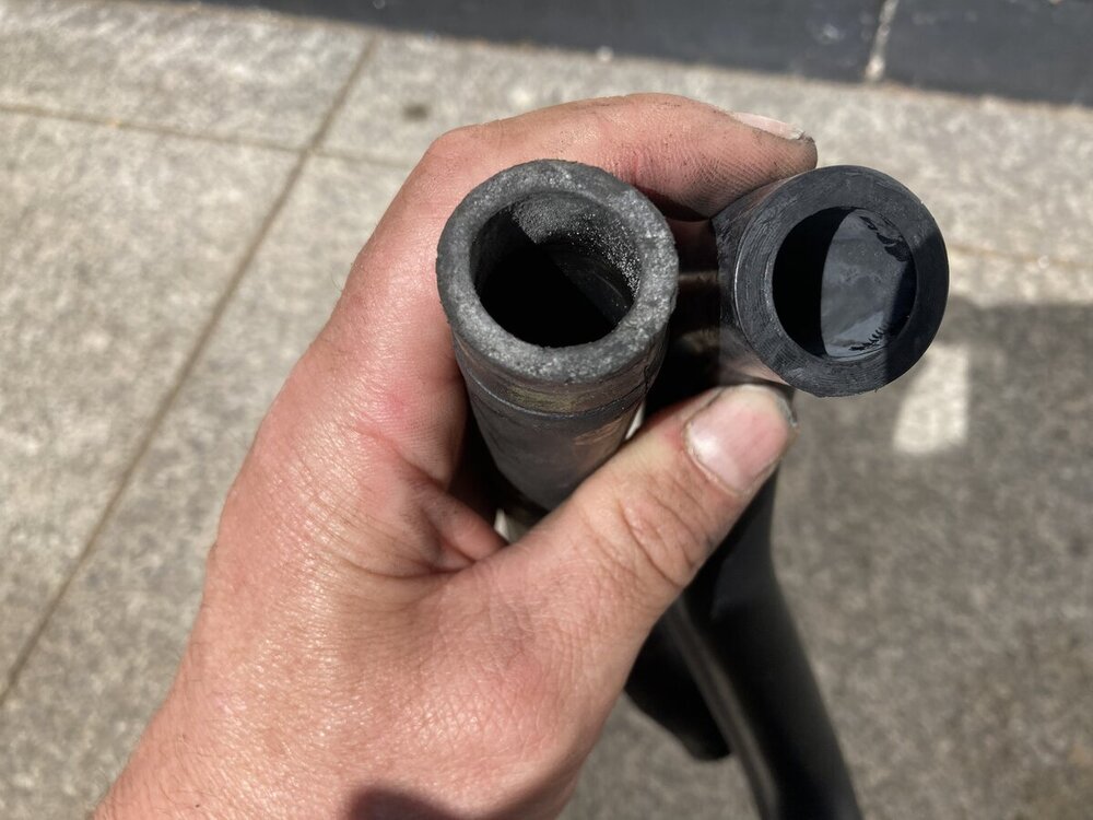

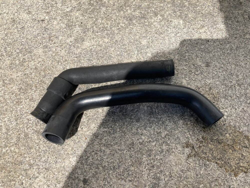

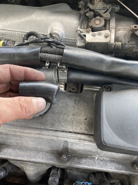

I got to the isv hose and noticed some damage- sometimes you real need to fold bend a hose to find it. The isv hose 037133394f has been obsolete for years - only other option I could see was a gash silicon one from USA with sign writing on it- would of been best part of £80 by the time it got here with postage and tax etc. So I began googling VW isv hose - breather hose on ebay and saw this and for a tenner gave it a punt.  030103493BB Mk3- polo breather hose.  Delighted only a tenner and ready available ebay- just a small chop to the end and perfect . Always nice when you can achieve a oe look for cheap and the original part is obsolete.  I might try more of this now on other obsolete parts. Over the moon to solve a problem for cheap lol.

Im chuffed chap- I was expecting it be 5 cm long when it arrived - I just got a JP one as experiment  but quality seems fine,  Gates make one for £13 if you really want to push the boat out ha.
OE still available to pretty cheap.
https://www.lllparts.co.uk/en/product/seat-030103493bb-vent-hose/mpn/030103493bb
Edited by Keyo
Nice find chap. I'm sure with hoses, there are a few throughout the VAG market that would be suitable for different purposes - it's just ensuring the inner diameter is the same. There are some odd ones though! I've a few VR6 old spares coming up for sale in the next couple of days if you need any. 👍
