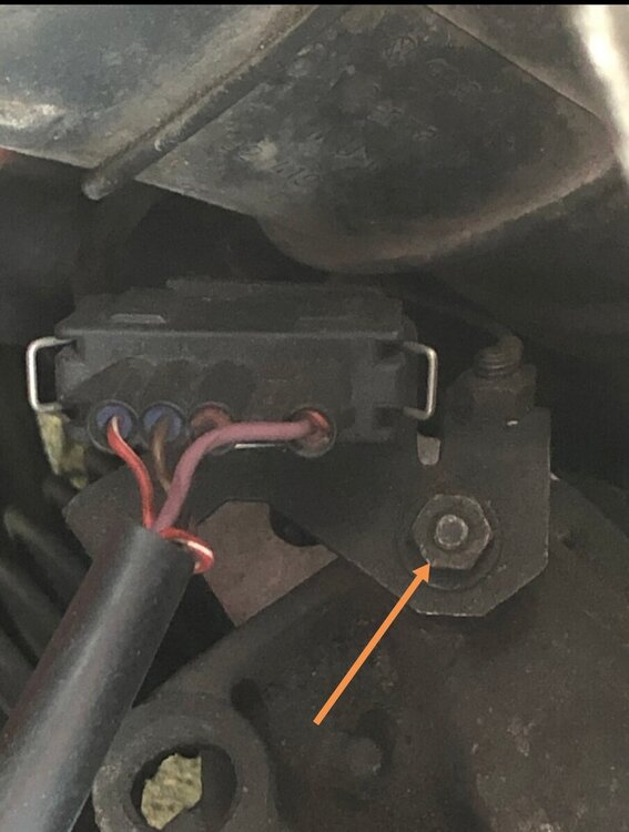

Trying to find a part number and can't find it anywhere, any help appreciated - and kudos to whoever finds it 👍
Missing part is a bolt on the rear engine mount on a G60; there is similar on a VR6 but a different size; not sure if an 8v or 16v has the same
One of the bolts is a double head with m8x45 on the bottom and m6 on the top (I think), it holds the connector lambda bracket -  see attached, 7Zap onl shows the standard bolt without the top stud from what I can find

Z Zap gets it wrong because ETKA also does not show it. It is an M8x45/M6x12 part number N 910 209 02 £17.40 inc VAT, no UK stock.

Open up the hole in the bracket to M8 and use a standard bolt if there's enough clearance to do so?
