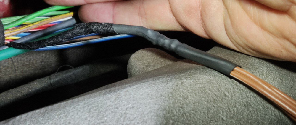

Update:
There are a few shorts and I am working on it to fix them all. One of them was green from the ignition coil. The black wire is also very tight/rigid/hard. And I'm going to put in new FLRY wire (not full wire, but that's the worst part).
But, in addition to this, I ran into something that I don't know if it's like that from the factory or it was also another crappy connection because of the Gemini alarm or sound system installed later.
I'm talking about 4 brown-white wires that ends to 94 ground.
Those wires are from: CO2 potentiometer, Hall Generator, Coolant Temperatur Sensor and Throttle Valve Potentiometer.
Here is how is this ground is in my car:

Well, this ugly factory connector needs to be remade. Today, checking connectivity between ECU Pin6 and connectors of Co2, Throttle and Hall, the connectivity is not good enough. Even in Co2 is inexistent.
I made a cut on the cover in the middle of the wire, close to ECU, and connectivity from here to Pin 6 was good. So I will remade the ugly connector and will see.
Keep working on wiring and connectors:
image.thumb.png.b150f1805ddb623b0815ec5f7411a359.png image.png.1fe892e0abe70690b4bed7598fa20727.png image.thumb.png.a00da4ca68ec7d4009a48320c81ed2ee.png
Supplier where I'm buying stuff to fix and repair wires don't have too much of bicolor wires and only in 1mm section. So I'm using pairs of color that are similar and equal or less than 1mm. Those bigger than 1mm usually are in one color (I think) and supplier in this case got a lot of colors. This is why you will see colors that don't fit with what colors are in the diagrams.
This week I will finish with the wires I listed to be fixed (there's a lot more to be fixed) and will see what happen.
Edited by KarlosG60
