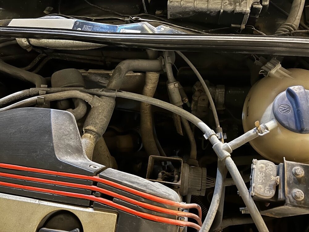

Finished doing the heater matrix and refitting everything.
Cant remember whether the cables go above or below the hoses to the matrix in the engine bay.  Does anyone have a picture of these in the heat resistant wrap and how it is routed?
Thanks
Hasan
Excuse the dust/mess, it’s sat a long time so very likely everything is in the correct place 👍
Perfect, many thanks. So everything goes above the matrix feed and return,and inside the heat wrap.
Just checked mine and it is laid out the same - and as dirty, but the routing is correct, all above the pipes.
