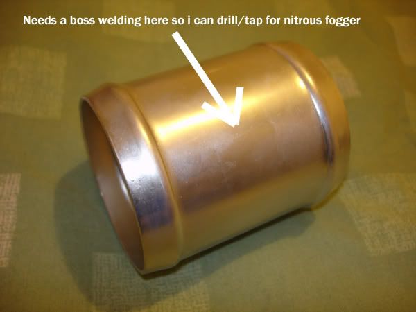

Need to sort a boss for the new ally pipe which will house the nitrous fogger.

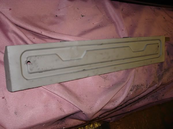

Paint mk1 golf number plate holder.

New alloy pipe which needs a boss welding on, so i can drill/tap for the nitrous nozzle.

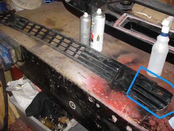

Front bumper removed again!

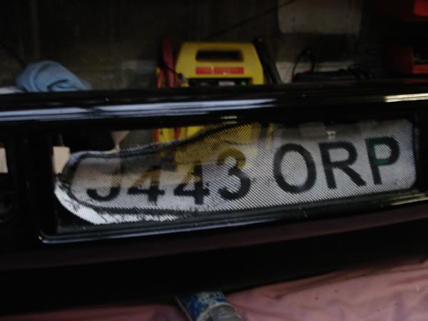

Bye bye to the perfectly legal number plate :lol: If i ever do anything as silly again, i want a b0llocking off someone!
New black mesh to go in its place.

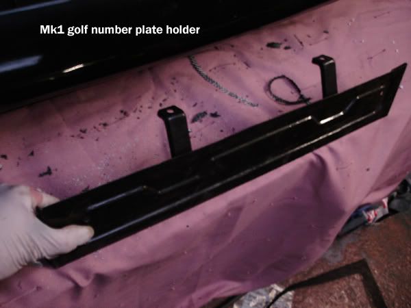

Mk1 golf number plate holder requiring slight 'tweaking'
Holes drilled in bumper vents, for bolting up the mk1 golf plate holder.
Test fitted, ive gone for a swept back mounting.
Then sand blasted it in the chaps unit next door ready for painting.

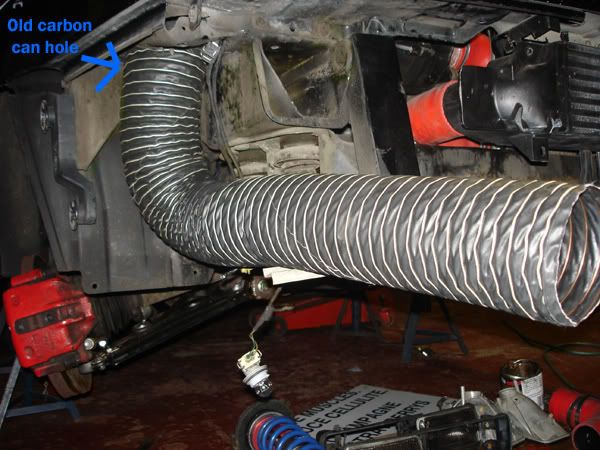

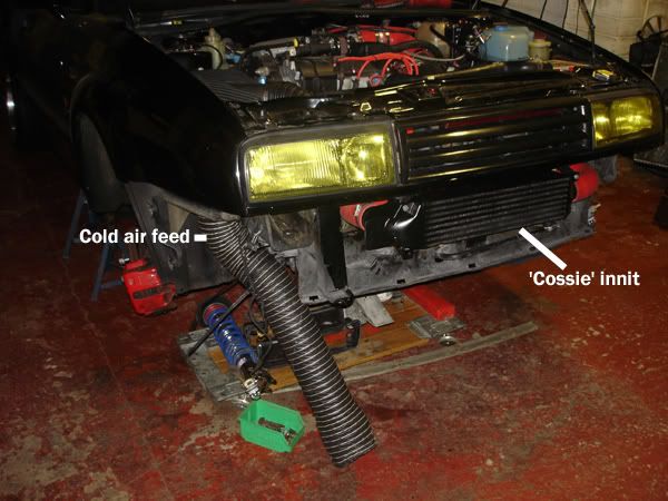

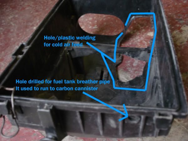

Just back from the unit having done this, bit of a rush job tbh.

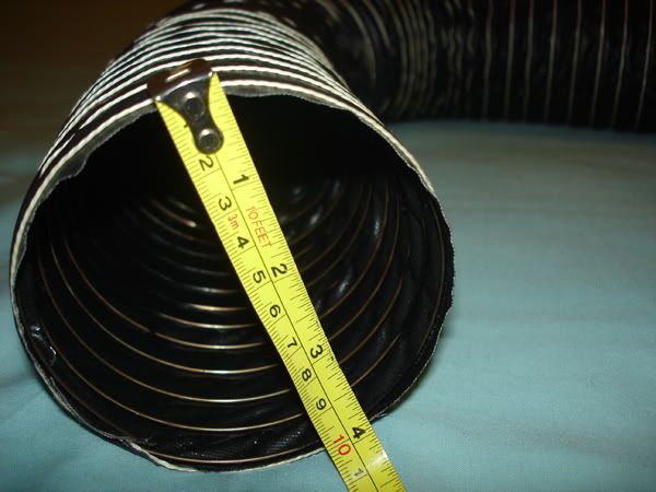

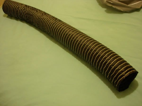

4" neoprene/copper wound pipe.

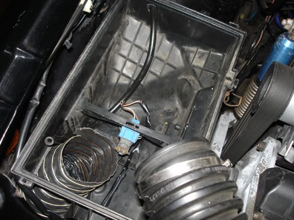

Created a hole in a spare air box, with a bit of platic welding (melting)
And drilled a hole/inserted a grommet to sit the fuel tank breather pipe in there too.

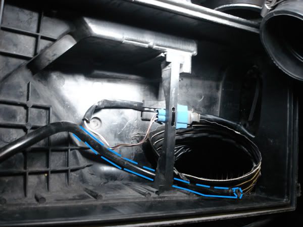

I drilled the brace for the air filter element, and tie wrapped the original outside/mfa temp sensor onto it. So the mfa will now show the temperature in the air box.
Where the cold air feed/neoprene pipe comes through the carbon cannister hole from the air box (carbon can was removed long ago)
Where the outside temp sensor used to sit, in the grill in the front bumper.
This is where the cold air feed/neoprene pipe will feed cold air from.
When i manage to cut it out.

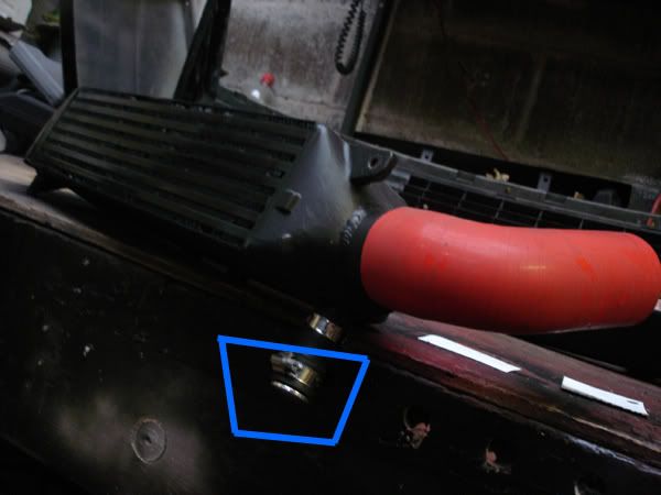

Sorted a propper plug for the cossie intercooler, i didn't want it welded up as it may come in handy some time.

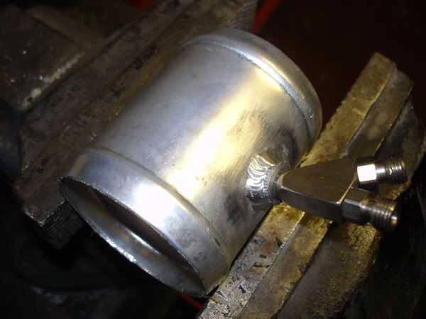

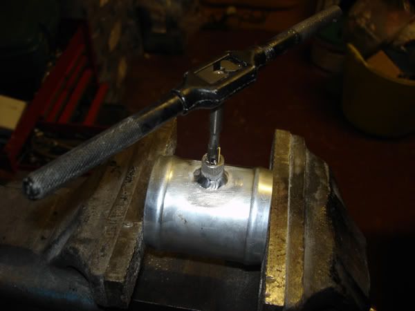

The pipe now with the boss welded on.
Tapped it, m8x1.0mm and filed down the boss.
Fitted/loctited the nitrous fogger.

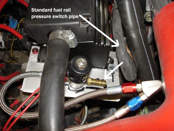

Fitted the brackets i made to hold the nitrous/fuel solenoids, then fitted the actual solenoids and piped the intake side of things back up. Still need to wire up the solenoids/full throttle activation switch and trigger switch, im gonna wire it all up then use the old OE loom tape again.

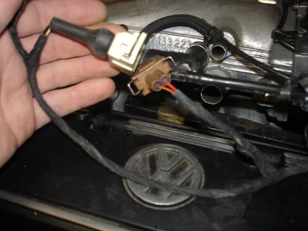

Also need to take a fuel feed from the original after run pressure switch on the fuel rail, the fuel solenoid sits perfectly inline for it as per old pic below.
I could simply take the pipe off the switch/fuel rail and stick it on the solenoid, or put a T piece in there.

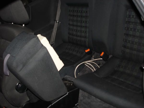

Also ran the nitrous line through the bulk head into the car ready to route it to a bottle when i sort one.

Ran the nitrous line through into the rear, its sat in the middle of the rear bench under the arm rest for now.

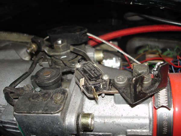

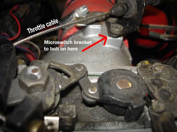

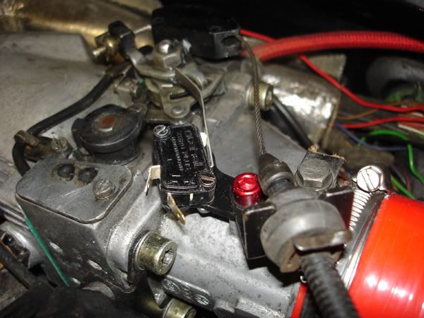

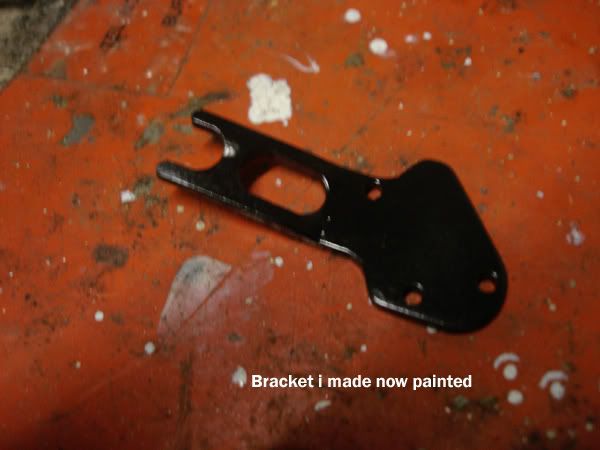

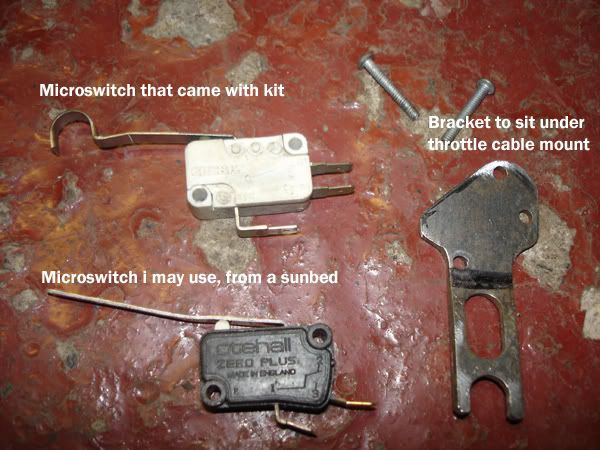

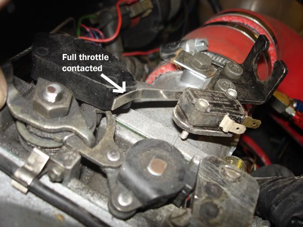

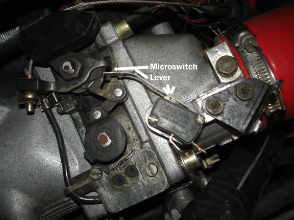

Made up a bracket and started on the throttle body activation/microswitch.
I got the white one with the kit, but gonna see about using the black one (from a sunbed) as it just looks better.

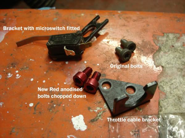

The standard looking throttle cable mount, where ive decided to bolt the microswitch bracket.
Mounted. The nitrous will kick in at full throttle only...and only when turned on via a switch in the car (need to sort that yet)
And here it is at full throttle.Need to tidy it up/adjust it/chop the screws etc yet.

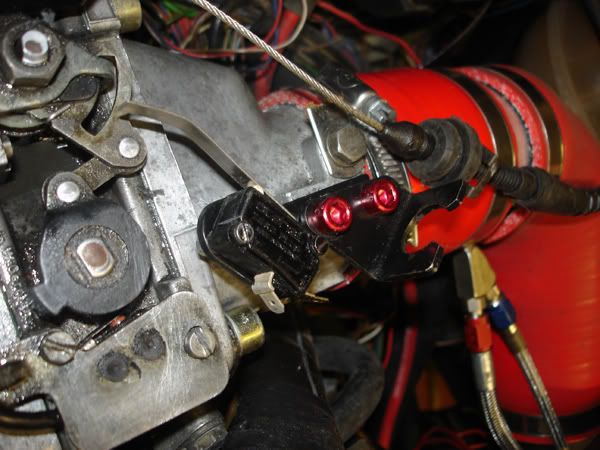

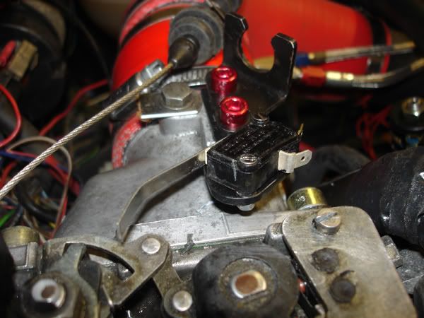

So here is the bracket i made up. Notice the crappy looking original bolts holding the throttle cable guide.
Painted the bracket.
Cut down two Red anodised allen bolts and mounted the microswitch onto the bracket.
And voila!

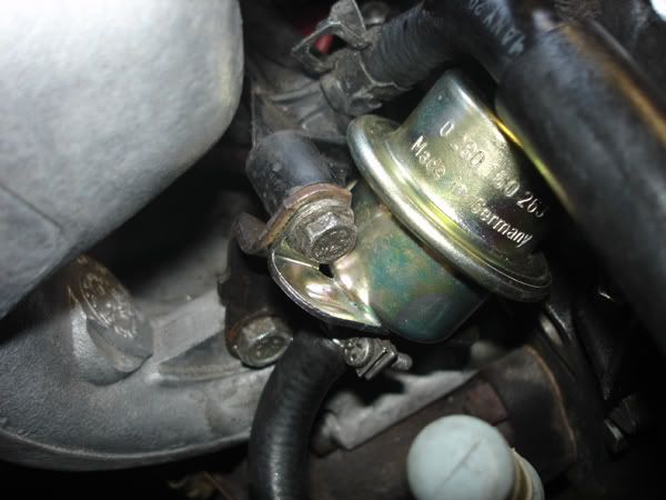

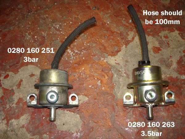

Brand new 3.5bar fuel pressure regulator.
New vac line, should be 100mm long.

Do you not find 100mm's a little too short for the vac pipe?
Mine has to be 105mm, otherwise it's too tight. :shrug:
Yeah i've found it too short in the past too mate :scratch: But i raise it up on the fpr now as there is plenty of room while still being a good fit. Keeps the 100mm pipe then, im funny like that :wave: Dosn't really show it in the pic.

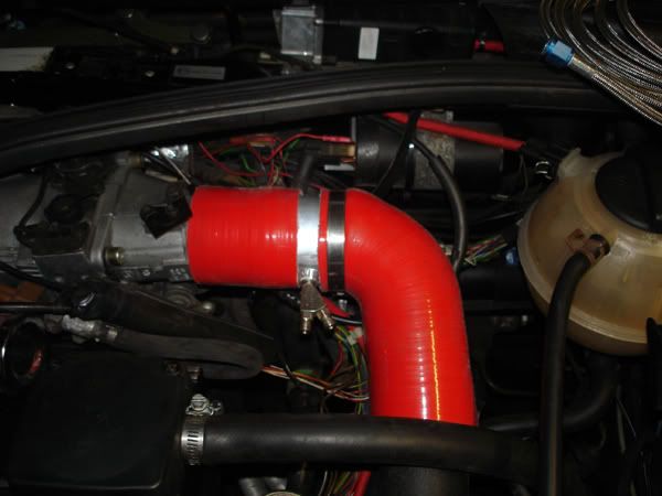

Got some new hose clips for the intercooler hoses. All are new now and don't cut into the pipework.
While fitting the red tops and 3.5bar fpr i covered the loom that runs across to the isv/over run switch and fuel pressure switch in oem loom tape.
It fired up no problem, and i just had to get a vid of the noise inside the cold air feed i made, sounds mental [LOL]
